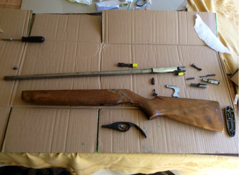

Hey guys, I'm back, I've been working on an old 22 single shot, (for some god forsaken reason I can get a real gun easier than airgun parts) and I'm looking to blue the receiver and barrel, and I think I'm just going to leave the trigger alone. I have the whole thing disassembled and sanded up and such, and I think it is ready, other than de greasing.
I just figured I'd ask because it is a useful topic on here. (If this is in the wrong spot please move it)
