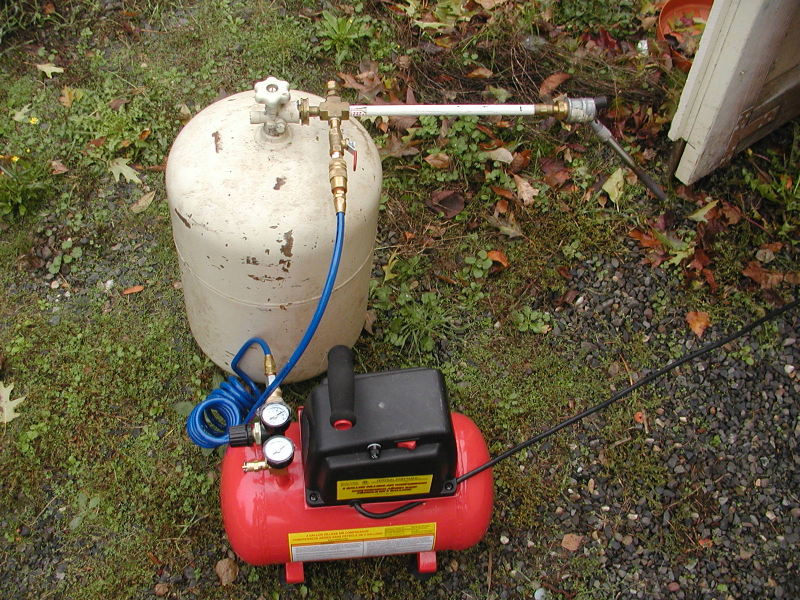

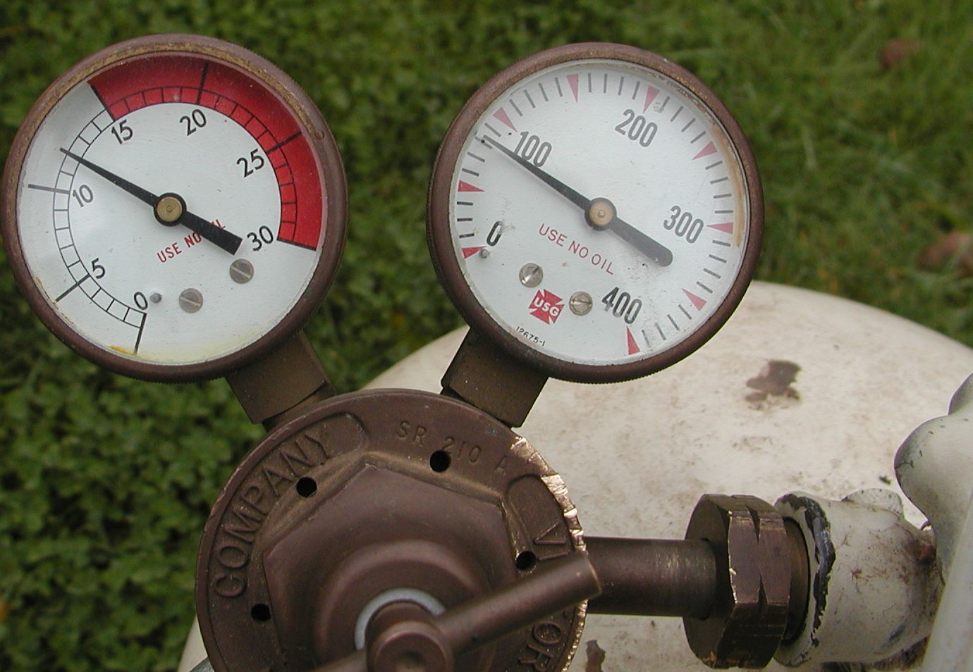

I would recommend a low pressure cannon with a fast valve so the variables in the valve opening is very consistent shot to shot. Use a low pressure gauge to very accurately repeat the pressure for each shot. Maybe a quality welding gas regulator or just gauge for 0-30 PSI is in order. 30 PSI is plenty of pressure to reach the farthest target with a golfball in a proper launcher.
A hand operated ball valve won't provide the consistency you require. Sprinkler valves are a little twitchy in the lower pressure range. A quality piston valve that moves very smooth without binding is key. A very small EQ port and reasonable trigger valve is required. Avoid a blow gun due to flow level on low pressure cannons. Use a brass smooth operating ball valve. A "Full Flow" ball valve works well. Many ball valves have a small orifice. Avoid those for the same reason to avoid a blow gun. High flow rate reduces the pressure lost through the piston EQ port for more consistent shots. A hand pulled QDV may be OK but their disadvantage is the possibility of messing up your aim when firing it, so I don't recommend one unless you modify one to use a spring trigger.

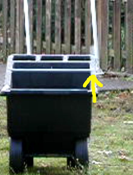

We graphed our launches with our competition t shirt launchers. There were lots of field tests, so when it came to the actual game, we could pick a retired number or the back row of the 300 section and put one right where we wanted it. We knew the distance, the elevation, etc. Dialing in the shots didn't take much.
Know your cannon, know the range, take lots of test shots and measure each one. Graph them.
In a piston it is important to have a SMALL leak between the chamber and the pilot area.. This is the equalization port or EQ port for short. If it is too big, then the cannon tends to not fire and the chamber pressure bleeds down a lot before it goes off so consistency is poor.
The QDV is the Quick Dump Valve cannon which uses a spool valve piston so it is mechanically opened by pulling a rod instead of triggered by opening a valve. This tends to shake the cannon some which may diminish the accuracy of the shots. Other than shaking the cannon, the QDV is a very consistent valve.
