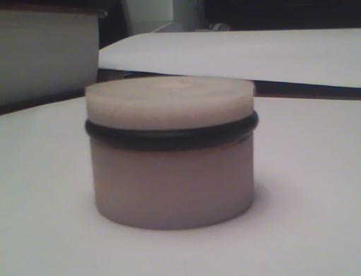

Well here's a pic of my new (White) Teflon piston, machined on drill press, Floating O-ring grooves cut with needle file's.

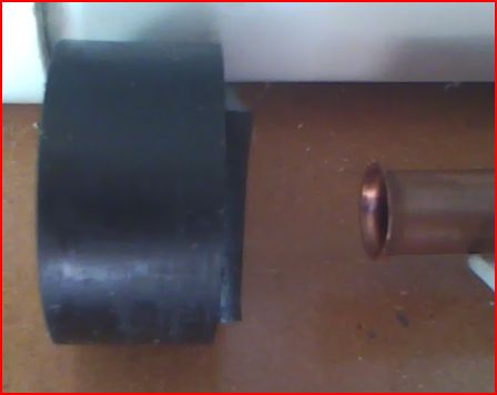

(Black piston used for this fps examination, http://www.spudfiles.com/forums/audacit ... 19423.html)
I showed dad this he thought i'd used the lathe, (not allowed to atm coz of one finger incident already :P) Anyway, i'm going to get some lessons, so hopefully some cooler ones coming up :)
Old one, still works well, longer that it needs to be i feel as weight is on the heavy side.
piston and barrel.JPG (20.99 KiB) Viewed 2331 times
The new one with floating O-ring
New piston.jpg (10.25 KiB) Viewed 2331 times
