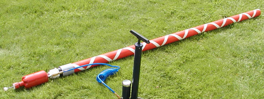

The difference in gas consumption is huge between a high muzzle pressure and a low pressure. Launching tennis balls with the 7 foot TB barrel on the Marshmallow Cannon or the larger TB cannon provides a relatively large increase in range, but the time to pump up the large cannon vs the little one is huge.
I was looking for the Marshmallow Cannon tennis ball launch photos, but I have misplaced them. I'll post them later if I find them.
Edit, found the picture of the Marshmallow Cannon tennis ball performance.
