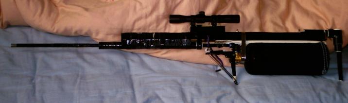

I come from China.Likes playing the air-gun, but because is the national guns law limit does not have the means to realize this desire .
.Therefore I used a very ordinary material to make an air-gun.Like this also can satisfy plays the air-gun the desire.
Even if all cannot that exit like this in our country this kind of thing to play, can capture.But the hobby is a hobby, this air-gun on only places in the family to play.

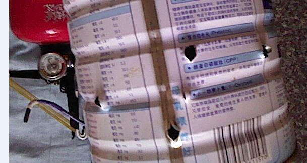

6mm steel ball fire, A meter distance might.

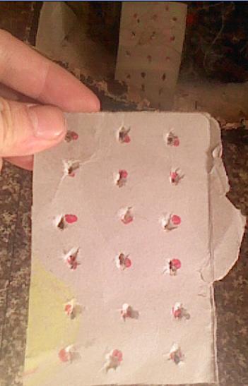

15 meter distance 10 gun dispersions in 2cm scope.
5 meter distance precisions

VERY nice accuracy. you should give a painjob besides flat black a try.
rp181 wrote:Thats like saying "learn spanish". english isn't his native language, so that is fine.
Agreed, no need to be harsh.

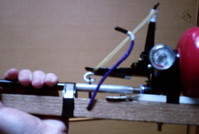

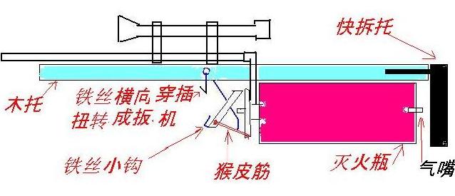

Very well done with the launcher, the accuracy and power are impressive, Reminds me of my first efforts at the time when I couldn't legally get airguns :) Is that some sort of hammer valve you have there?

Nice way of using a fire extinguisher for a chamber. I also like how you've made a trigger from some bent wire and a rubber band (it's kinda MacGyver-ish). What PSI (or BAR, whatever is used over there) do you charge it up to?
