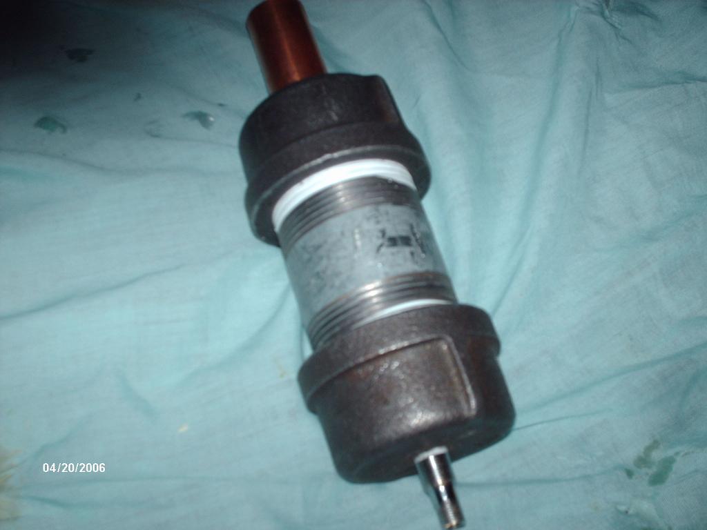

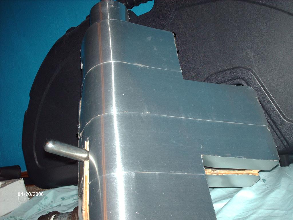

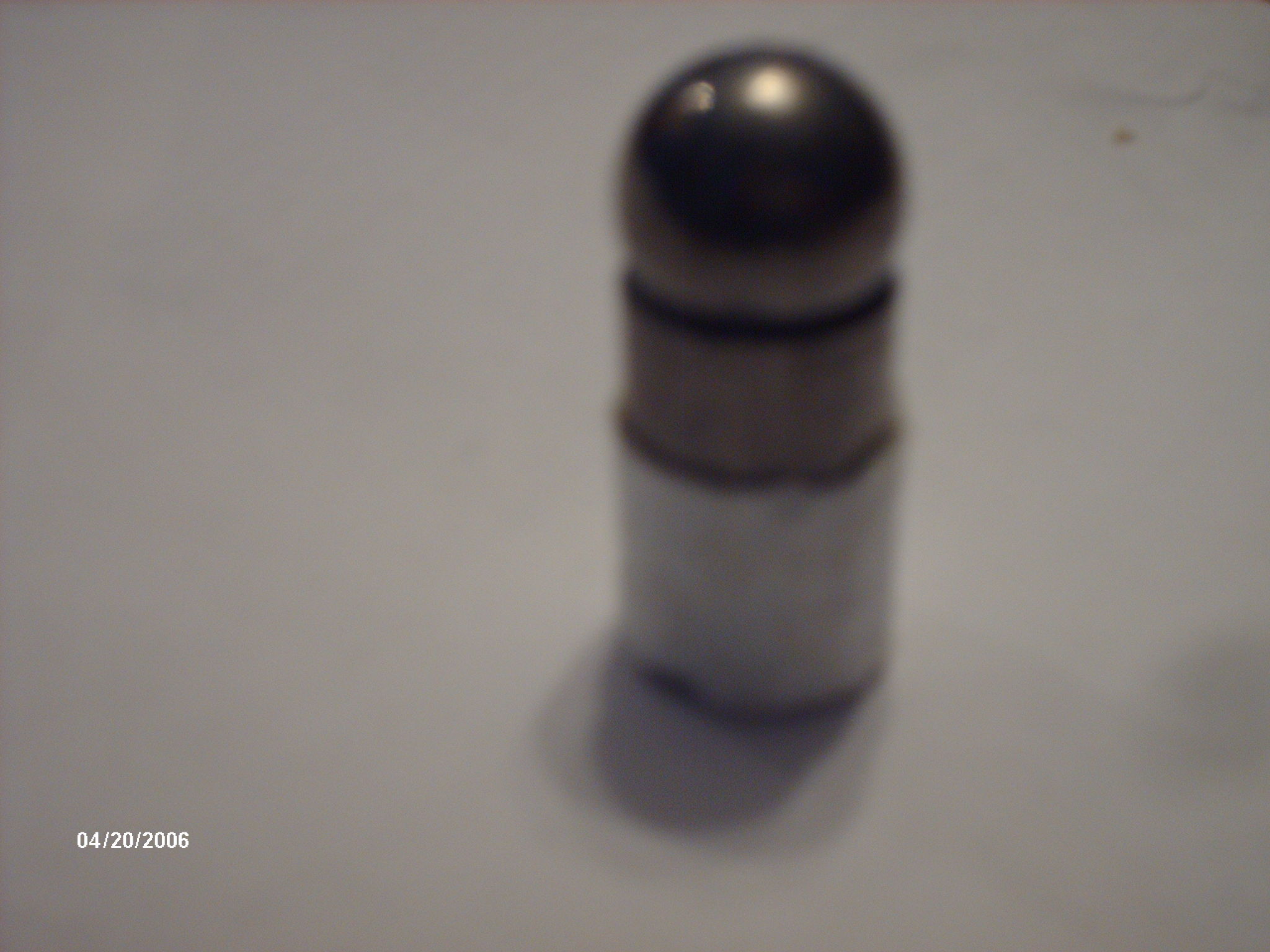

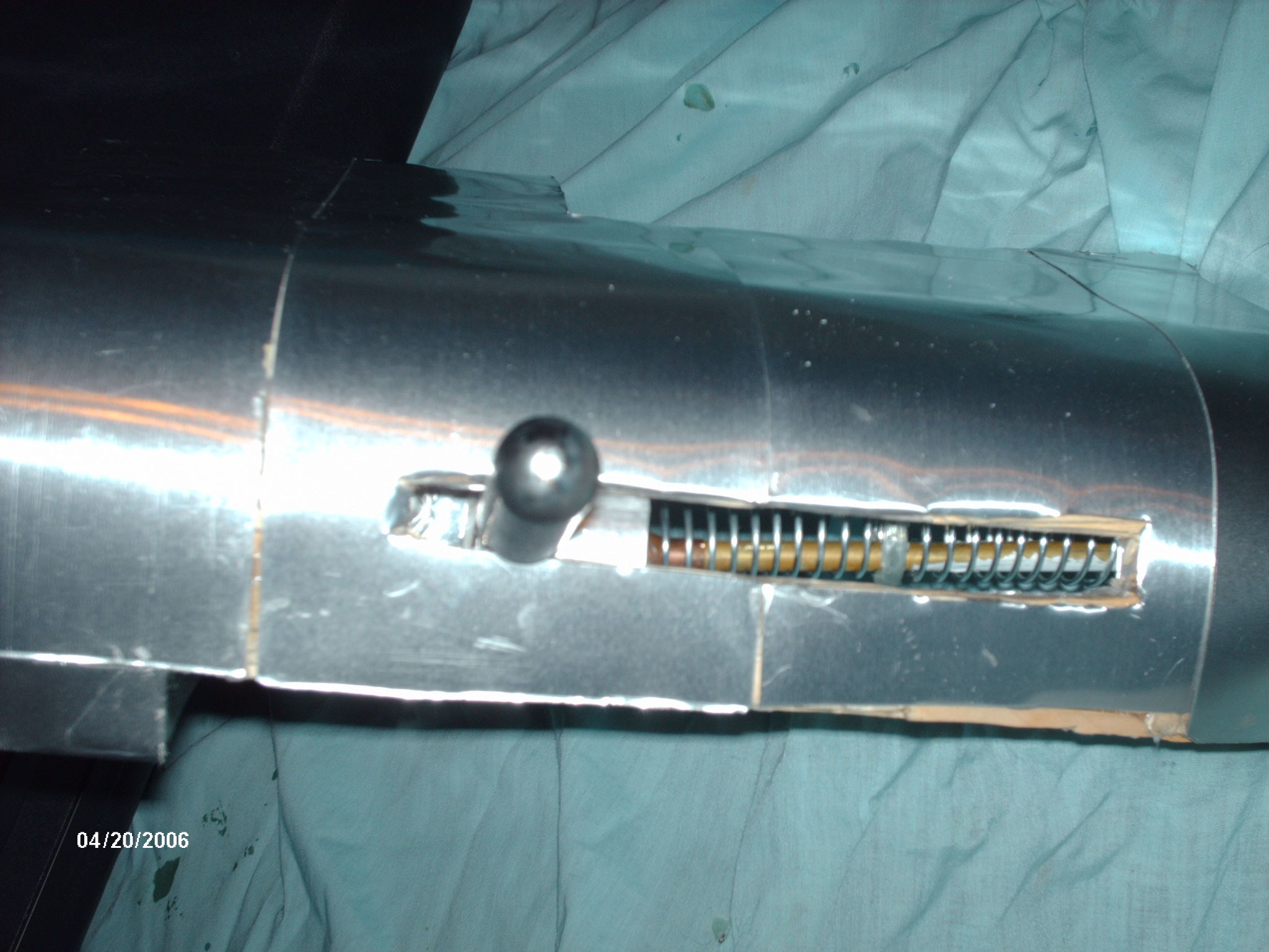

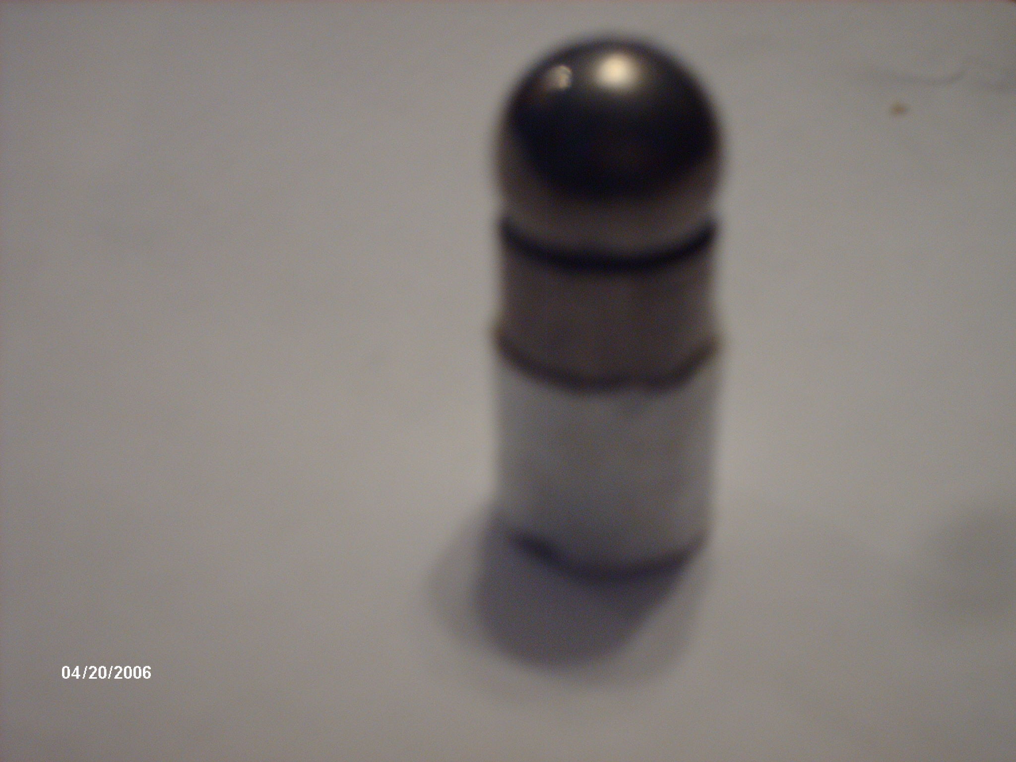

After being inspired by JSR's combustion cartridge awhile back I decided to attempt my own with hybrid mixes. Ignition still needs work and metering still needs tweaking but it is coming along. It has also successfully loaded an empty cartridge :lol: .Feel free to ask questions.
My soon to be ammo

The bolt

wow looks great, what mixes do you plan on using? Is the fill valve a schrader, and if so how do you inject the propane. And last, where's the burst disk?

Also what sizes are the cartridge pipes?

@ JDP http://tinypic.com/view.php?pic=27x4fuc&s=6 This the sealing face for the burst disk. The cap has poured epoxy resin in it and the pipe nipple has epoxy putty to help compress the burst disk.
@DWV It is a 1.5 x 3" pipe nipple capped with black iron caps.
@Lockednloaded I plan on 10x shots with mapp willing through schrader.

Ah. So a homemade union in essence. Have you tested it for sealing??
irisher
Posts: 420
Joined: Mon Dec 29, 2008 2:53 am
I have tested with my shock pump. When heavily torqued down no air leaks through the barrel. However the threads where the nipple meets the cap has tended to leak slightly.

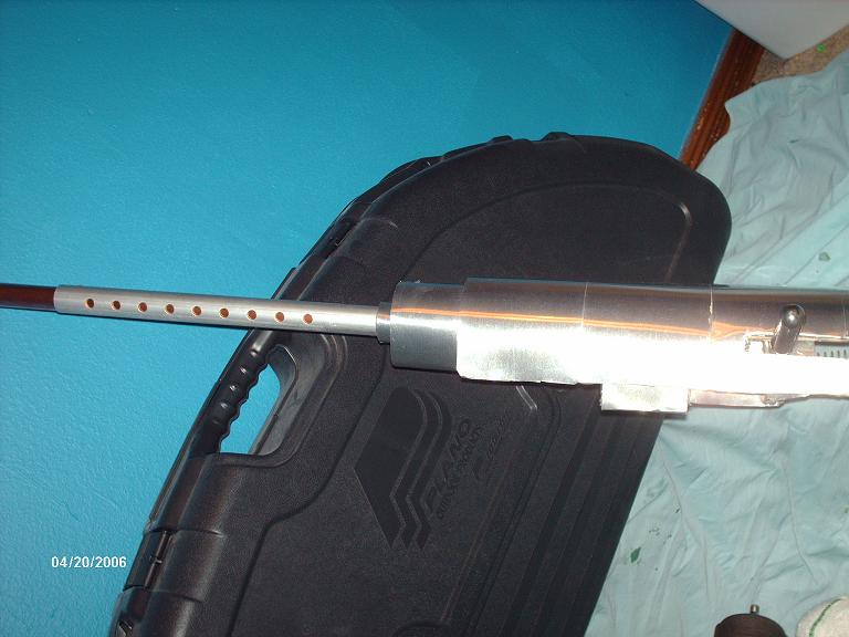

I forgot to show the sight in the previous pictures. Image

Is that a computer fan guard?

Shush, no one needed to know that. :P

Actually, that's a really good idea...I may have to steal that for my next build. :P
ilovetoblowthingsup wrote: The yellow/orange back fits super snugly, very nice in fact, but the head does not fit.
irisher wrote:Shush, no one needed to know that. :P
I think anyone who's ever taken a PC apart (and that's probably msot people here :P) would recognise it immediately ;)
More of an anti-aircraft sight though, are you worried about police interference :D

I was kind of going for the AA look. I plan on mounting it to a tripod so I think it go along well.
