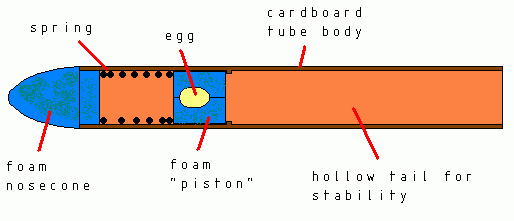

My first thought is a tubular projectile with the egg in the centre of a section of foam that fits exactly in the tube as a sort of piston. Between this piston and the nose of the projectile you could have some sort of spring which allows the piston to move forward as the projectile decelerates on impact.
The piston could be cast around the egg using expaning foam, then cut in half for easy access.

Go with JSRs design for the projectile a spring is FAR more reliable than an air piston when you are using something so imperfectally shaped as an egg.

The only thing i can add, is possibly another spring behind the egg. so as to cradle the egg and actually suspend it inside foam casing that is inside the projectile.

This is the basic projectile concept I was describing:
- egg.gif (4.74 KiB) Viewed 9730 times
If i were to make a gun to do that i would use a sprinkler valve or a ball valve actually. The slow opening time would give the egg a nice launch while if you had a big air chamber and a long barrel the air would increase the velocity as it slid along the barrel. then use something like JSR's projectile (above). For improved performance you could use a spring loaded ball valve to speed the opening time up.
