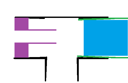

Though really the main reason so many of my cannons are Coaxial (inline) is that the housing for the piston is much more constant. The reason for this is that PVC fittings taper in. In order to gane the same constant fit for your piston, the T fitting has to be sand down so that the pipe doesn't constrict when fitted.
If this isn't done and you have made a very nice piston with a very little gap that fits perfectly in your pipe you may find that when fitted together in the T the piston will jam before it reaches the barrel.
something like this, im sure you can figure it out.
