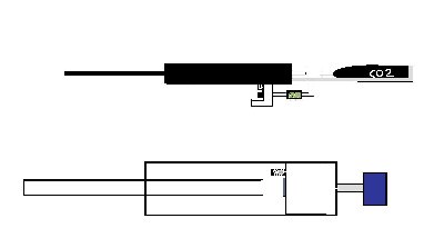

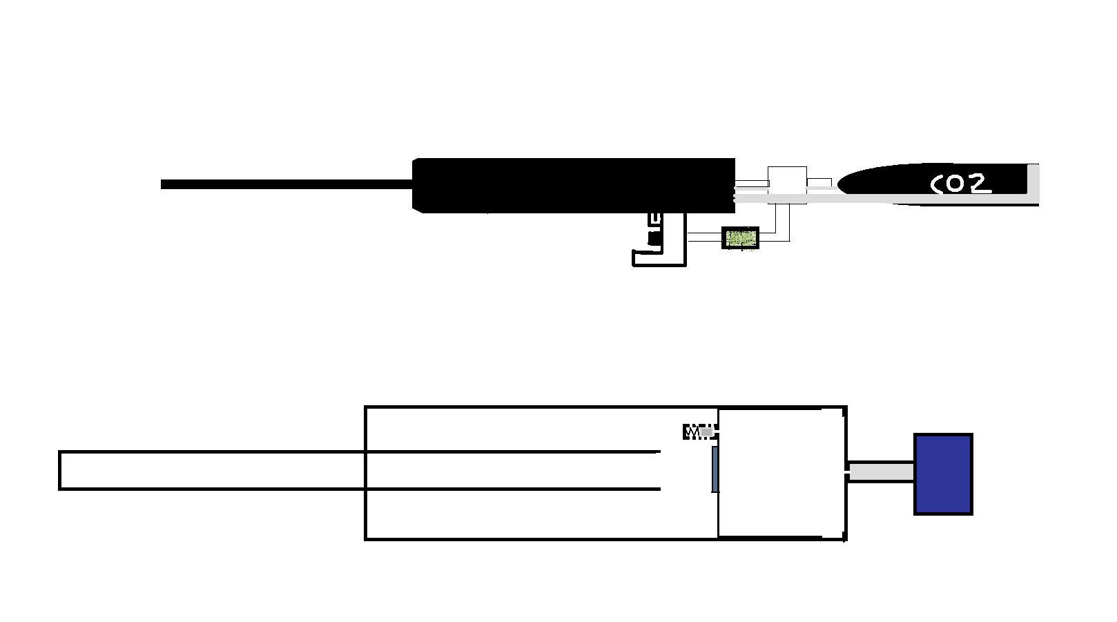

OK so i thought that i would actually draw some pictures. so here they are.
EDIT: btw the ammo will be wax bullets. im using wax as it is easy to cast and apparently acts like lead at high enough velocities. Would 500 psi be enough for that velocity?
- The first picture of the overall design, simplified. The top picture show what is will all look like without the pine timber casing that i want to make for it like a few ppl have already done. THe second picture is the piston design that im going for and it shows the checker valve that i would like to use to decrease pressurising time.

you can get galvanized iron pipe and fittings from bunning that can handle 500psi it just standard water pipe they say 150psi but it much more. people here i have seen used up to 40 bar(580psi)
to release the air behind the piston you could use any valve, a blowgun will give you a trigger but wont handle 500psi, use a 3 way and you can get semi-auto (wait for poland_spud for more info) if you use this option you don't need a solenoid valve.
and to get 500psi air compressor you can use a frigde compressor
500psi and a piston valve it make that wax slug go fast and hurt like hell
but its week ammo use matal ball bearings or darts
if you psiton is not air tight it wont need a check valve make sure that you piston can take the force or 500psi youll need a metal one

- POLAND_SPUD
- Posts: 5402
hi,
Do you by any chance come from Russia ??
I suggest using galvanized fittings and pipes, I am sure you have them there since it's the most common plumbing material used here too
uhmm you can check my semiauto gun here ->
http://www.spudfiles.com/forums/semiaut ... 20259.html
it uses a QEV valve (piston valve) and a 3 way valve for piloting the QEV... usign these two you an build a semi automatic gun...
have a look at the animation there - it's harder to understand than it really is

- Brian the brain
- Posts: 3497
- Location: Holland
- Been thanked: 7 times
Please get a regulator for the paintballtank.
A CO2 bottle puts out 900 psi or 60 bar.
An inline regulator would take it down to a more reasonable pressure and will save a LOT of gas.
Without it you will most likely be charging the gun with liquid CO2 wich is much more dense and empties the tank much too fast without ay real gain.
40 bar will give you more than enough power.
60 is just too dangerous.
