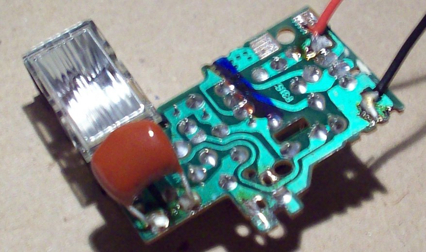

I was sitting around thinking about how to use a camera flash to produce sparks as fast as you could pull the trigger, and came up to the common problem of the charge time for the big (220uF) photocapacitor.
So, what's the simple way to reduce this time?
220uF seemed overkill for what I was trying to do (provide a pulse of current to drive an ignition coil), so the obvious thing to do (for me) was to replace the capacitor.
I replaced the capacitor with a 0.01uF 400V metal film one, which produces much dimmer arcs through the flash tube when discharged, but charges very fast (to fast to bother measuring).
I still haven't used it to drive an ignition coil, just thought you'd like to see. Will update with performance when I do. Any ideas on the speed at which these metal film capacitors discharge compared to a photocap?
EDIT: I also don't know how much power is lost with this capacitor using the flash tube as a switch, but it should be easier to switch this capacitor than the bigger 220uF one, so I'll probably use some sort of MOSFET or a contact switch, depending.

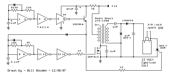

For a hint, look up some schematics online for the value of the capacitor used in Capacitor Discharge Ignition Systems. 0.01 uF is a little on the small side. Typical sizes are 0.5 to 2.0 uF depending on the voltage used. A 2 uF will work well at the typical disposable flash camera charge voltages. Do not use a standard electrolytic for this. They have too much series resistance (ESR) so either use a flash cap (made for the pulse) or use a polyester, mylar, or other low ESR cap. An SCR is often used for the discharge trigger on those.
For spark length, that is determined by the peak voltage applied. A camera flash unit typically runs 160 Volts and a CDI in a car is often 400 Volts or more. With 2 uF, you should get reasonable sparks with plenty of snap, but the initial strike distance will be limited.
This schematic shows a typical circuit for a home built ignition. Use the HV side and the SCR to fire the coil. Use the pre built flash for the source of the high voltage. Do not use the flashtube as a trigger device. It dumps a lot of the power as light that you want in the spark instead.

Thanks hotwired, now I think the flash-based circuitry I have in mind is still viable.
So, to make sure, all you did (besides the obvious change in circuitry to repeat sparks), was replace the large photocap with a 220nF one?
Pretty much yes.
The replacement cap is still about the same physical size as the electrolytic but only has ~ 1/500 of the capacitance (100-120uF vs 0.22uF/220nF)
I'm using metal foil/metallised ones by the way.
