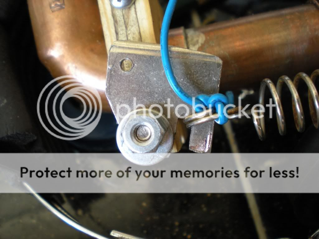

I put this together in a few hours today.
I made split hole wood clamps to hold the spring and the sear.
Note the ghetto wire hanger trigger.
It works surprisingly well for my first attempt at a trigger.
I am not going for max speed or efficiency, just reproducibility of opening the BV.

I have been asked about the sear:
I just threw it together before going on a trip to try it out.
Not the finished set-up.
As for the sear, it is a 1" x 1" piece of scrap steel cut from a drapery rod L bracket that I found.
It had a hole in it large enough for a # 8 screw.
I cut a notch about 1/8" wide and 1/4" deep such that when the spring pulls the notch it lines up perpendicular to the line formed by the stretched spring and the screw holding the sear to the wood clamp.
The sear lines itself up and it will not move to release until it is rotated around its mounting screw.
Incidentally, I used the same screw for the wood clamp to mount the sear and at the muzzle to attach the spring.
The wood clamp at the muzzle is cut on one side and has just a single screw.
At the rear, 2 screws are needed to hold the 2 part wood clamp.
Next, I drilled a hole off to the side so that when I pulled, the sear would rotate away from the open end of the notch.
Using a fish scale, I measured 7 pounds of spring force and about 2 pounds of trigger pull.
Quite small and effective, I think.
