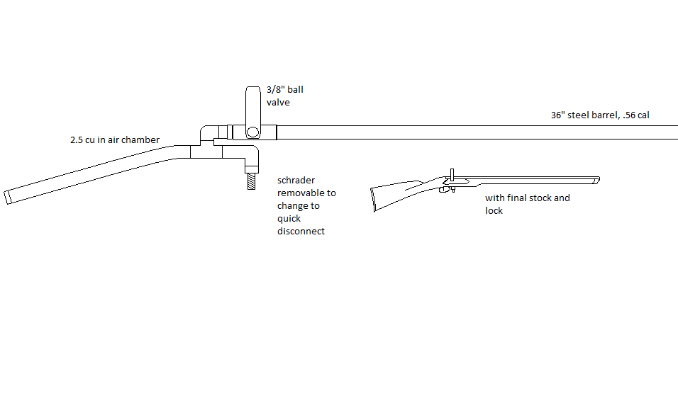

Hello folks. Just started my first serious airgun build with the end goal of a nice handy, slim, and portable gun to trek around the woods and plink cans with. I was inspired by some of Brian the Brain's creations here on Spudfiles, such as his coaxial pirate pistol and hammer valve flintlock designs, I'm also a huge fan of the buttstock reservoir airguns our ancestors used, such as the Lukens, and of course, the Girandoni, so I would love to end up with something reminiscent of these airguns, not in complexity but maybe in looks...from a squinting distance.
I realize ball valve launcher's are relatively poor performers. At first I was aiming for a coaxial piston pnuematic as they're far more compact than even a ball valve, however I opted for a ball valve simply because I wanted the ability to disassemble and modify the chamber, plus they seem to be far less finicky.
Anyway, simple design with only 4 vital components
-36" long, .56 cal barrel
-13" long, 1/2" copper reservoir
-3/8" ball valve
-Lock aka mechanism which will allow the ball valve to snap open with the pull of a trigger
airgun design.png (9.35 KiB) Viewed 12965 times
I don't know if this is the optimal barrel/chamber ratio, however I want to keep the chamber on the small side while still using the long barrel to it's fullest. I've tested it already and the results are very exciting, I used an old bike pump and with just 2 good pumps (and using my hands to open the valve) I was able to shoot a 1/2" ball bearing faster than a slingshot with powerful flat bands. :shock:

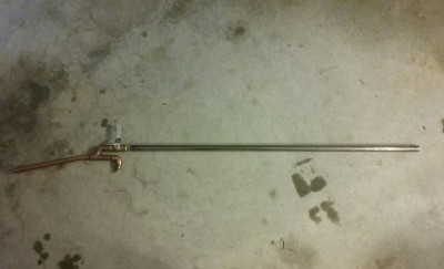

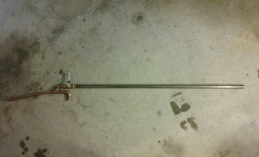

What I have so far, chamber, valve, and barrel.

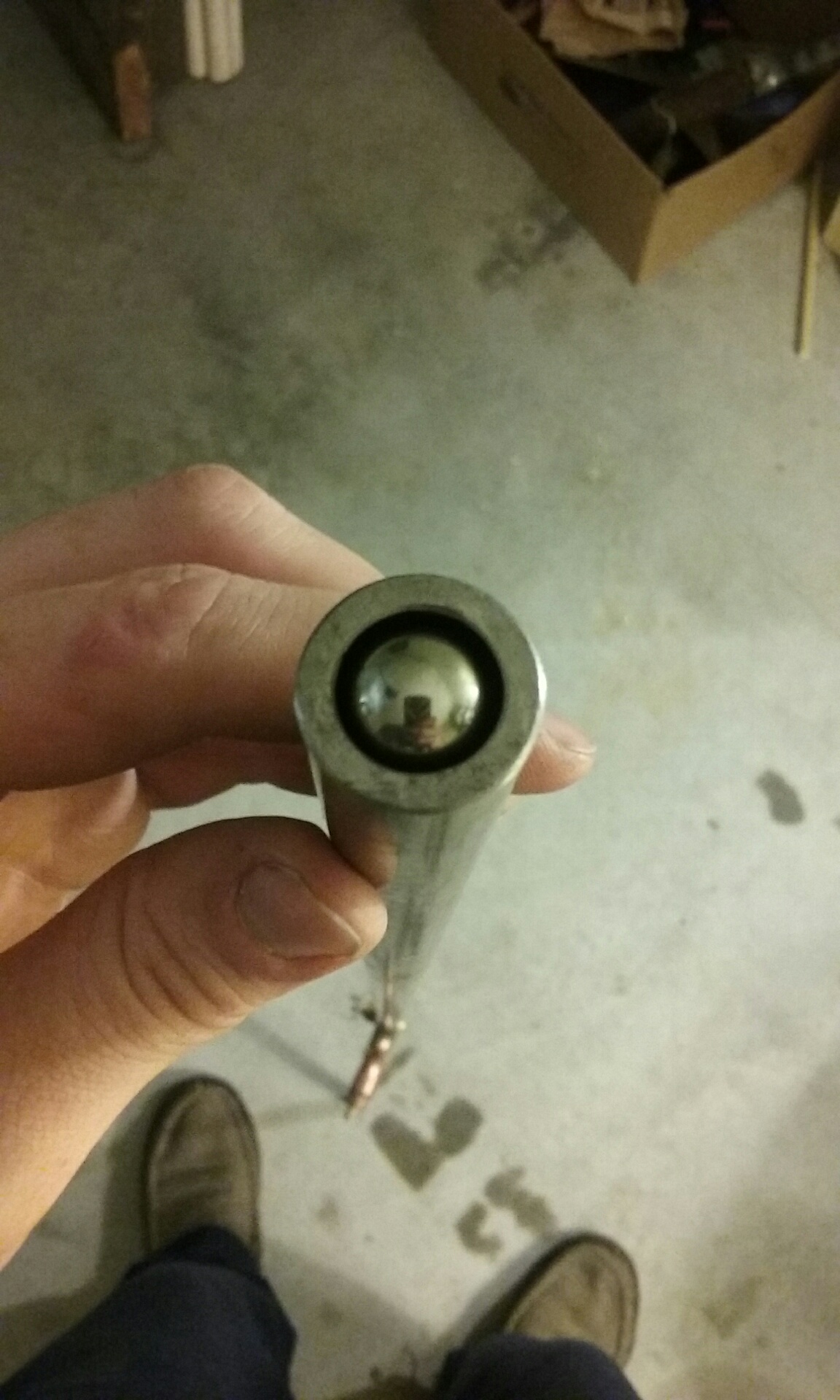

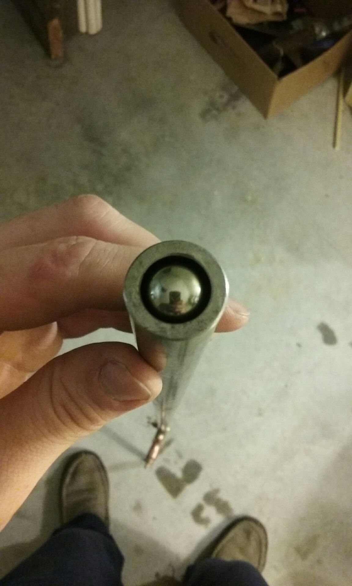

The barrel is seamless steel pipe I found online, with a 1/2" steel ball bearing the fit is so exact it has an almost air tight fit in the barrel. Even the thinnest of patching will cause it to be very difficult to get down the barrel.

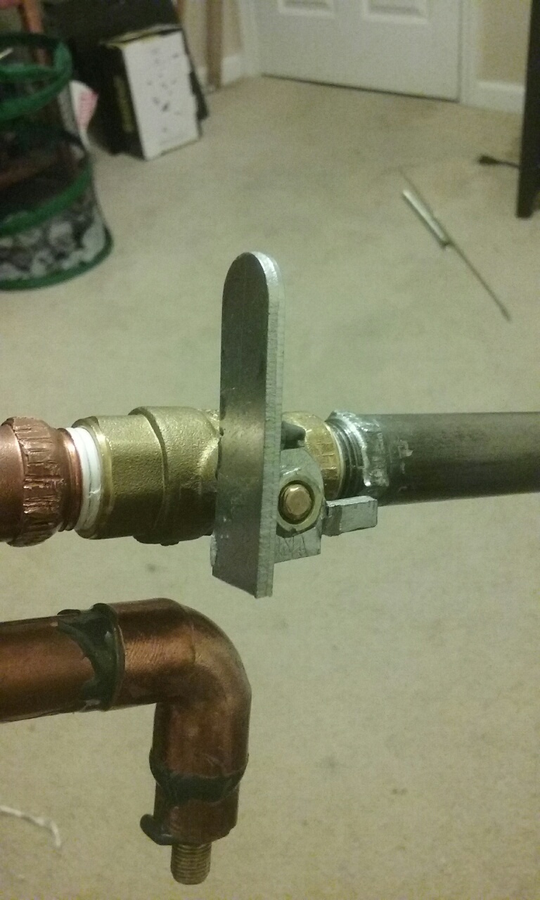

Today's challenge was trying to turn the ball valve handle into a faux flintlock frizzen
Which is supposed to emulate the flat L-shaped piece here
The purpose of the frizzen on a real gun is to give the flint a steel surface to scrape and spark against, the purpose of my frizzen is to be a surface for the hammer to collide with at high speed which will turn the valve faster than a spring alone, it's comparable to pushing a door open vs kicking it open. Right now it's just epoxied together, I don't expect the epoxy to hold, especially since this piece will be subject to a lot of stress, I will braze or solder this eventually.
