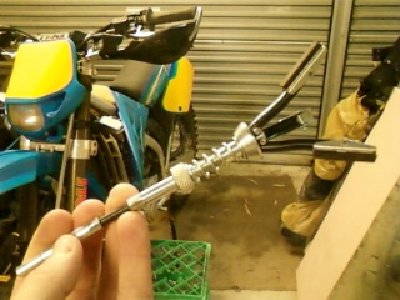

Ive decided a low pressure co-axil would not be satisfying enough for me so i need to build a pump (I would find a fridge compressor but there like gold here) i was going to build a pump like Gippeto's ''stirrup pump''. but than changed to more of a design of far_cry's shock pump.
http://www.spudfiles.com/forums/my-seco ... 18650.html
QUESTION.
I have decided to use 3/4 Galvanized pipe (Cheap, sting, manageable)
BUT there is a welded notch that run's along the inside length of the pipe would this be a problem.?
Has any one used Galvanized pipe for a pumps main body
Pump Shaft Usable?

After you get it close to smooth, you could try a brake cylinder hone from harbor freight in a drill on an extension rod.
For a pump type length, it would be harder, especially for a small diameter. Even with a lathe, boring bars can only be only so long before they flex.

Brake cylinder hones are made for glaze breaking. They are very slow in cutting metal. Sandpaper is much faster cutting. A hone is OK for finishing touches, but not for ridge cutting. You will want a course fast cutting grit to get the job done quickly then finished up with a fine grit for the polish. My rusty barrel was done with 80, 120, & 150 grit. 300 & 600 grit is not needed unless you are looking for a mirror finish. Most of the heavy cutting is done with large grit.

I own and use a brake cylinder hone Ive used on my steel coaxial for the pistons stoke, the only thing that would be the best and easiest is "Technician1002"s technique.
