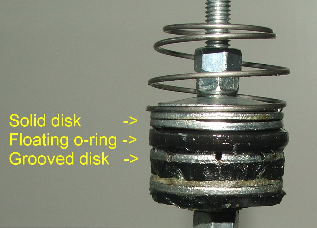

I came up with this when renovating my long-ignored airsoft semi. By cutting grooves in one of the edges that seal against a floating o-ring (described here), I'm allowing the air escape around the o-ring in one direction. When the pressure is reversed, the o-ring seals perfectly against the other, solid edge.
This is ideal for piston valves in cannons that are charged through the pilot area.
The image below is my implementation, it's kind of ghetto but it works great and seems very reliable. I will upgrade my other cannons to this design if/when their current pistons fail.
Combined floating o-ring and one-way valve

I also saw the same thing in my hand pump for balloons and balls. One side has two grooves cut in it to allow air to go back in front of the seal.
