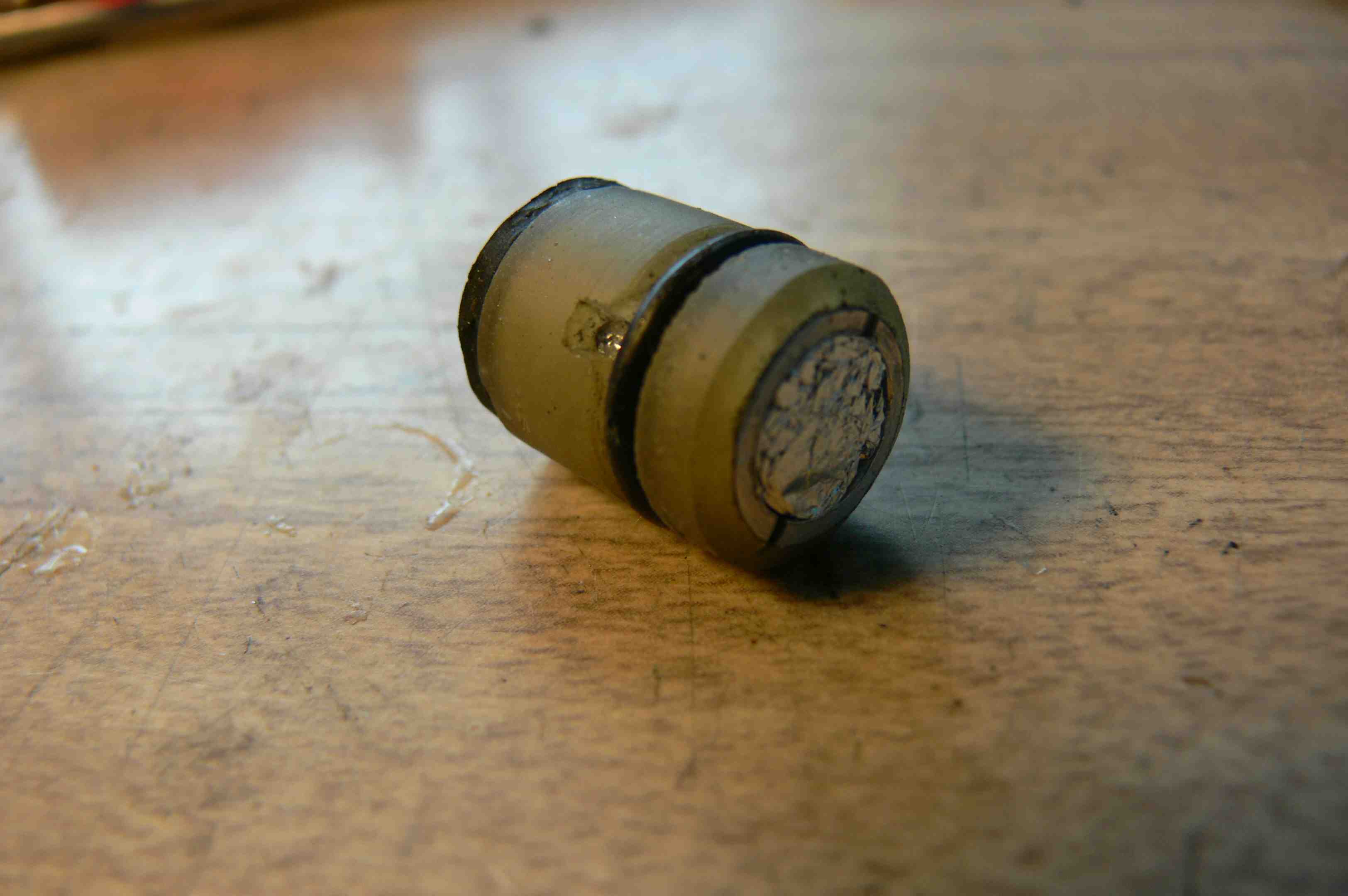

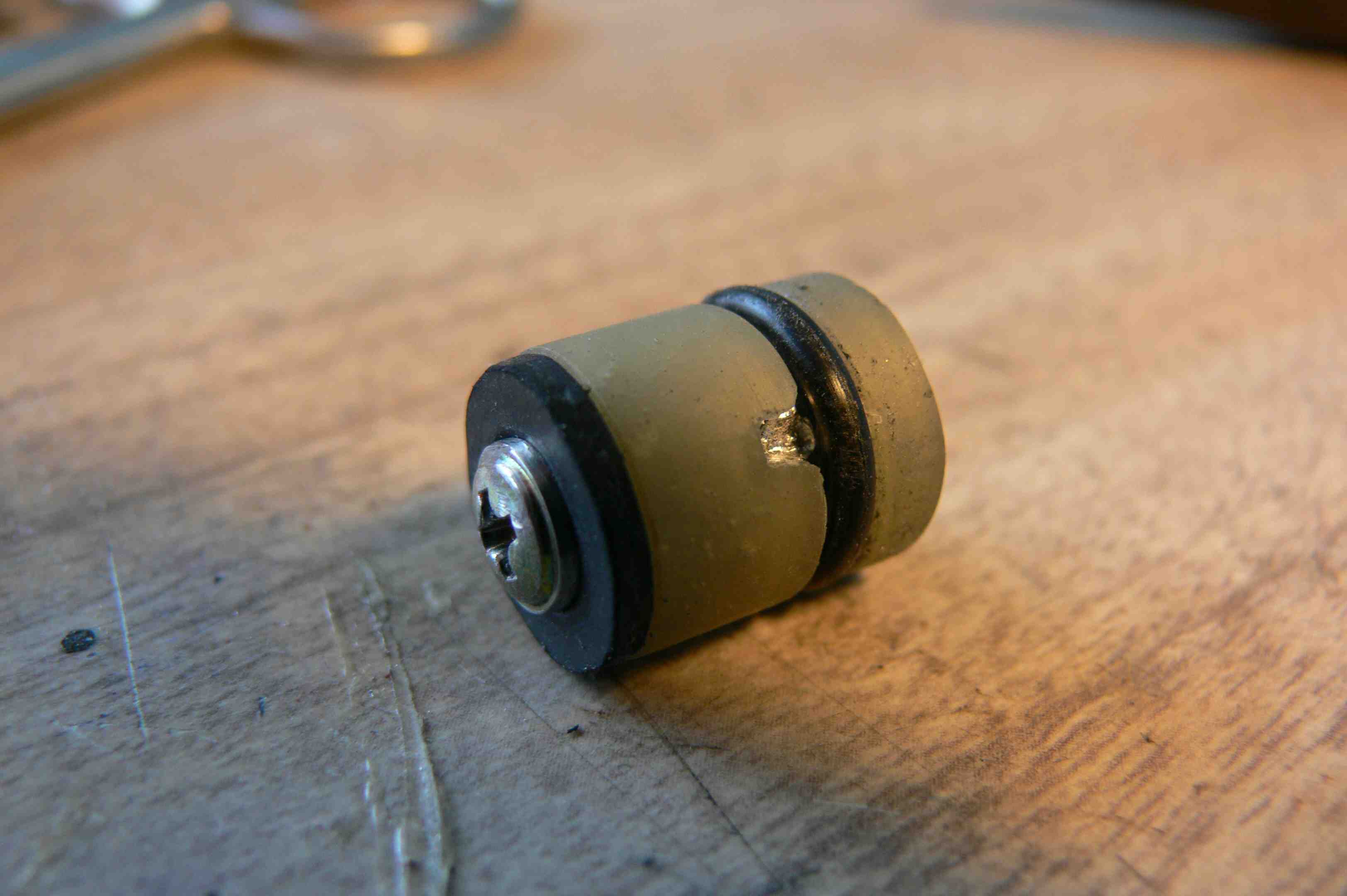

hey this is a floating O-ring piston i made for an 8mm coaxial pneumatic
the piston is made of a section of 8mm ID aluminium tube with epoxy coating and end plugs (in the photo it is just aluminium foil, but is going to be the filler) sealing face is attached with a screw and an O-ring for the check valve, fits 13mm ID chamber, tell me what you think, questions are welcome
front of piston
front of piston
back of piston
back of piston

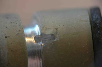

O-ring channel, lightly machined on a drill

did you make the oring groove with a hand drill?
I love lamp
ilovefire
Posts: 511
Lockednloaded wrote:did you make the oring groove with a hand drill?
yea, the epoxy part was easy and i only hat to take like 1/2mm of the aluminum tube so it wasnt that hard, just a little awkward

I think some body's been paying attention. A simple yet surprisingly effective way to control internal flow of the valve. :)
Should work very well, but the porting in the groove is larger than it needs to be.
Yer gonna like the way it works. :wink:

Gippeto wrote:I think some body's been paying attention. A simple yet surprisingly effective way to control internal flow of the valve. :)
yea well i thought i would give something like that a go because i found a O-ring that was almost a perfect fit, but the funny thing is i didnt even use it i bought a better one :lol:
