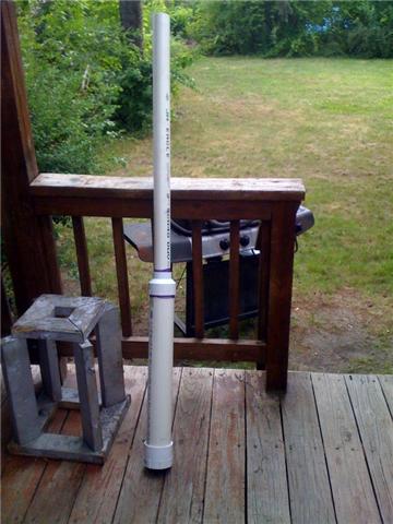

Hey guys I'm new here. I made my first spud gun yesturday. It has a 3"x24" chamber and a 2"x36" barrel. Both have 226 cubic inches of volume if my math is correct. I shot it using a russet potatoe and 6 seconds of aquanet, but it only went about 20 yards. It fired first time I hit the grill igniter so I don't believe it's rich. Should I go for more spray or cut the barrel shorter?

I'll give that a try tonight. I know this should have the potential to go further than 20 yards. I do eventually want to try setting it up with metered mapp.

Could you post a picture?

Im thinking about trying some propane. Should it be about the same amount 3 seconds or so? Heres a pic of it if it loaded right.
