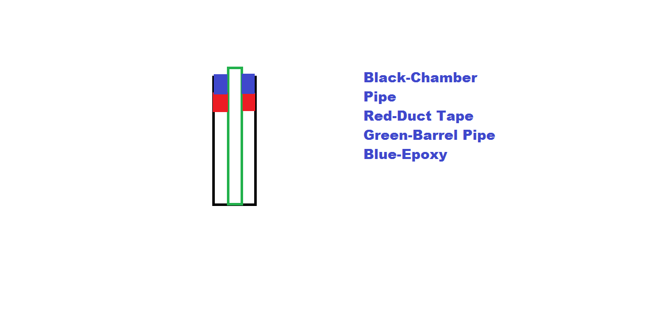

On my new "stick gun"(a coax) the chambers 1" pvc and the barrels 1/2" cpvc. Since they are different pipe i will be using JSRs epoxy method to connect them, my questions how thick should the epoxy be.
- epoxt thickness.png (20.39 KiB) Viewed 1996 times

What pressure do you plan on running at?

100 psi

Assuming that you're using good quality epoxy and properly roughen up the PVC, 1/4" thickness should be more than enough.

Im using Devcon 2 part epoxy that comes ina double syringe, its rated to 1500 psi

this stuff?
I usually find that the quicker it takes to cure, epoxy tends to be relatively weaker, plus this stuff looks like it will be more of a paste thank a liquid meaning you might find it difficult to "pour" as a casting. Still, if you pile it on thick enough it should do.

That's it but it's a liquid, I already cast a piston from it around a rubber stopper and I'm about to pour it for the fitting thanks I'll use about a half inch so it wont leak thanks
