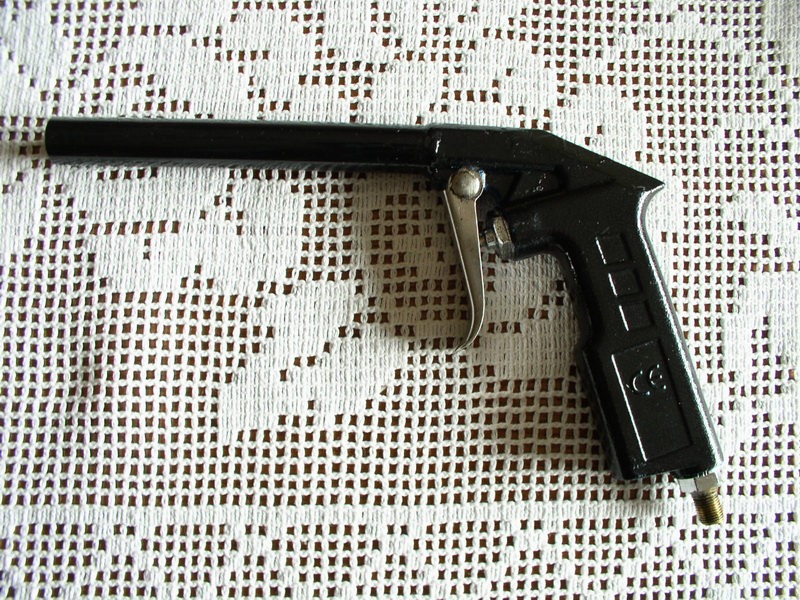

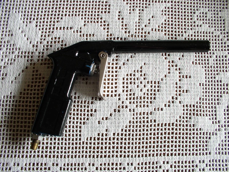

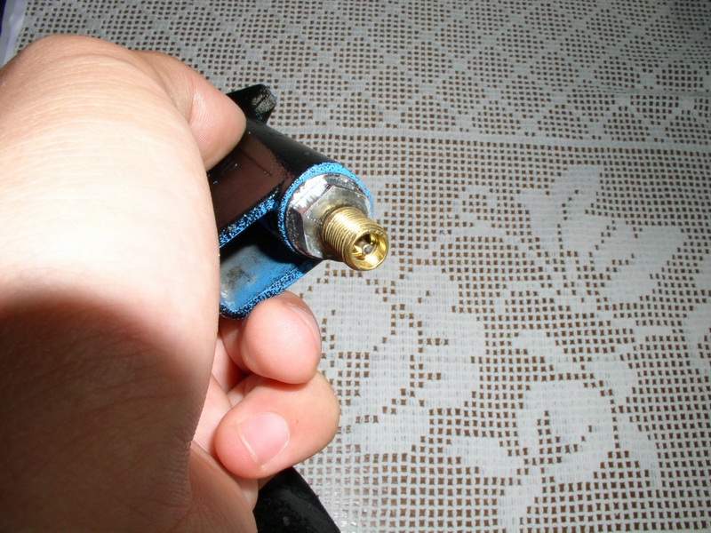

This is my latest build, a bb airsift pistol. So far only test it at 100 psi but as i'm going to buy a shock pumb i will shot it at 200 psi pretty soon :D .Was thinking about a camo paint but black stays good :) .video at

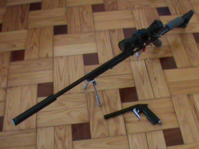

simple, and like your sniper, attractive. I like it.

Nice compact and simple pistol!

Nice job. You've been cranking out a ton of guns lately, and they are actually pretty nice. Most of the time when people do that they are piles of @^%$%& but you are another story. Nice :D

I like it, its simple but effective. And gun freak just becauuse they post a lot of guns in a short period does not mean there bad. They could of built them over several months or years and just joined or gotten around to posting. If you have acess a regged co2 tank or unregged propane and a simple Tmag dentent would make that a great semi for airsoft wars.

wyz2285, not a bad effort - if you load multiple BBs you should have a nice little burst fire machine pistol, and a detent at the breech will negate the disadvantage of the relatively slow opening blowgun valve.

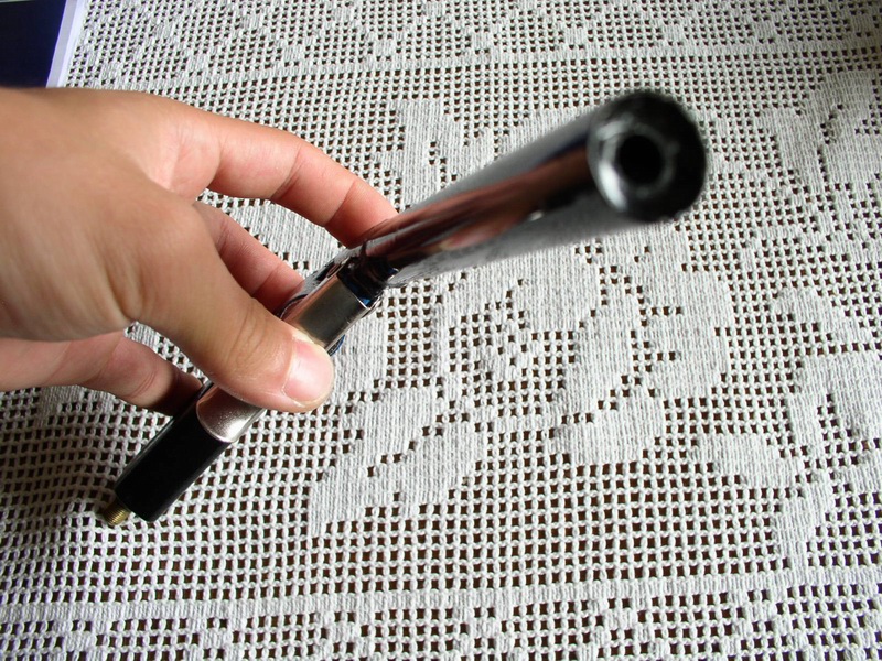

jackssmirkingrevenge wrote:wyz2285, not a bad effort - if you load multiple BBs you should have a nice little burst fire machine pistol, and a detent at the breech will negate the disadvantage of the relatively slow opening blowgun valve
I have a tube in the end of the barrel,so when i put in the bb, it doesn't fall out,i call it "magic barrel" but it only works with one bb at time (if you watch my video you will see)

looks very fun. how did you make the barrel so the bb's dont fall out?

it´s a rubber tube, when you put the bb it falls in and get in the tube by inercy.so it doesn´t fall out that easy.

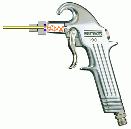

By having the space between a detent breech and the valve port as a chamber, you could make a semi/auto pistol quite simply. A light touch on the trigger will give you single shots, upping to full auto when fully depressed. Probably not feasible using just the blowgun body as a chamber, but you could always hook it up to a larger tank.

I'm sure you could fit about 5 airsoft BBs in the space between the valve and the barrel, and really for the tiny chamber that you have this would be enough.
