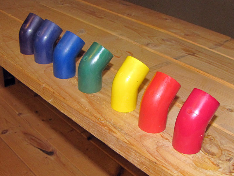

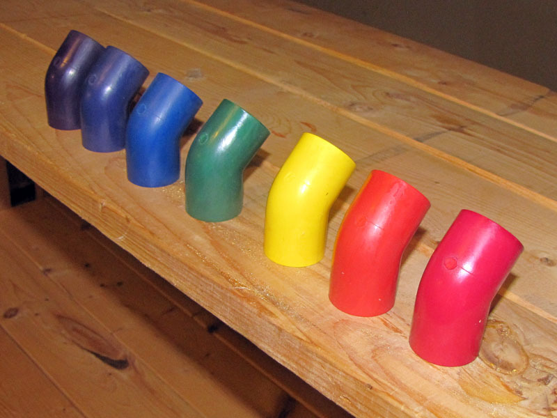

Sorry for the title. I was thinking a place to put all the PVC construction tips in one place for an easy reference. After having success bending forming, crowning etc, I learned a new trick.. staining PVC. It does not chip, peel, or wear off.
I'll add stuff for how to bend PVC, but first I am adding something I found tonight. How to make your own purple primer in any color you like.

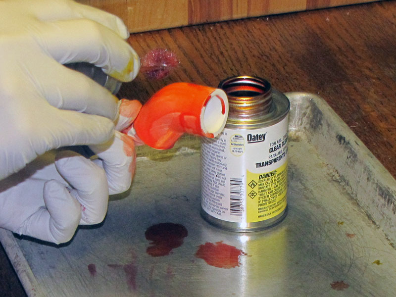

In case it goes down, the instructions are to use ABS/PVC cleaner. Do not use PVC cleaner as it is lacking the magic ingredient. Find the cleaner with tetrahydrofuran (THF).
The other ingredient needed is "Solvent dye" or "fuel dye". Add to the cleaner and mix. Then with a dauber, stain the pipe and wipe off.
Wipe off the excess with a paper towel and let dry.
Edit, could not get linked photos to work. Adding them below.

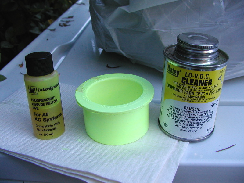

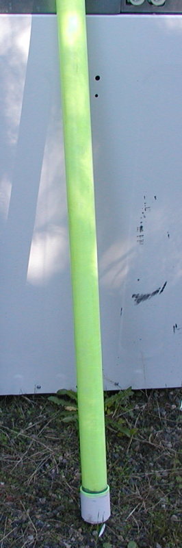

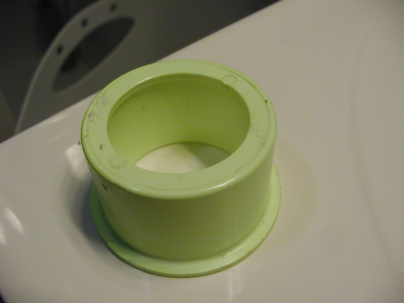

I had to try this. I stopped by my local hardware store and found the right cleaner.
I have some oil dye that is used to find leaks in refrigeration systems by making the oil glow under blacklight. The photos show the result. Success.
My camera doesn't like the fluorescent color and shows it much more green than it is. It looks more like a yellow fluorescent highlighter. It is bright. I may grab a photo with it under blacklight later.
As in the original linked article, a little dye goes a long way. Use it like you would use food color.

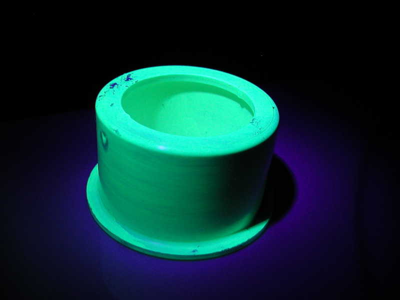

Edit; Added blacklight shot.
