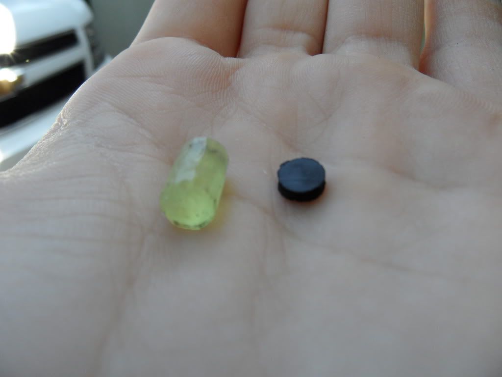

I sharpened a piece of the chamber and punched some neoprene out then put it at the bottom of a section of the chamber pipe. Then I lubed it and put in the epoxy. It is curing right now so I'll take it out tomorrow. Should the epoxy be good enough to hold on the neoprene? It's Loctite 5 minute epoxy.

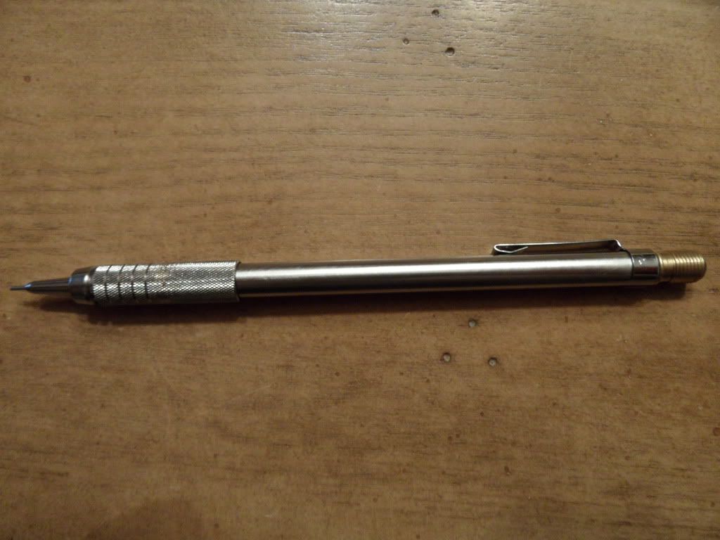

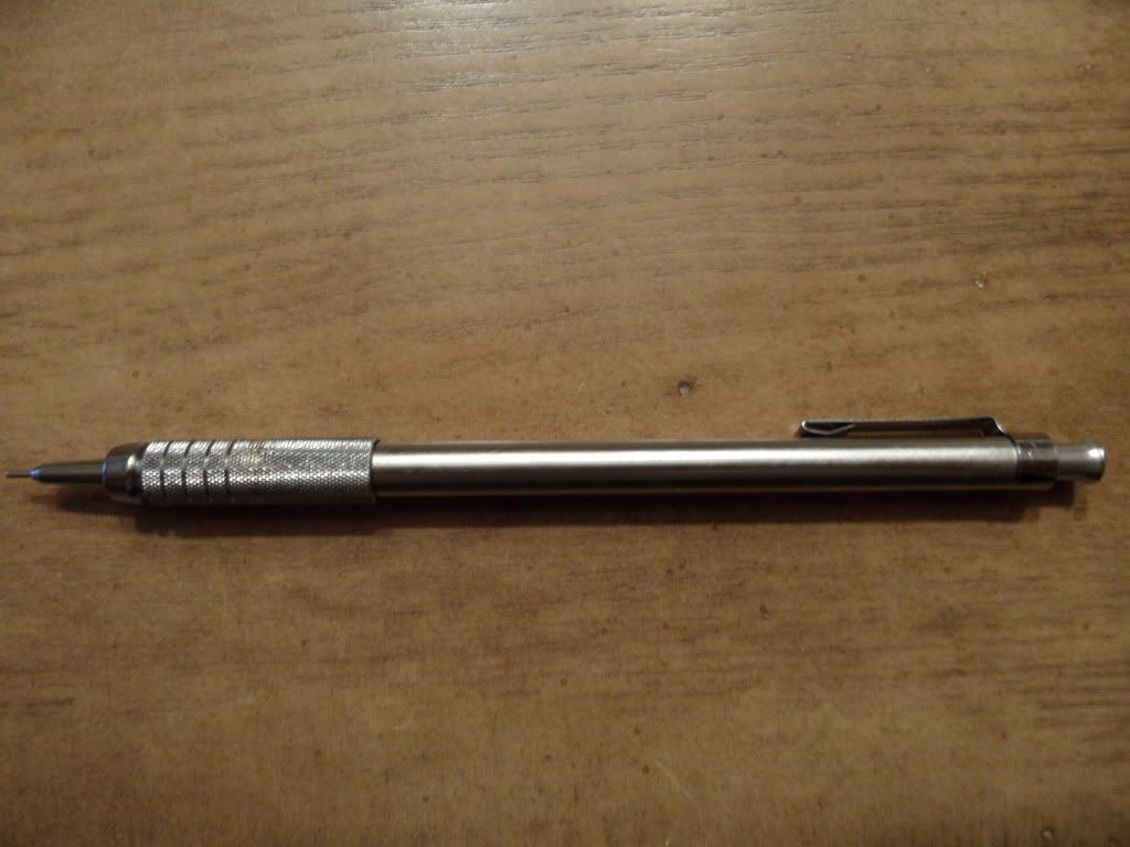

Pick the first one or the second one:
The schrader can be hidden or not. Either way, the front part of the pen would need to be removed in order to fire it.

I took the piston out of the mold today, it was tough but it came out. The rubber on the face came off. The epoxy was not enough to keep it on. A solid rubber piston is in order.

use super glue or rubber cement that you get in tire repair kits to hold rubber down, epoxy just wont stick to rubber
