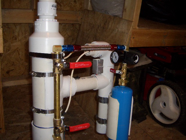

motorfixer1
Posts: 91
Joined: Wed Jul 07, 2010 5:28 pm
Flex PVC .com sells a 3"x2" reducer bell sch 40 p.r. with a 2"x1.5" bushing you would be good to go and safe to boot. I used this exact arrangement on my metered mapp
Mountain Storm
Posts: 47
Joined: Sun Oct 17, 2010 11:48 am
Nice looking cannon there. Thanks for the info.
