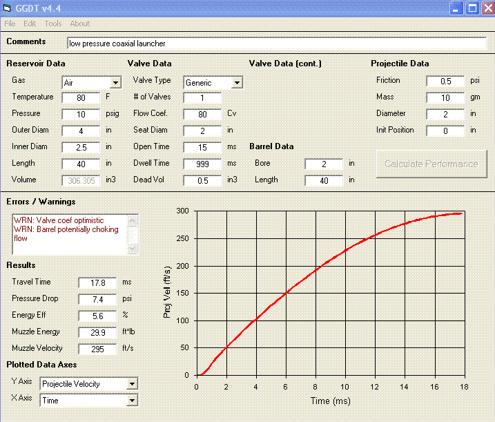

Some quick modelling in GGDT shows that with such a large chamber volume and fast valve, you're really not going to need much pressure for reasonable velocity.
Do you intend to lob this at a high angle trajectory though, or fire it directly? That would significant affect the required velocity for your range target.

- 2inchlowpressurecoaxggdt.GIF (31.7 KiB) Viewed 2409 times
