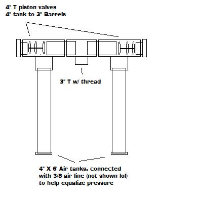

I've made a ton of cannons over the years, from combustion to pneus, ball valves and sprinklers... i had an idea for a twin piston cannon... the goal is to shoot basically anything i desire, from 3" concrete slugs, to 1/2" bearings!
So i submit to you a pile of very bad MS paint sketches... let me kno if this will fly!

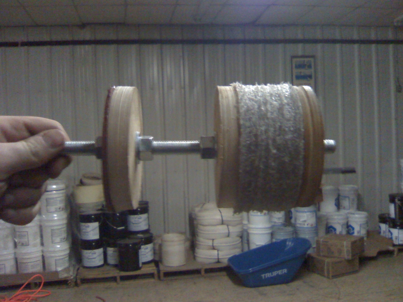

The second is a basic layout of the cannon... twin barrel sealing valves, 4" tank, to 3" barrel... both will be connected to the first sketch... which will fill evenly, and vent at the same time... and the 3rd pic, and idea for a piston... thinking about reinforcing it with steel...

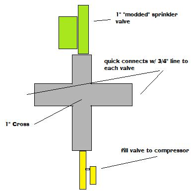

I would recommend a larger pilot valve or and individual pilot on each valve, then link those to a single pilot, maybe 2, 1" valves piloted by another 1" valve (I say this because of the excess volume of pipe connecting the valves).
May help to get more air down the barrel in less time.
so a 1" sprinkler on each valve, T-'ed to the fill line? makes sense, didnt know if i could get away with one... if i'm going overkill, might as well do it right... right!
Like this... green boxes are sprinkler valves, pink lines are Fill lines, then just hook the two sprinkler vaves to the same vent line

Precisely
A 1" valve should pilot both no problem.

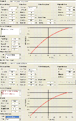

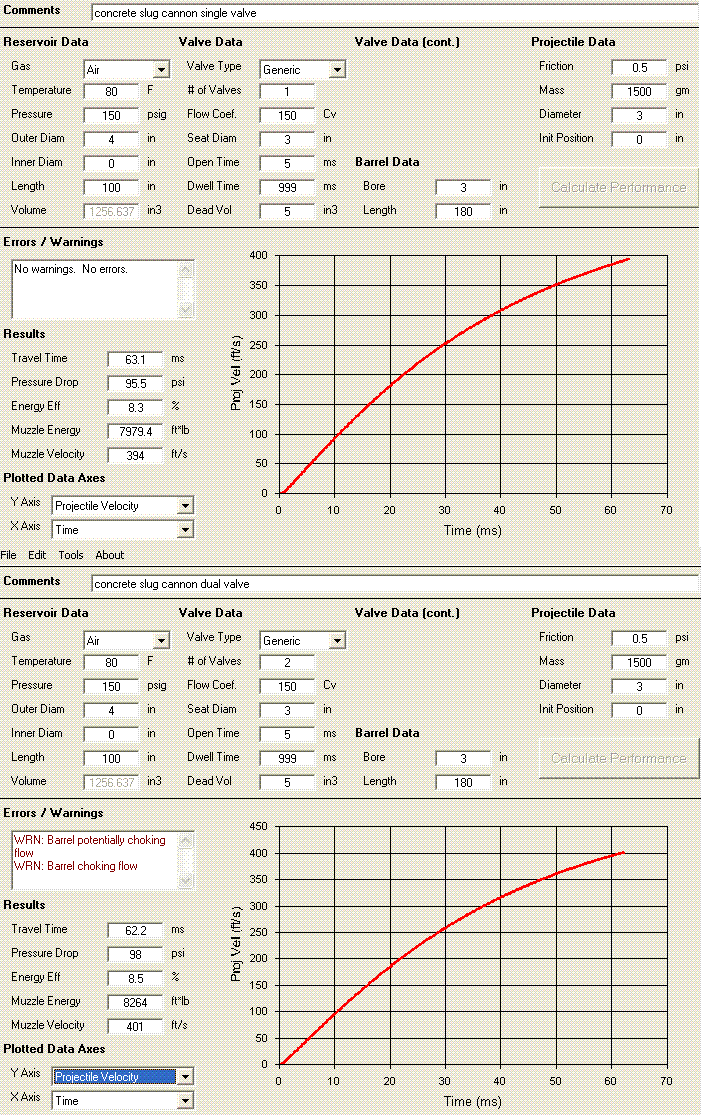

This is the theory.Sancho wrote:i know about burst discs, and never felt like they were something i would want in my projects.... is the restrictor similar?
If you'll be using a 3" concrete slug however, as it's so heavy it will give the valve plenty of time to open fully before it starts moving. The benefit of dual valves on a short barrelled launcher with a light projectile would be visible, but in this case I'm sure it would hardly be worth the effort. Here's some GGDT modelling to illustrate the point, there is a performance gain for dual valves but it's not exactly doubling the power...
jackssmirkingrevenge wrote:GGDT modelling
dude.... never has a chart like that, made me so happy lol
