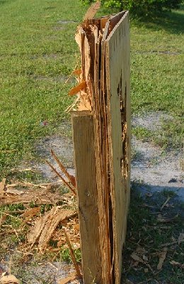

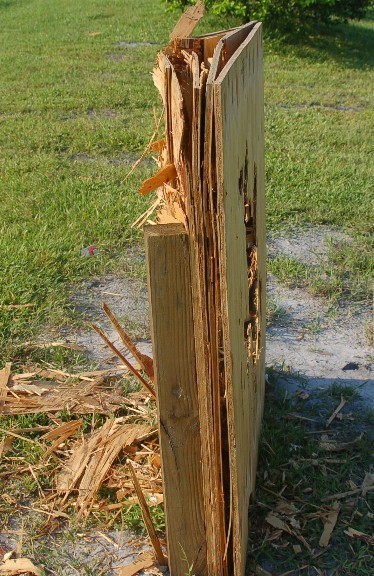

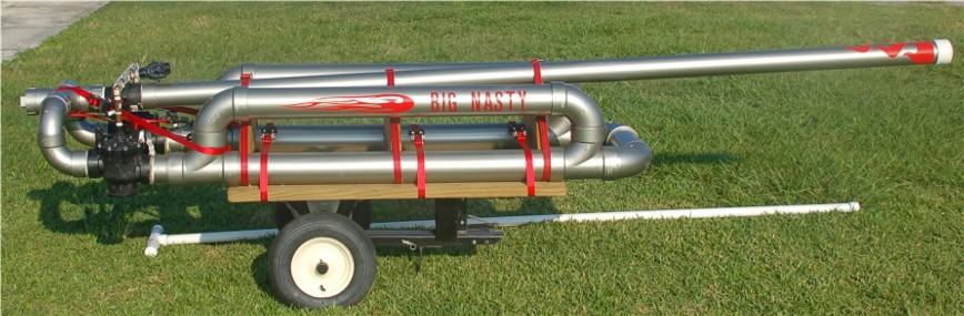

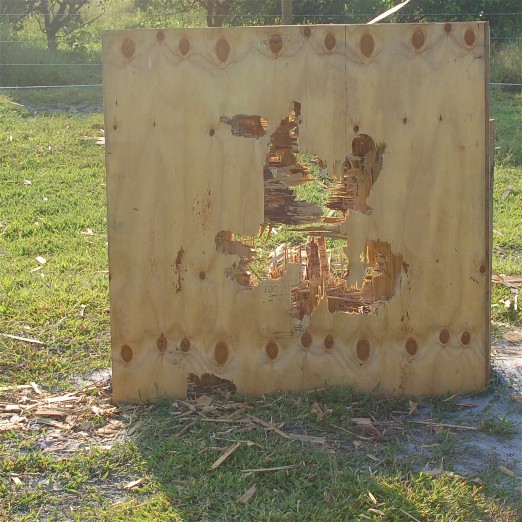

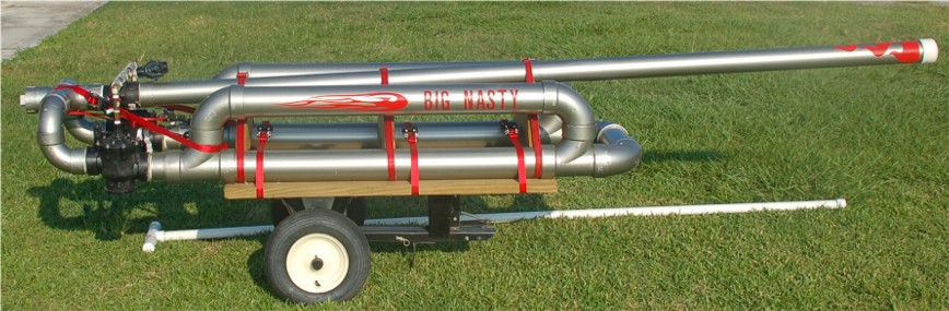

I built a pneumatic cannon I call "BIG NASTY".It's about 12' long,the barrel is 10' long 3" sch40 pvc.It can shoot 20 oz coke bottles frozen about 500 yards.At 20 yards it can shoot a frozen or thawed coke bottle on its side through 3 sheets of 5/8" plywood.At 10 yards it can shoot a 20 oz coke bottle on its side through 4 sheets of 5/8" plywood. I used 3" irrigation valves and 3072 cubic inches of air at 120 psi.

DWV DWV DWV who cares? I do casue I dont him to kill himself! Yea the cannon is super cool and it is powerfull as hell. but it is still DWV. and the paint job is sweet too.noname wrote:Who cares? It's still a fricken beast with a good paintjob.
All you dickheads shut up. You were an ass to him before he put up pictures, and after he put up the pictues. He has just posted one of the most powerful guns I have ever seen and you have done nothing but bring him down. I haven't seen anything remotely good from ANY of you. So shut the fuck up. All of you.

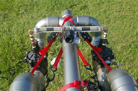

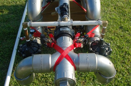

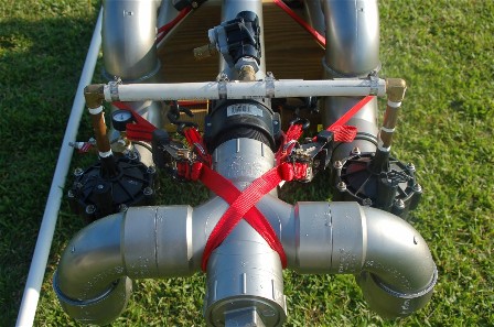

As for Adam, VERY sweet job man. I see you went as far as using cam locks and you rigged up a sweet pilot sytem. Great find on those huge valves. Though you did use DWV fittings which aren't intended for this pressure, I assure you that it is fine. I have never had that problem. Just don't use DWV for making piston assemblies.
Once again, incredible job there dude. And welcome to the forums! Very welcome.

those fittings actually makes it look better, makes it look so curvy
appreciate the curves guys

curves are good, especially on girls. but anyway. SWEET CANNON, i love how u took time to paint it and paint it right, and i love the trailer, wheels always help. there are so many red straps and they look friggen awsome with the paint job. nice job man, i give u my approval and i say u is not a noob now.
