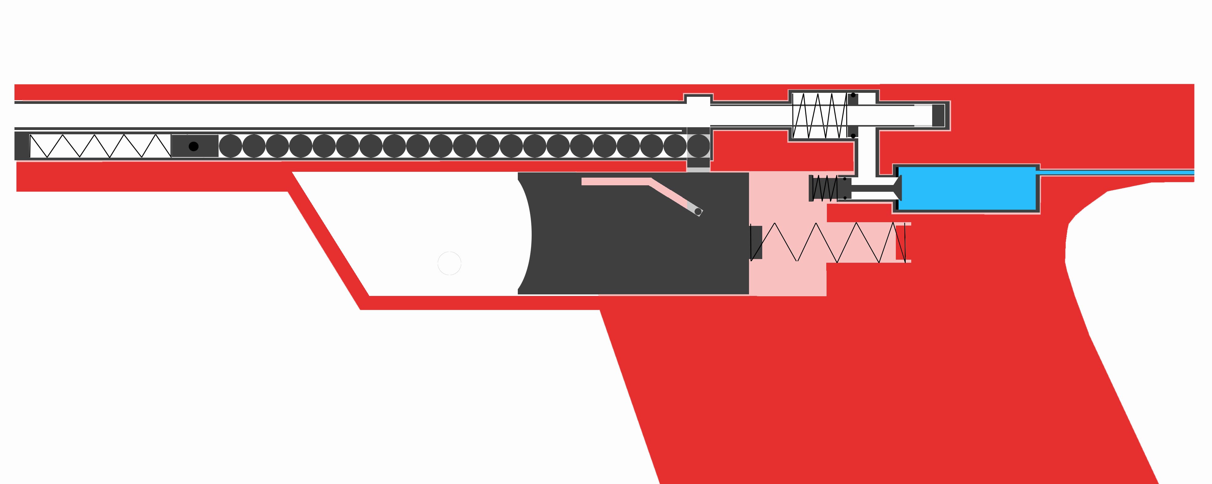

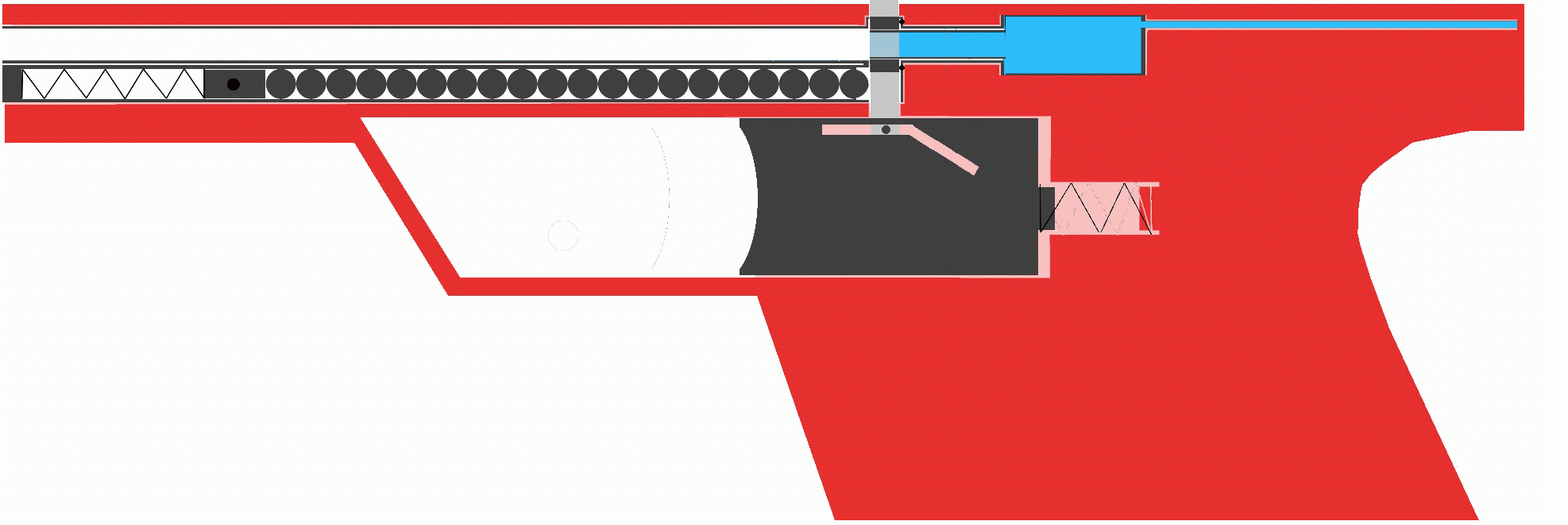

iv always wanted to make a semi and am always trying to think of an idea that i like for when i have the money to make it, this is another one of my ideas that iv had, would use regulated co2 and would be 5mm bore, i think the drawings should be self explanatory if not ask away, what do you guys think?
ilovefire wrote:what do you guys think?
Too complicated :) I like the sliding block idea though :D
ilovefire
Posts: 511
jackssmirkingrevenge wrote: Too complicated :)
must admit it is a bit, can you see it functioning very well IF i did some day decide to make it?
jackssmirkingrevenge wrote: I like the sliding block idea though :D
personally i dont know if i see that working very smoothly or without any leaks, but i could be wrong, wouldnt be the first time :roll:
ilovefire wrote:must admit it is a bit, can you see it functioning very well IF i did some day decide to make it?
It would probably work, but I don't see the point of having a sliding block and a blow forward bolt, either will suffice on its own.
In this case you're right, one of the reasons I never made anything similar.

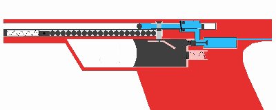

jackssmirkingrevenge wrote:It would probably work, but I don't see the point of having a sliding block and a blow forward bolt, either will suffice on its own.
how could i have it so that i can have a horizontal mag with just the blow forward bolt?
ilovefire wrote:how could i have it so that i can have a horizontal mag with just the blow forward bolt?
er...
ilovefire
Posts: 511

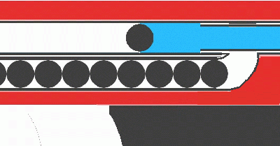

yea i guess that was a bit of a stupid question, and this might be to but how would you stop the bbs falling out the barrel and double feeds and and that stuff...
ilovefire wrote:how would you stop the bbs falling out the barrel and double feeds and and that stuff...
detent?
ilovefire
Posts: 511
now your just making me sound stupid :( what i actually want to know is which sort of detent would i use that wouldnt f**k with or get f**ked by the blow forward bolt? at the sam time as allowing the blot to travel far enough forwards that it would seal the mag, O-ring detent is probably out of the question because i dont tend to make things very serviceable and i dont want anything that would add to much bulk or strange looking things to the gun (i like aesthetics just as much as i like power and consistency) thats also why im not sure about a ball detent because then i would have to have this thing sticking out the top or side of the gun and i dont really like that, not really sure what other detents i could use unless i just use a strong magnet which would then limit it to steel bbs, you get my drift?
Crna Legija
Posts: 2333
Location: australia
well if you make the bolt just big enough to hit a oring and use the same oring as your detent and it would seal air from the mag and stop rolling out issue
Agreed with -_- above.

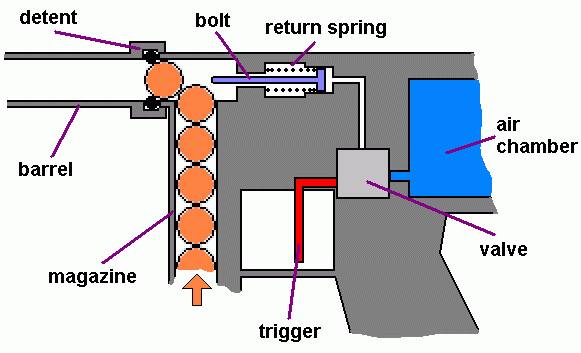

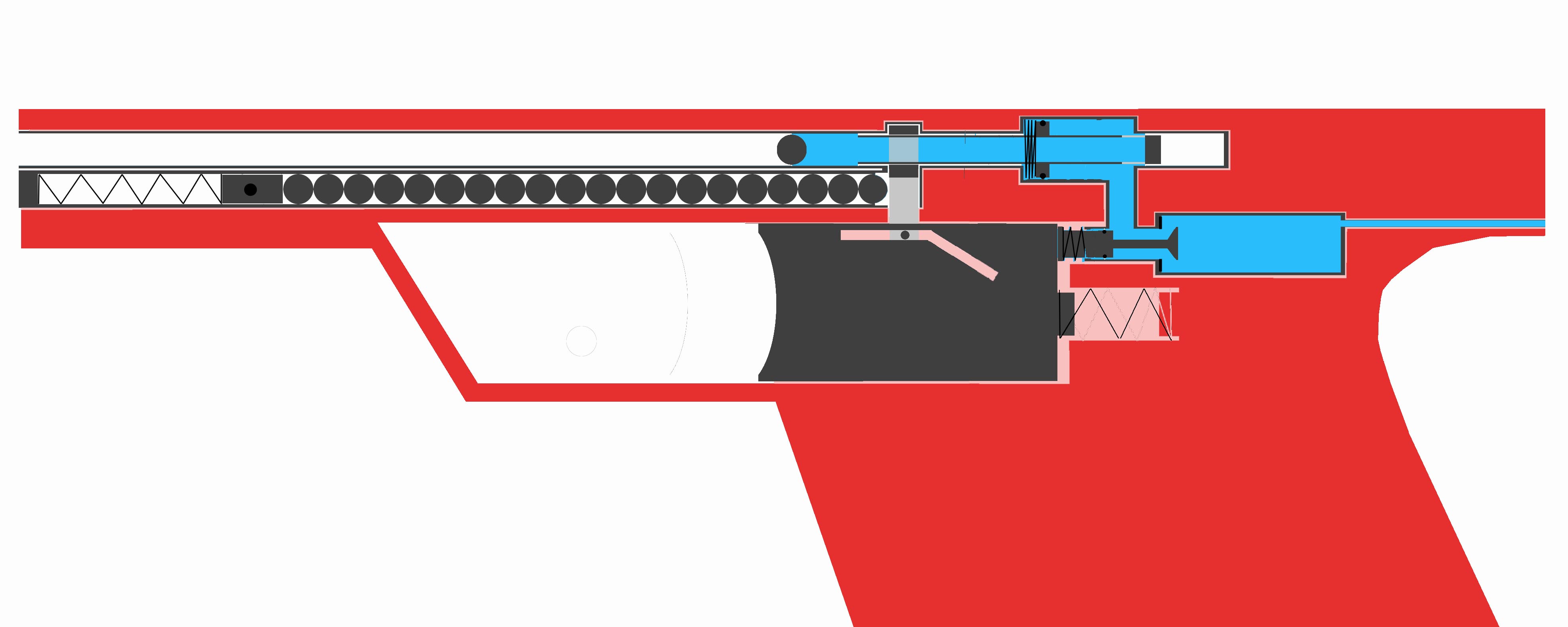

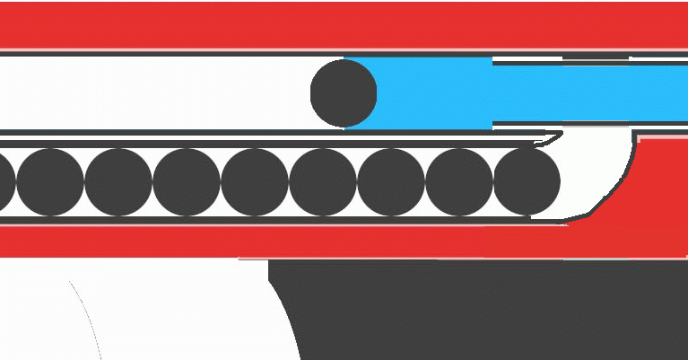

On a slightly different note, I always wanted to combine the blow-forward bolt with the "valveless" design for reliable (one shot per trigger pull) semi-auto, in my head it looks something like this:

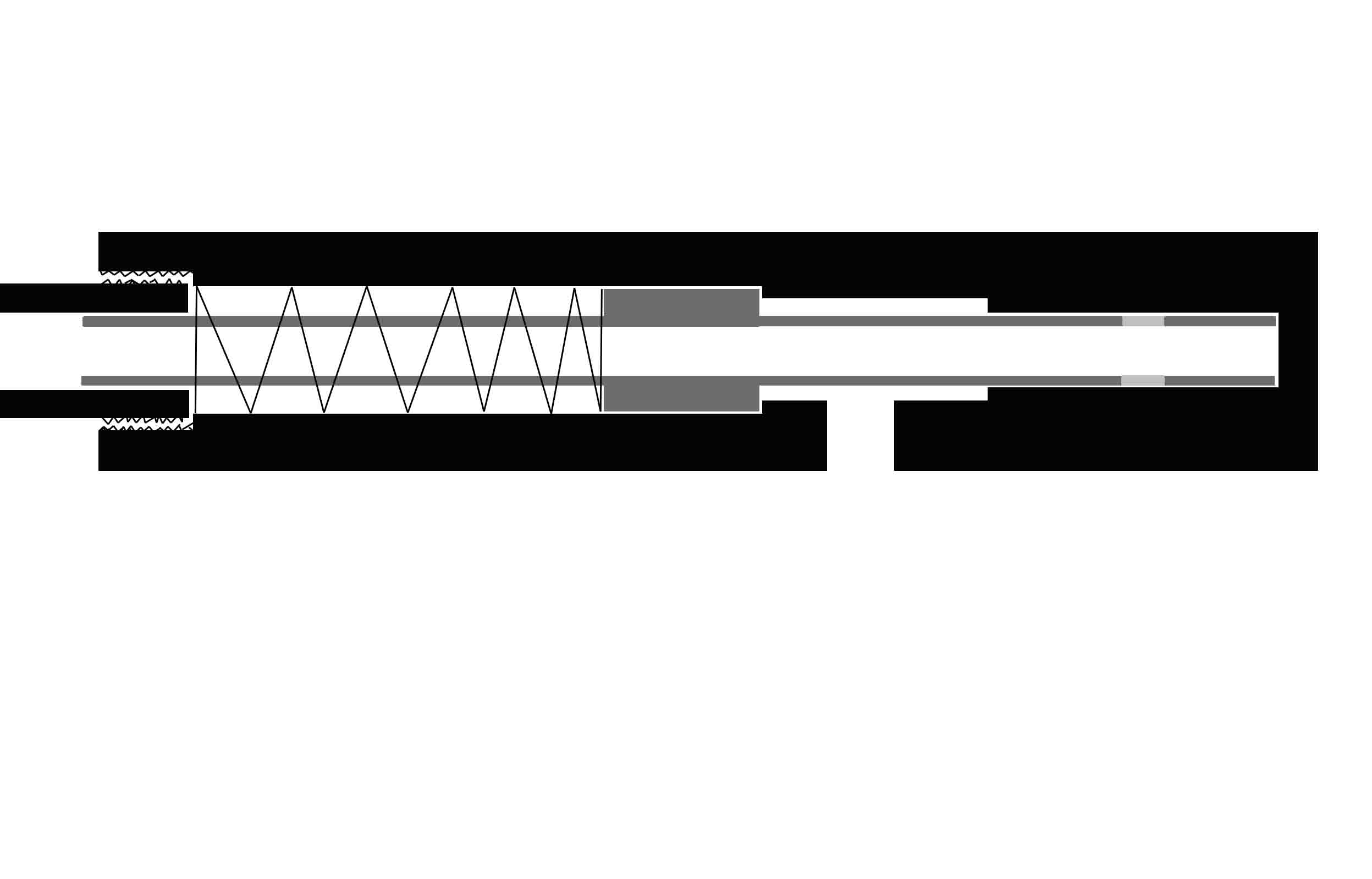

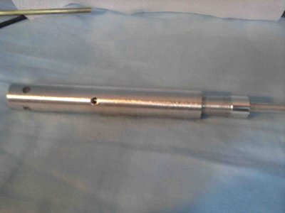

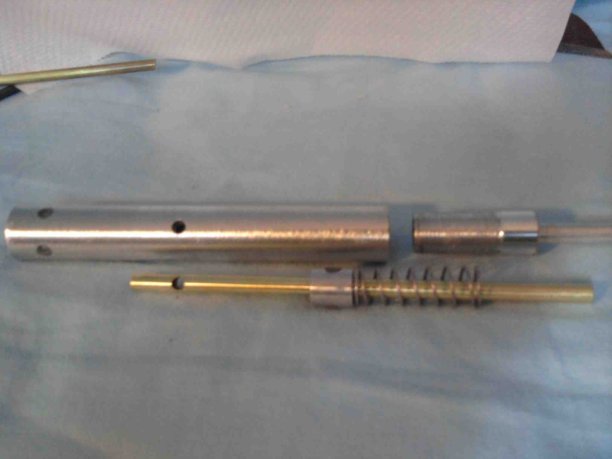

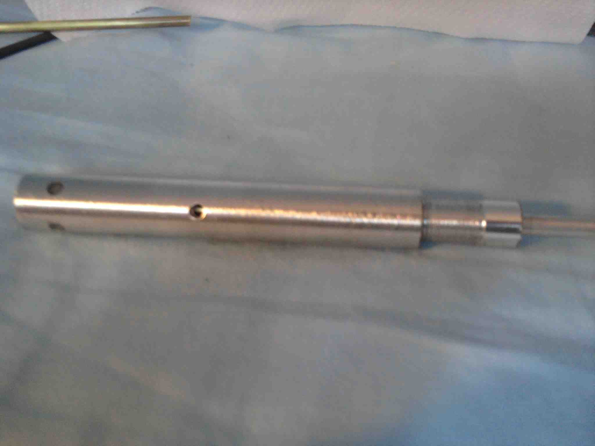

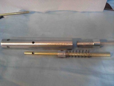

i made the blow forward bolt today did a little bit of testing and with 90psi from the compresor it was more like full-auto until the bolt broke a little bit probably because i didn't let it set long enough, any way got a couple of pics
Did it cycle like mad or not work at all?
That's the effect I had here, slightly different design but same concept.
Beautifully made by the way :)
