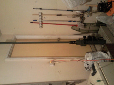

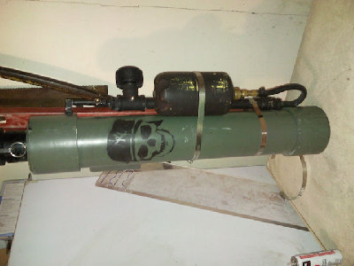

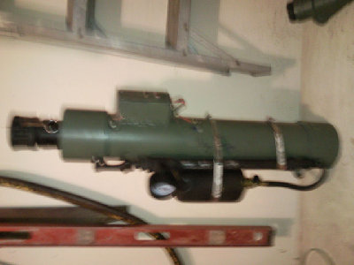

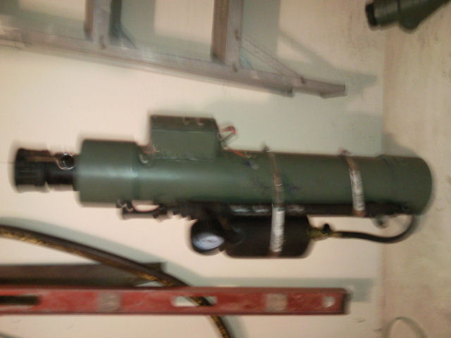

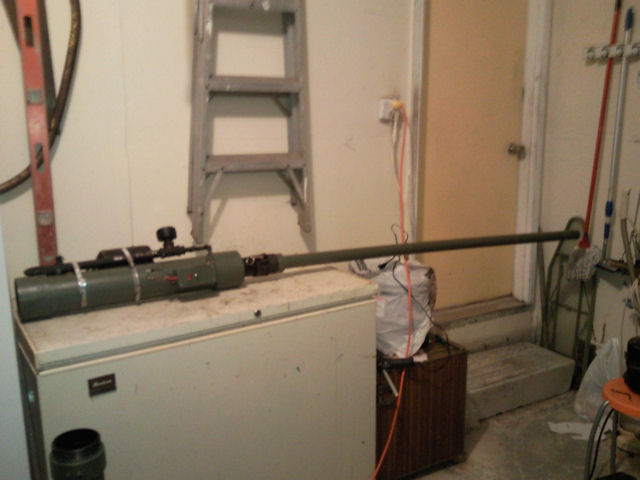

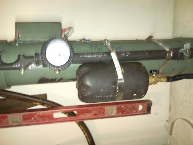

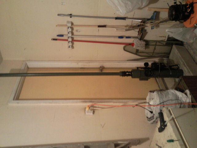

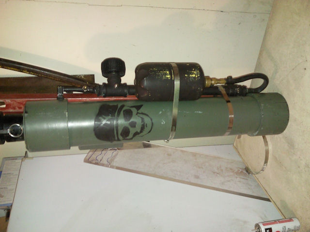

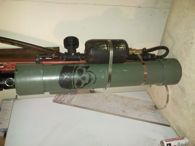

Hey everybody, this is my new cannon. Im still deciding on a name though.
The Specs are.
The chamber. 4 inch diameter, solid core abs. 24" long.
Fuel meter, 3/4" glv pipe 12" long. one ball valve and one blowgun valve.
modified blowtorch nozzle with hose barb. and 600 psi gauge. injected with mapp gas.

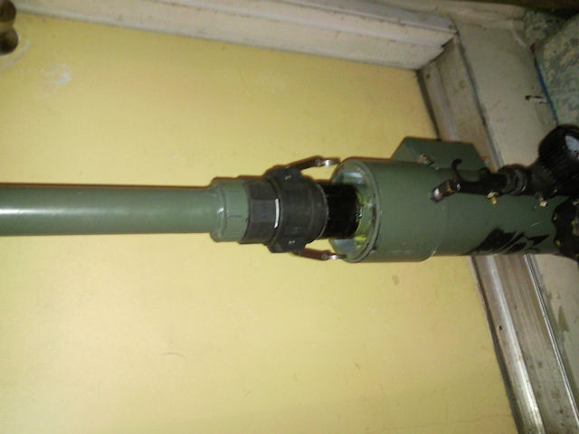

barrel. 6' of 1 1/2" abs pipe with cam fittings.

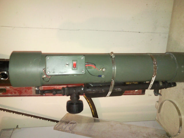

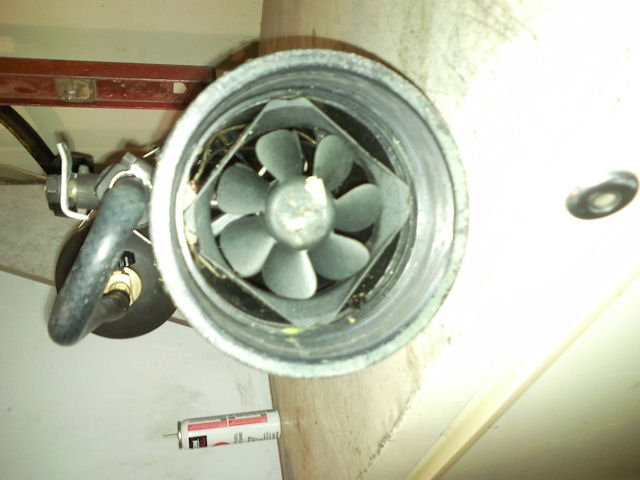

has interal fan with reachable battery. and a electronic spark ignition.
my second cannon

Nice. Thats pretty awesome. Can I see a shooting video or something?

That sounds reasonable on this beast! Nice job!!! :thumbright:vblock wrote:not shure. i think it should about 300 yards maby?

Nice, I like it!! It seems you already named it, but I was thinking "The mean green spudding machine, lol!!!"
