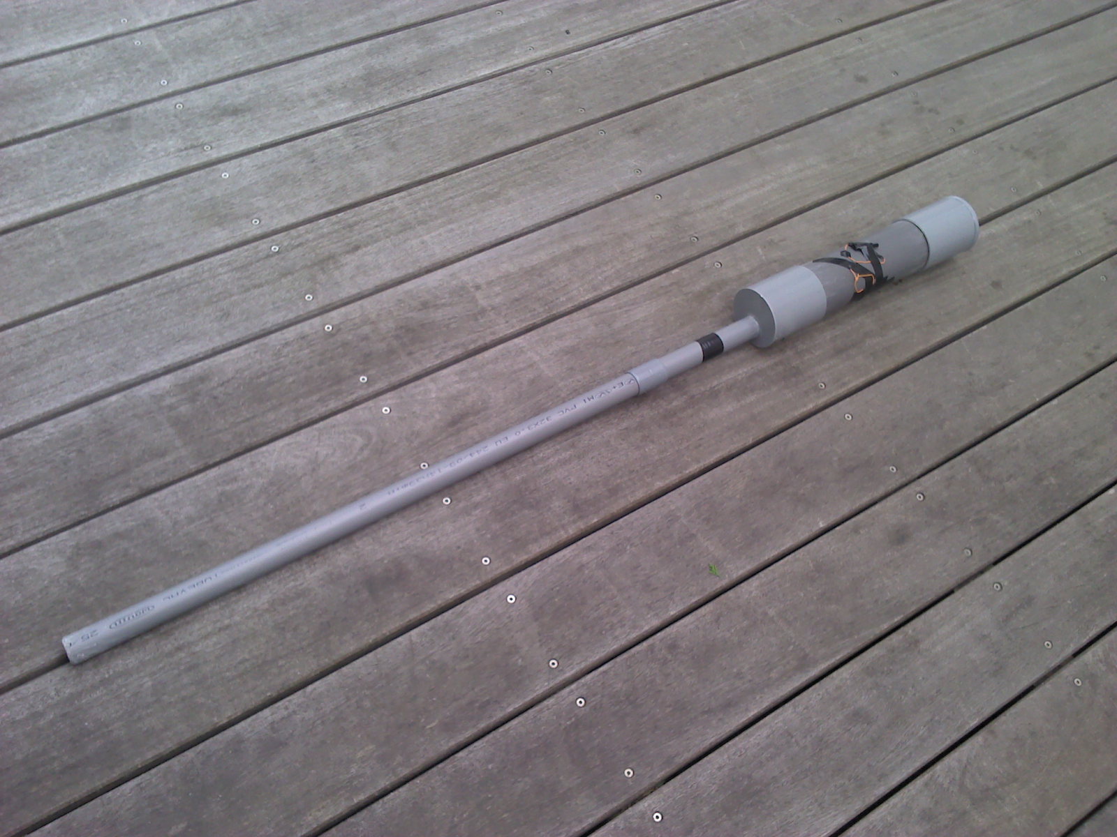

HI, I just made a combustion type spud gun with a piece of 80mm PVC (combustion chamber) and a long piece of 32 mm PVC(barrel). I use a piezoelectric sparker to which I attached 2 wires that go into the combustion chamber. I use deodorant as a propellant.
First I put the potato in, then I put the deodorant in, and I spray for about 2 seconds. I have to spark like 15 times before it launches the potato. When it does, it makes a huge BOOM that kills my ears and the potato goes flying out, as well as the end cap on the other side....
Could somebody please help? :o
Has thanked: 581 times
da007man wrote:I spray for about 2 seconds. I have to spark like 15 times before it launches the potato.
Spray less.
Even better, use a syringe ;)

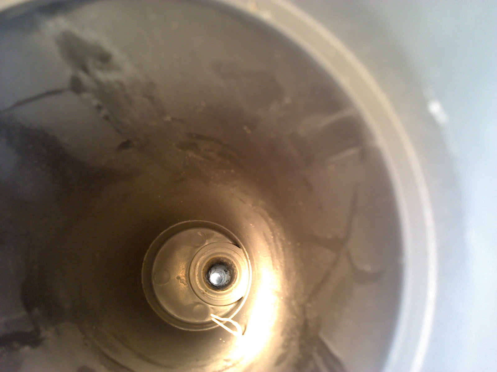

Also, try making your spark gap bigger, say around 5-6mm
da007man
Posts: 11
Joined: Sat Apr 23, 2011 3:34 am
If I make the spark gap bigger it doesn't spark... Is that normal because it is a small sparker or is it just me?
It looks fairly small in the picture, but it could just be the picture.
The problem then is probably too much fuel, try spraying less.
da007man
Posts: 11
Well the space is really small, about 3mm maximum. I'll try spraying less next time. However, I need to change the end cap, because the one I have screws on easily, it's a lock kind (screw to the right once and it will go click). I will get a better one this afternoon and see whether it will fly off or not.

First things first, your endcap shouldn't fly off when firing. Are you using a threaded endcap? Because I don't see threads in that picture showing your spark gap.
As to the spark gap, I would recommend a distance of around 1/8" between the electrodes.

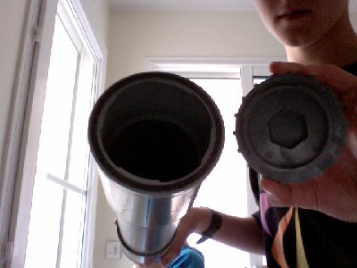

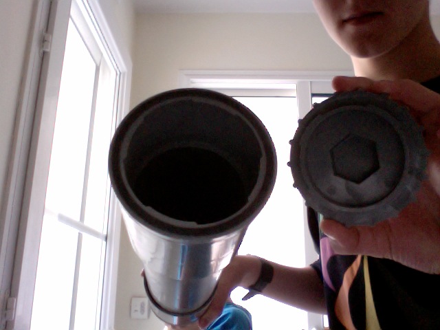

OK thanks you guys. I have tested with less fuel and the potato has launched about every first spark. It already goes really far with the cap flying off. I did however try duct taping it to see if that would hold it in place... For now it works, but I'm afraid it won't last long....
Here's a picture of the end cap part.
Posts: 3643
Been thanked: 62 times
Yeah, that's pretty flimsy looking.
If you can't find a threaded cleanout cap, you may have to use the bottle cap idea your posted before. If you do, it would be a very good idea to install a chamber fan as well to aid in venting the chamber.
Another thing is, if you can find a smaller cleanout cap and spigot x FNPT adapter (female threads on one end and a small piece of "pipe" on the other), you could theoretically drill through the permanent endcap (before installing) with a hole saw the same size as the "pipe" on the adapter, push the adapter through, and then glue a slice of coupling on the other end of the cap.
None of this is the way the pipe and fittings were intended to be joined, though, so it would be much safer and better if you were to find a normal threaded cleanout cap and adapter.

Yeah i'll do that. I think I'll still use the coke bottle cap to insert the fuel with a syringe 'cause the hole is smaller than the end cap so less fuel will be lost.
