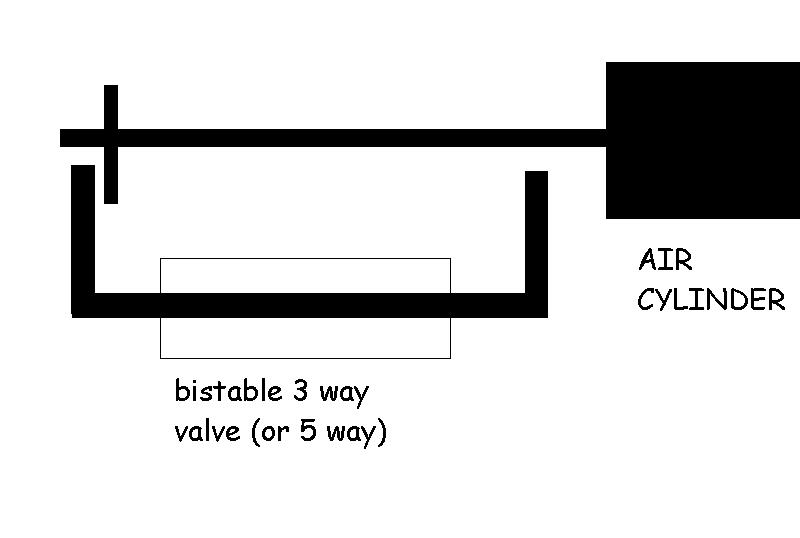

Finally an other thing that I reckon hasn't been tried enough, is mechanical full automatic fire using a 3-way valve using the air ram for synchronisation.

@al-xg
You mean like this one ?
