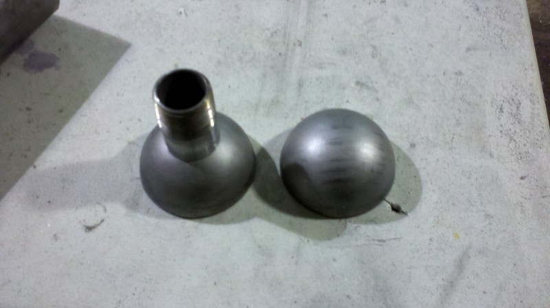

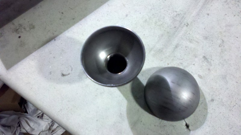

Hey guys,

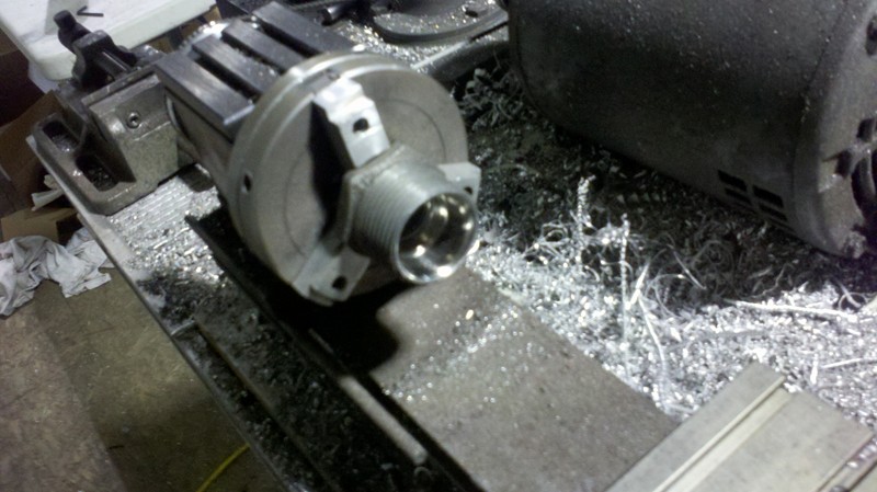

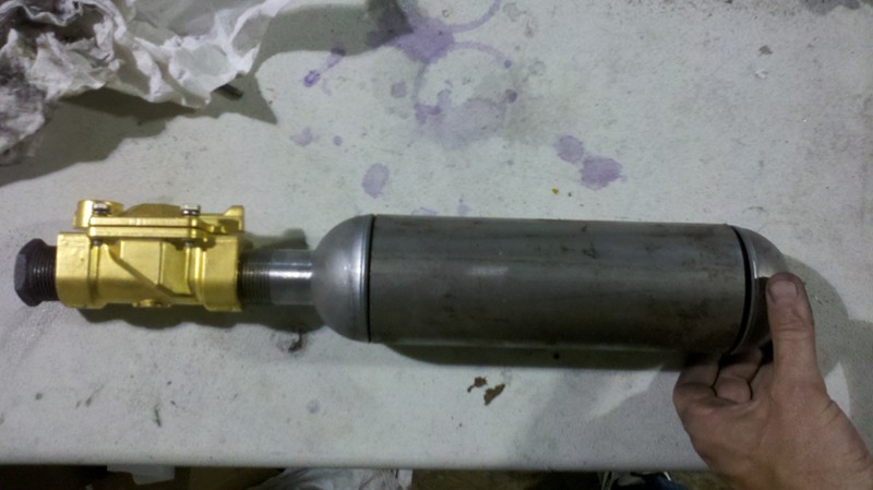

Here are some preliminary pics of a 1/2 inch bore (.600") cannon. The tank is made of 3 inch ID 1/8 inch wall DOM high tensile steel pipe with 1/8 inch steel hemispheres MIG welded to the ends. You can see the one hemisphere has been machined on the lathe along with the pipe nipple to form a good tight seam. That will make the inside transition easier to smooth out once welding is done. It also assures a good straight tank to valve assembly.
The valve is a 1 inch ID Granzow diaphram valve with a CV of 12. It will be piloted by a small trigger valve (I will show that later).

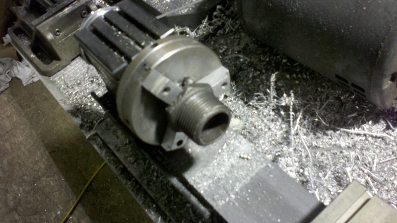

You can see the 1 inch to 1/2 inch reducer that I ported and polished. That was accomplished by spinning it in the lathe and using the old trusty Dremel with various wheels to achieve a very slick surface. The front of the inside of the tank will get the same treatment as will the inside of the valve to remove any flashing and smooth flow.
This gun will run 300 psi (310 psi is the limit of my compressor). I will make my own slugs out of Delrin and a few out of steel.

That fitting is a basic black steel reducer. I merely ported and polished it.
