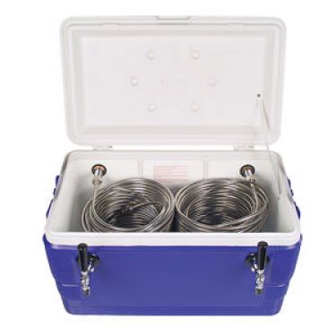

For beverages that may be acidic, a stainless steel heat exchanger is recommended. This heat exchanger is commonly used in portable soda dispensers.
http://www.beveragefactory.com/draftbee ... xes.shtml.
