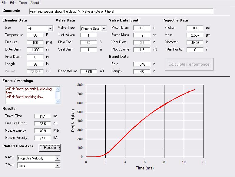

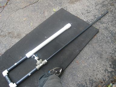

This isn't my first attempt at a pneumatic launcher but my first one was only half as powerful. The chamber is 24'' long 1.5'' schedule 40 PVC, the barrel is 1/2'' schedule 80 sold as 48'' risers for spigots at Lowe's, and a quick disconnect in a pressure rated cap on the end. The valve is a lawn genie with flow control. I removed the flow control knob and used the hole left as my pilot vent. I typically run this gun around 80-90 psi but I have made frequent shots up to 100psi. I used GGDT to get a good estimate on power. It says that, with a marble, I'm shooting upwards of 747fps. Any feedback?

Did you calculate the dead volume in your pneumatic?
Alster370 wrote:Did you calculate the dead volume in your pneumatic?
Dead volume and valve characteristics seem GGDT default so the result isn't as accurate as it could be.
Had a play myself, still a good result ;)

I did the best measurements that I could. I'm not 100% certain but that actually seems about correct. The valve is a 1'' Lawn Genie. It was the only one I could get. If anyone knows the actual specs of this valve it would help greatly.

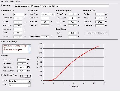

jackssmirkingrevenge wrote:Dead volume and valve characteristics seem GGDT default so the result isn't as accurate as it could be.
I actually went and did some measuring and the default dead volume seems to be accurate so i left it. the flow coefficient was in percent on my go. I went on the low end at 30% which I got from searching the forums. I actually used my camera as a makeshift chronograph by counting frames at 60 frames/sec. I calculated the projectile speed with the precise distance at 24'. I calculated between 750 and 800 fps to leave some room for error. It happened to be just over 3 and a half frames. I had to play with it a little to get reasonable results.

I just noticed you had originally modelled it on a piston valve, which would explain the unusually high results. The gun itself is very good, clean too. A piston valve could be your next upgrade. You will definitely notice an improvement in performance.

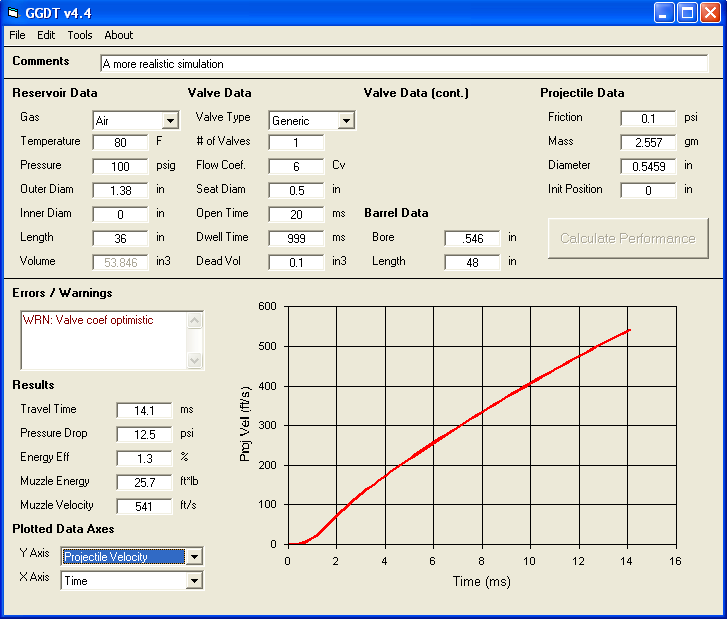

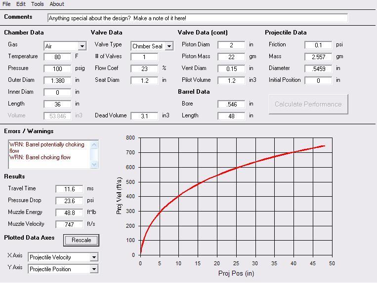

I recently went to the GGDT page and found the specs that are supposed to closely resemble the 1'' sprinkler valve. I input these and got the same result as previously BEFORE I found these specs. Also, this IS with a very light glass marble as ammo. I recalculated the shot with a AA battery at 302fps which seems VERY accurate. I can watch the battery in flight across my backyard(it's a very large yard)
This is with adjusted specifications compared with the original ones I had in old tests.
