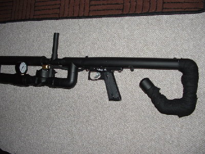

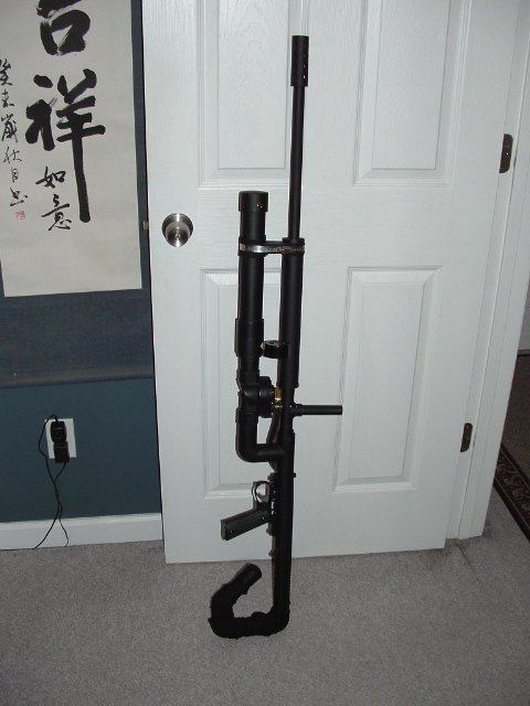

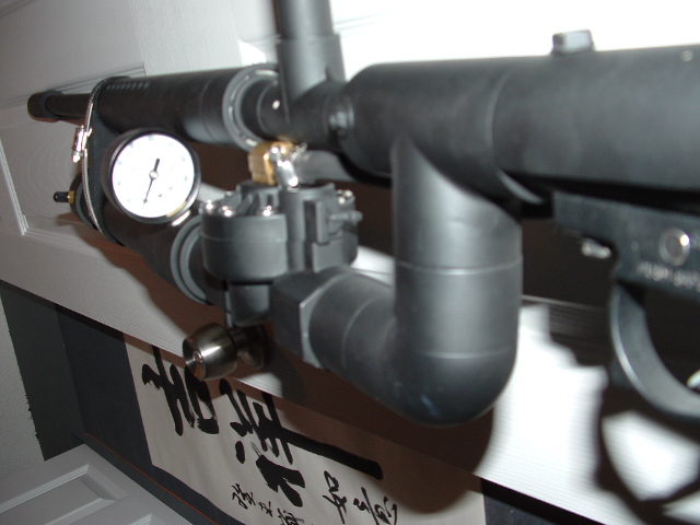

Cannon Name-Minus's Sniper
Type of Cannon- Pnuematic
Chamber Size- 15" x 1-1/2" pvc (26.5CI)
Barrel Size- 30" x 3/4" cpvc (13.25CI)
Gas Source- 150 psi air compressor

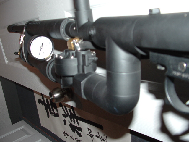

Valve- Pnuematically actuated 1" sprinkler valve
Ammunition- Paintballs and Marbles
Other Details- Took design cues from the Barrett M107. Decorative muzzle break and barrel shroud, Breech loading, Pistol trigger, Flat black paint job. This was my first gun, and definitely won't be the last. The best part is having your boss ask when it's going to be finished so he can shoot it!! Oh, and marbles blowing up spray paint cans is so much fun!!!

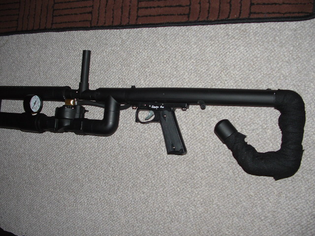

I envy you.
Also haow did you get that handle?
What is that stick on the top? breech loaded?

niiiiice! how did u use a paintball gun handle for this?

b-e-a-utiful gun

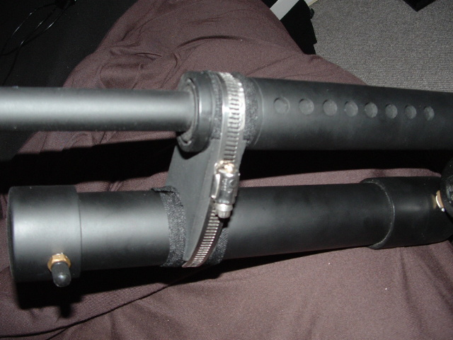

wow...thanks for all the comments. The handle is from an old Spyder One pb gun I had from years ago. The "stick" on top is the breech loader. Think I'm gonna shorten it a little though...make it less obtrusive. The trigger actually pushes open the blow gun that actuates the sprinkler valve. The blow gun is actually inside the stock right above the trigger. Shortly after the trigger, there is an "exhaust hose" coming out of the stock for the blow gun to vent.

I love it! That thing is big and beautiful. Great first gun.

A Damn nice gun indeed. The sad thing is your first one kicks all my guns butts in looks. I think thats one of the nicest cannons on the forums lately.
SOO CUTE!! OMG!! I COULD JUST LICK YOU!!Insomniac wrote:Hey why am I a goose???? Why not somthing a little more awe inspireing, like an eagle or something? LOL
Yeah, I want to enter it, but not sure how exactly. I've read the contest info. Any help??? Oh, and the next will probably be a tennis ball, golf ball, or bouncy ball launcher. Might even make my own piston valve instead of a sprinkler valve.
