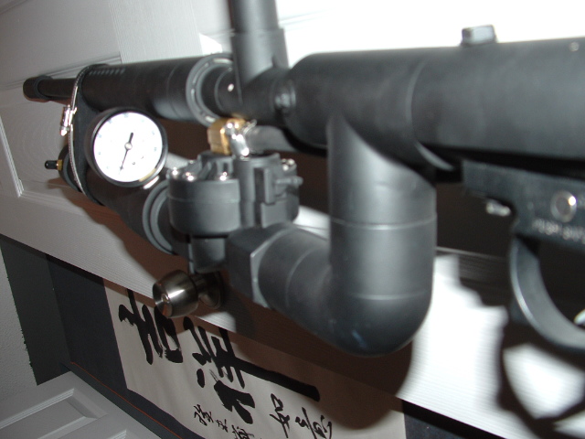

The sprinkler valve, and air pressure gauge (don't want the chamber blowing up in my face...)

wow...thanks for all the comments. The handle is from an old Spyder One pb gun I had from years ago. The "stick" on top is the breech loader. Think I'm gonna shorten it a little though...make it less obtrusive. The trigger actually pushes open the blow gun that actuates the sprinkler valve. The blow gun is actually inside the stock right above the trigger. Shortly after the trigger, there is an "exhaust hose" coming out of the stock for the blow gun to vent.
