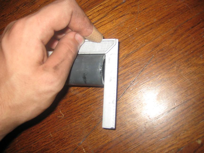

It wasn't at first, I had to re-cut the end of the pipe. I'll have pictures in about ten minutes. It's not visible to the naked eye whether or not its perfectly perpendicular.

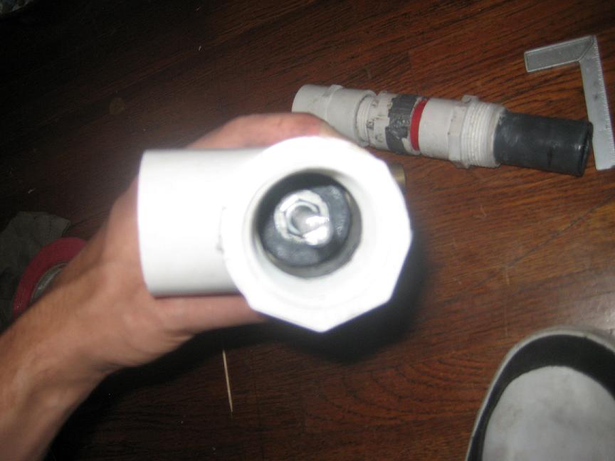

Epoxy the bolt/nut and washer on the sealing face. Make sure to get epoxy in the nut threads, between sealing face and washer and between washer and nut. You may also want to put a washer behind the sealing face for support, epoxy that to the sealing face too. Pretty much epoxy everything except the sealing face area that needs to seal
I'm sure that will solve your problems.

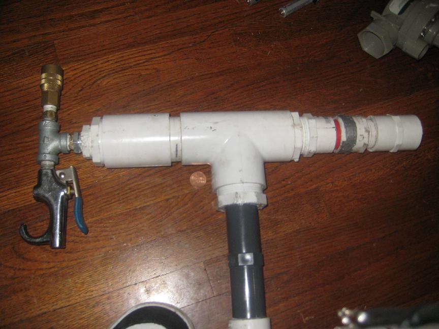

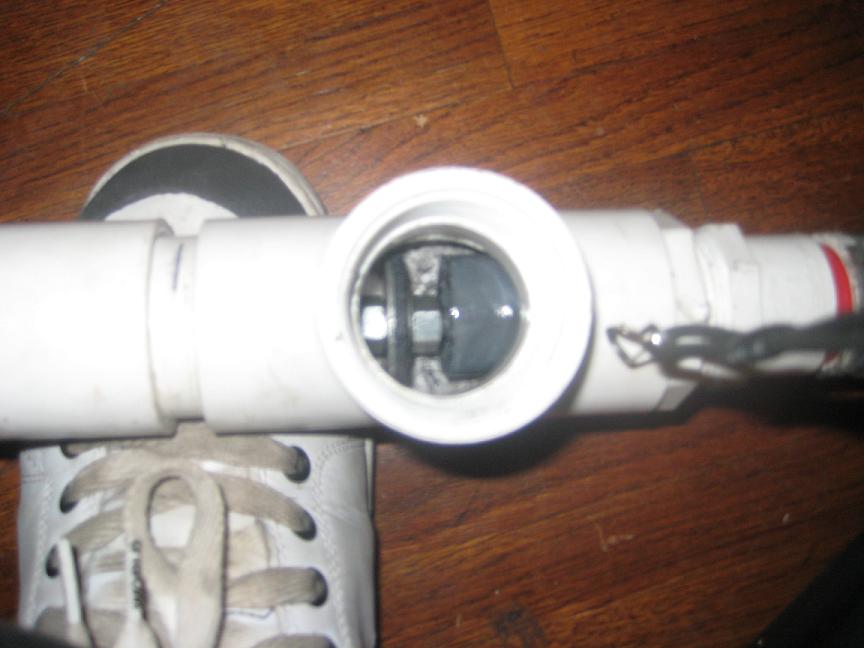

Judging from the photos it all looks fine,
Have you tried moving the sealing face forward closer to the piston?
i recognized that the sealing face is near the half way of the T.
(if you can) try moving it closer and see if it seals.
If that doesn't work,
make sure you identify where exactly the leak is coming from.
You could be mistaken that the 'leak' may be coming from is the piston seal, but in fact the leak may be coming from the connection between the sealing face pipe and the PVC fitting in the last picture on the top right corner.
besides from that everything looks good.....

If you can get it to leak at low pressure (>30PSI), remove the barrel and pour water on the piston face and you'll find the leak.
There could be a leak between washer and nut, even if the rubber is glued to the washer, it could leak past the inside diameter of the washer and out between the washer and nut.

Any time I cut a barrel for a piston valve, I stand the barrel on end on a sheet of plywood that has a piece of sandpaper glued on it. I rotate the barrel while it is standing on end and look for any wobble as it rotates. If I can see any leaning, I use the sandpaper to sand off the high side until the barrel has no wobble as it is rotated standing on end. Once the barrel is true, the face of the piston can be tested against the end of the barrel for a proper fit. With a small amount of valve grinding compound, the piston face and the barrel can be lapped together.
- Mr.Tallahassee
- Posts: 364
- Joined: Sun Jul 10, 2011 2:35 am
That's exactly what I did originally. Took a whole day but it still leaked badly. I finally broke down and adhered rubber to the pipe surface. It worked numerous times last night but wouldn't get past 20psi. Now it won't hold ANY air hardly.
