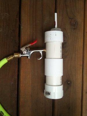

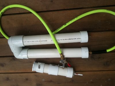

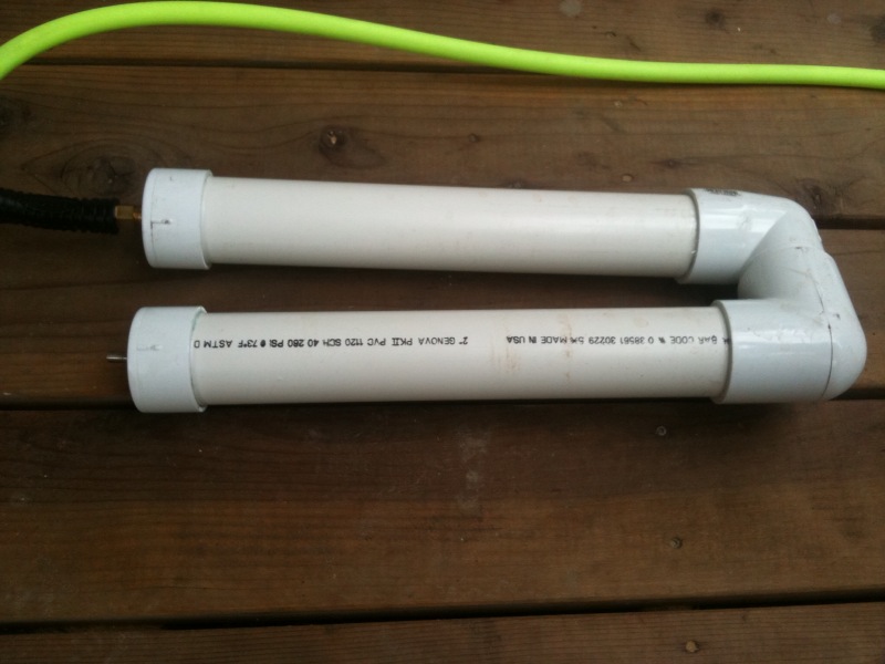

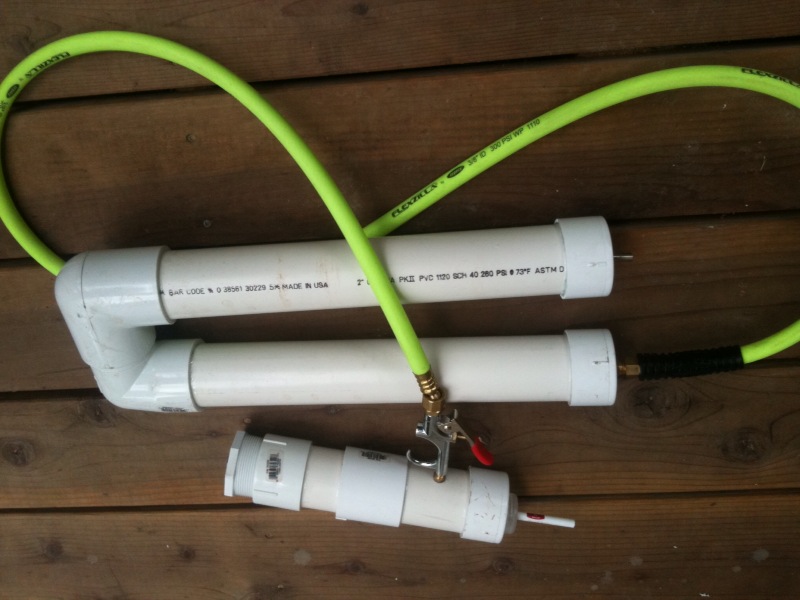

Hey, I've recently been having trouble with my BBMG with regards to getting it to fire. I pump the air chamber I have constructed out of pressure rated PVC pipe up to 120 PSI through a shraeder valve I have installed in one of the end caps of the pressure chamber, but when I pull the trigger of my blow gun valve, I hear air rushing out of the barrel, but no BBs. My device uses a vortex block made out of wood that is inside of 2" diameter pressure rated PVC like my air chamber. The plunger system connects to a threaded adapter on the end of my gun by screwing into it. I have tested my system for leaks but I have found none. What am I doing wrong?

I cannot see how the vortex block works. I really can't help without more details.

Either there is a problem with the block or the bbs are jamming. Try taking the plunger off or loading less bbs. Give it a shake before you fire it.
Remove plunger, try firing in different orientations and shaking.
Add plunger again. If it does not fire, use the weakest spring you can find.
