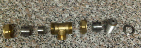

Here is a picture of the Piston valve, just the pressure from blowing into it with my smokers lungs makes it actuate pretty well, still have to finish the hammer valve that will serve as my pilot valve. it is a solid steel piston, I read a lot about pistons being to heavy... im just afraid using plastics or the like will wear out a piston plenty fast, and I'm used to working with metal.. epoxy and plastic just seems a little awkward

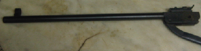

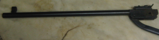

I have another question. I have attached another picture of the barrel I have lying around, I see it's a .177 instead of a .22 unfortunately. It was a nasty 8 bux chinese springer, the barrel is rifled at least and a slight bit more sturdy that a copper pipe. too bad it's only a 177. It's probably a good idea to start on a small plinker as this is my first airgun anyways.
Now another question. this barrel is only 40cm long, is it worth using this at all or should I abandon this and rather go unrifled and longerl? opinions like a-holes I know... but it'd be nice to get a few more than just my own.

A Delrin or Nylon piston would be perfectly adequate, the piston heads on springers are usually made of similar synthetic materials and take a lot of abuse, much more than a pneumatic will suffer.jvw1979 wrote:it is a solid steel piston, I read a lot about pistons being to heavy... im just afraid using plastics or the like will wear out a piston plenty fast, and I'm used to working with metal.. epoxy and plastic just seems a little awkward
At least if you want to stick to metal use aluminium.
With medium to heavy pellets, a fast valve and reasonably high pressure, you will be able to fire at high subsonic speed in the 950 - 1050 feet per second range which would hypothetically be enough to knock a rabbit down at 60 yards.I have another question. I have attached another picture of the barrel I have lying around, I see it's a .177 instead of a .22 unfortunately. It was a nasty 8 bux chinese springer, the barrel is rifled at least and a slight bit more sturdy that a copper pipe. too bad it's only a 177. It's probably a good idea to start on a small plinker as this is my first airgun anyways.
Again, you will still get good performance using high pressure and a fast valve, it's worth the extra benefit of accuracy to use the rifled barrel.Now another question. this barrel is only 40cm long, is it worth using this at all or should I abandon this and rather go unrifled and longerl? opinions like a-holes I know... but it'd be nice to get a few more than just my own.
