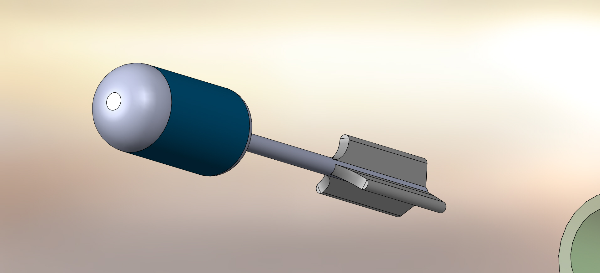

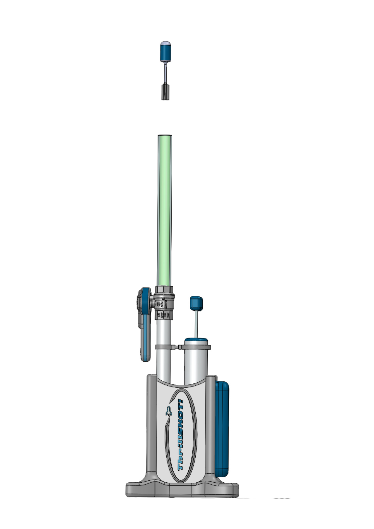

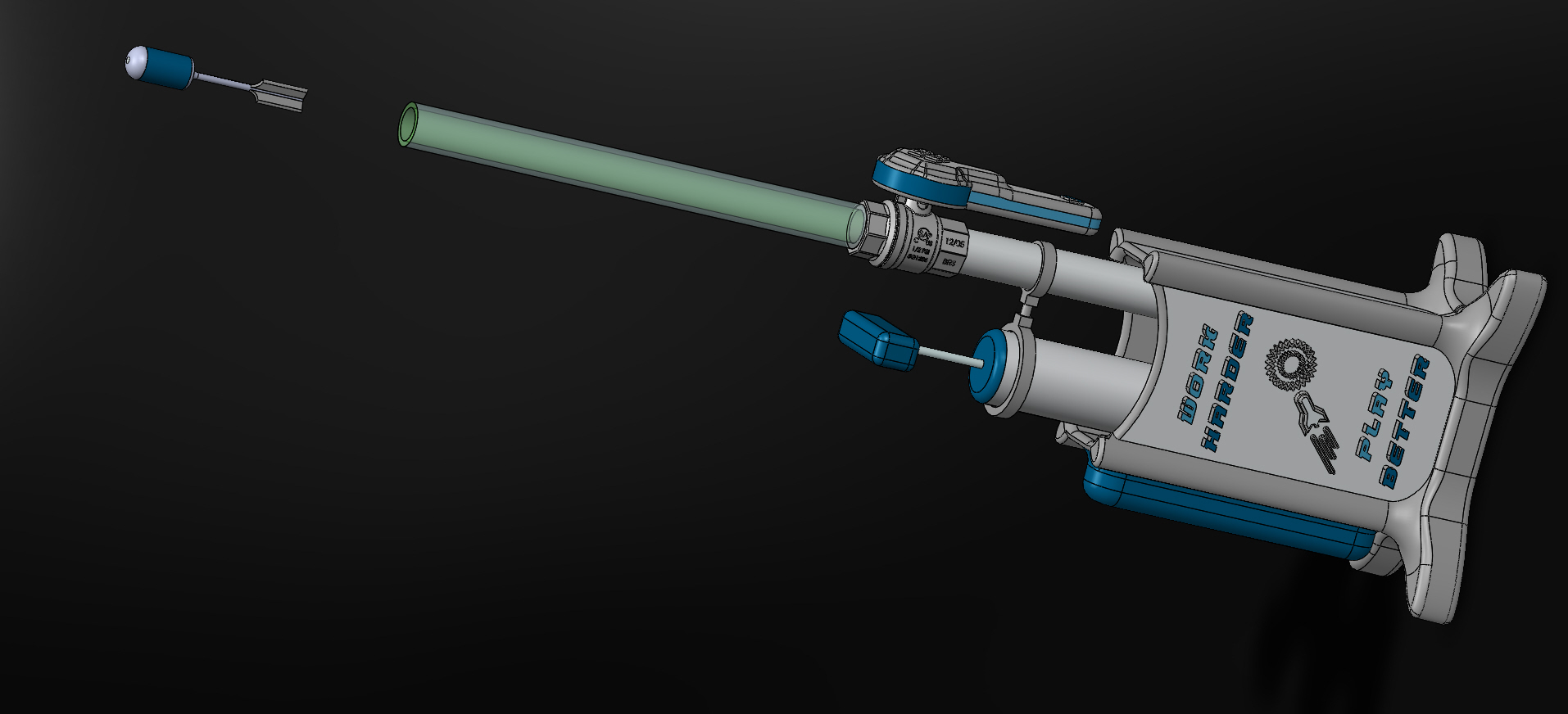

The launcher needs to be pumped before each shot. We're taking a different approach and are pursuing an exercise-based and physically active form of powering the device (instead of semi-auto/or pre-filled tanks). We're marketing the device to 12-22 year olds and, in today's society where over 1/3 of children and adolescents are considered obese, we feel the exercise in pumping is beneficial.
Manually pumping provides another benefit: the user can tailor the pressure and power of the shot in order to strike targets downrange. Our launcher games are strategy-based and users must achieve the right combination of pressure power and tilt of the air gun to successfully blast targets.
Attached are a few photos. Would love the community's feedback and will continue to describe the specifics of the device if interested.

Well we can all see it uses a ball valve and a very basic design, which isn't necessarily a bad thing. You could use a piston valve instead, which will give better power, but also increase complexity.

Same here - is it automated in any way? The problem is that if it is manually activated, every kid will have a different result, so they cannot correlate number of pumps to performance.POLAND_SPUD wrote:Well we can all see it uses a ball valve and a very basic design, which isn't necessarily a bad thing. You could use a piston valve instead, which will give better power, but also increase complexity.
Did you include a pressure limiting device to stop idiots trying to over-pump? Or is the stirrup pump of such large diameter that this is physically impossible?

Is there a way to alter the trajectory or does it just shoot straight up?

Yes, a bleeder valve is connected to the tank to prevent over-pressurization.

Is there a way to pressurize your device so that I am not staring down the barrel when doing so?

Many people have made ball-valve pneumatics, I presume what he patented was the design and configuration. Glock for example has a trademark on the external appearance of its pistol:wyz2285 wrote:Seriously? Then I don't know how many people have build similar stuff themselvestoo easy to get a patent in the US (now I really think I should put a patent on my stuff

You can easily pump the device without having to look down the barrel.
If oriented upright, for vertical launching, one can stand to the side of the barrel breach, lean and pump. One can also kneel beside the launcher and pump with their head out of the way. Another option is to pump the device held sideways, as with a super-soaker. The Key is just to be careful that no body parts or objects are directly in front of the barrel breach when pumping of firing.
