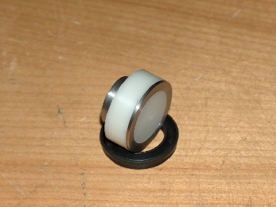

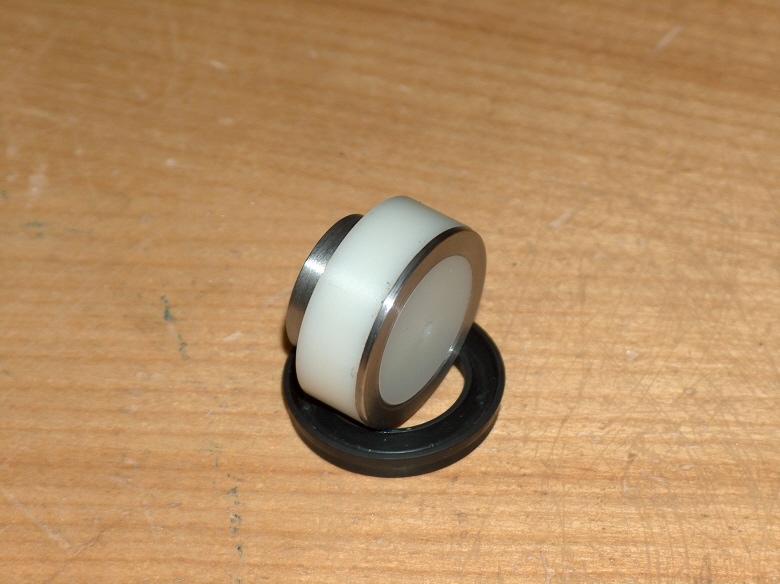

Aluminum for the piston will work, but sliding back and forth inside a steel housing will eat away at it...the debris won't be kind to your piston either. (look up galling)
Would suggest some form of wear sleeve. This is the piston from my co-ax, it has a nylon wear sleeve, and has been hollowed out and filled with a nylon plug.

I was thinking of the piston floating on shallow gland o-rings. Maybe about .020" of actual outside clearance. Some sort of bumper will also be a big concern. What did you use for a pilot? I was thinking of some sort of electric solenoid valve, but the pressure ratings on those are pretty low.
