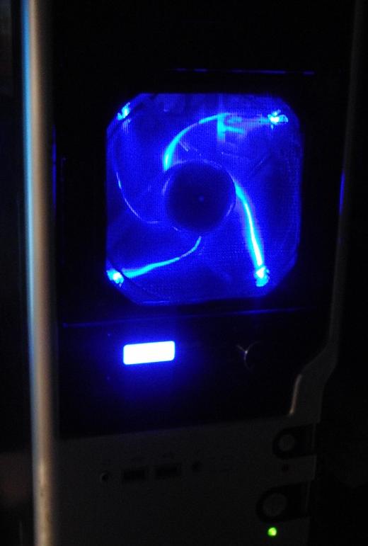

I had an Asus window that monitored temperatures and warned me if they got too high, plus I had this beast on the CPU so I don't think overheating was the issue.
Now I understand your cooling system.
The down side is that it is sucking in air and dust from every other nook and cranny in the PC case besides the PSU intake holes.
The filter will help on the PSU intake though and isolating the PC to another room or the other side of wall will help immensely.
