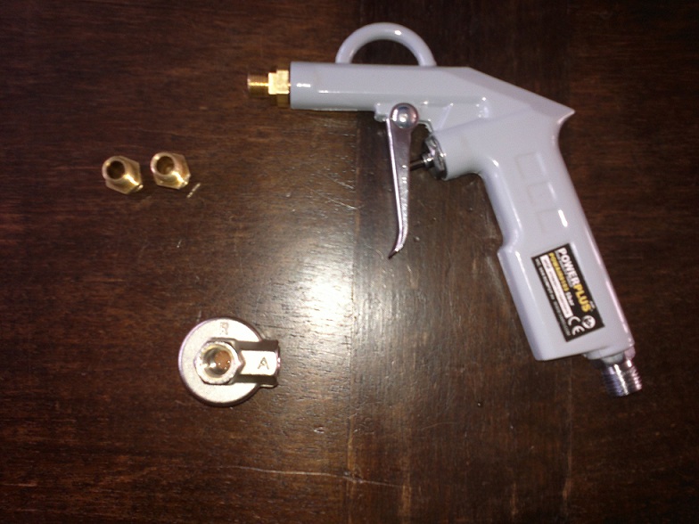

Here is a picture of my QEV,
could please somebody help me? :)
Thanks already!
Lucas
Here you can see my QEV (A and R are marked) and my blowgun
The exhaust port would go to the barrel of paintballs in the mine.
The cylinder port would go to your local air chamber.
The other port is used for both filling the air chamber by adding air, then firing it by releasing air back out.
I hope this makes sense. Instead of operating an air cylinder, we are simply storing air pressure instead. Instead of venting the cylinder out the exhaust port just to let air out of a cylinder, we connect our projectile chamber there. The last port is used to charge the system and then pilot the shot.
You will want 2 valves to this setup. One to add air, and another one to let air back out as a trigger device.

Ok,
thank you!
So if I got it right:
I can use my blowgun (connected to "P") for filling my chamber (connected to "A"). When filled, i can use my blowgun as a trigger, the air of my chamber will go through the claymore (connected to "R"); Right?
I guess I can start building! I will show the result!

Lucas, if it helps I always think of the ports as P=pilot A=air chamber R=release (of air) I don't know if this is what they really are but it helps me :)

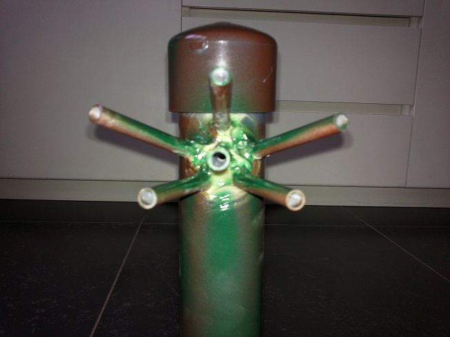

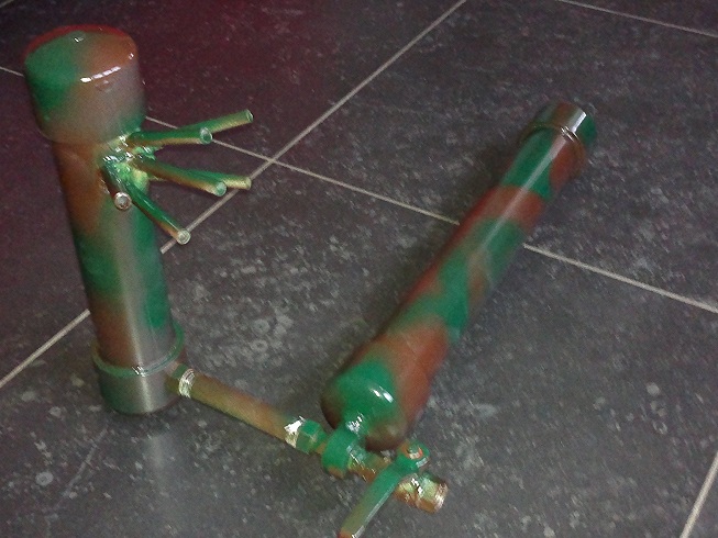

Here are some pictures, I will soon test it at 8bar.
