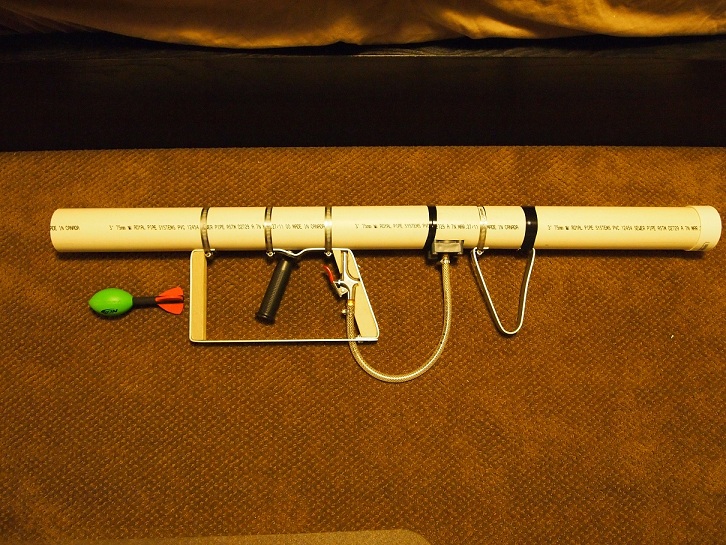

It's been a while since I've been been on here and even longer since I've posted. But here is my latest project (still a work in progress), a pneumatic Panzerschreck 54 (i know its about a foot to short). Please ignore the tape above the valve (a seam in the 3" sleeve) and on the shoulder rest as i ran out of 3" hose clamps and the exposed blowgun in the handle. Also a detachable shield and a coat of paint are in the works.
Barrel: 2"x30" Sch 40
Chamber: 2"x15" Sch 40
Valve: modded sprinkler valve (Hunter SRV)
structure: 1" flatstock Al
I realize there are a lot of little things you guys will nit pick about but it's a panzeschreck and the best one I've seen.

What size valve did you use and do you have a link??

CooperJS, I forgot to put the valve size in my original post :shock: anyways it a 1" modded sprinkler. and a link to where or what? (its been a while since i've been on here)
