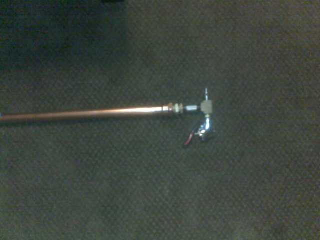

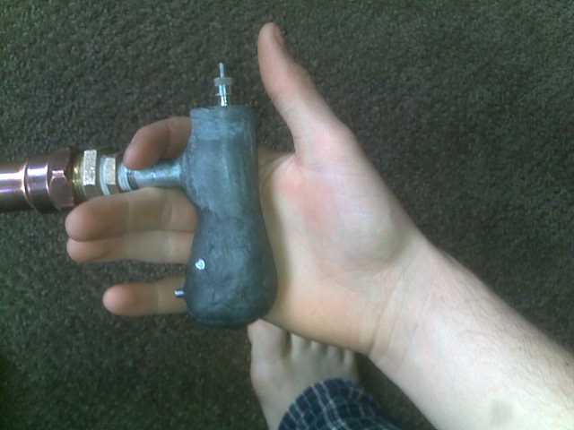

So this is my first copper gun and first serviceable piston (my unserviceable piston destroyed itself on the 2nd shot :cry: ) I havent done much testing because of leaks and ghetto pistons (I have a non ghetto piston that i will share when I open it up again). Overall this is a gun of many firsts for me; moving to copper, playing with epoxy and creating a workable piston and I am quite proud of the leaps I have made. Anyways here's some specs;
valve: high ratio barrel sealing piston ported with a blow (sawed off)
piston: 3/4'' brass pex end cap (its hallow :) ) with an o-ring and
sealing face: 3mm of rubber gasket
pilot volume: about 2inch^3
Barrel: 29'' of 1/2'' copper (I think its type L)
Chamber: 26" or 3/4'' copper (type L?)
Handle: Epoxy :D (first time molding epoxy)
Joints: silver brazed :) in an extremely well ventilated area.......
max pressure: I dont really want to take it past 300psi for safety sake and im to lazy to take my shock pump that high or higher
ammo: whatever fits but preferably sabot-ed 10mm lead shot
Unfortunately I can't take all the credit as I was inspired by jeepkahn's cane gun and fueled by my frustration in him for not being able to show us the finished product.
This cane gun still needs a schrader cover and a cover for the fittings (stitched leather?) so I would appreciate any input)
I would like to apologize for the poor quality cell phone photos, if there an issue il take some more and hopefully get one of the piston while im at it.
Thanks.

Thanks, I like the look of the copper... I could roll a thin sheet of copper (Im in a welding shop 5 days a week so I get free stuff all the time) between the joints to give it a cleaner look and finish the schrader cover, Also I considered porting the barrel on 2 sides to give the appearance of an adjustable cane thus justifying its construction materials.
