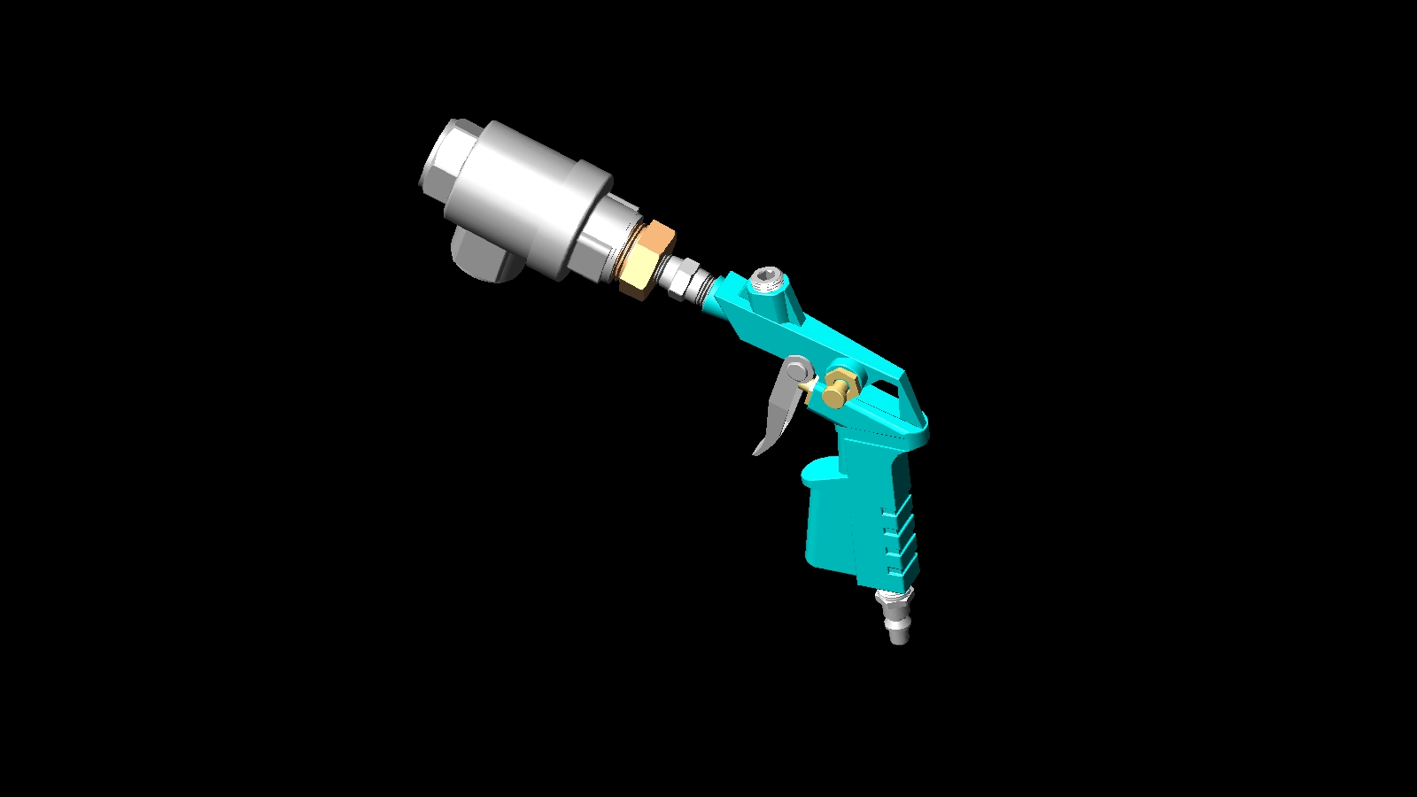

Here is what I call a Fill-N-Fire piloting system.
It makes use of a tire inflator from Harbor Freight.
The trigger is used to fill with air and the button on the side is used to fire.
This is simple enough for you Jesse since you thought my other version was complicated.

Look at others cannons and get ideas. But dont copy mine!!
