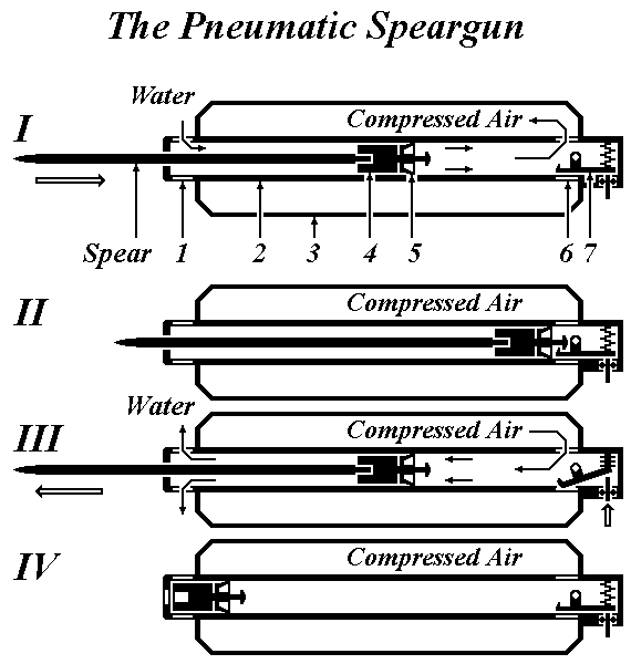

pneumatic spearguns...
... are actually valveless single stroke captive piston pneumatics!
This was news to me.
No need for an external air supply, push in the spear compressing the air until the trigger sear locks et voila.

Interesting, I once considered building valve based on this.
Essentially similar tothis concept, except it doesn't rely on external air and uses a piston pusher that doesn't actually leave the barrel.

I think this design could be improved with a balanced piston. There is too much stress on the trigger mechanism in my opinion.

What does the water go in for anyway?

Actually this would make an epic handheld air cann - er... not air cannon but uh... weapon thingy. Wait, these are already mass produced aren't they.
MRR wrote:I think this design could be improved with a balanced piston. There is too much stress on the trigger mechanism in my opinion.
Could be done, but how much pressure can you really generate with a single stroke, it's not *that* stressed.
... because you're underwater?
You can't leave that part full of air, because it will resist the motion of the piston. Of course water does this too but it is incompressible so it is simply being forced out.
Found the diagram on a website suggesting a "dry" barrel, where the space in front of the piston is evacuated:
If they really wanted to increase power significantly though, it's easier to just stick on a schrader valve and pump a few extra psi.
*gasp* have I just suggested MOAR POWER! over better efficiency?!

Oh, I didn't think about that part.
