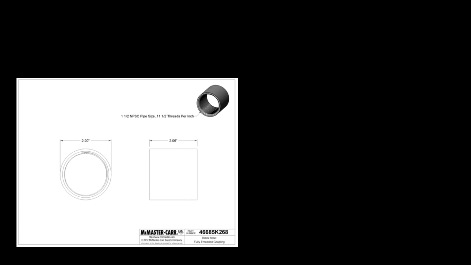

8tonsemi wrote:I know one guy who welds i'll see if he will do it. Also is black iron safe for spud guns using 200 psi or more.
Use one of these, they are steel not black iron.

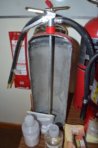

Here is a cross sectional view of a typical dry powder type extinquisher.

Cool picture :lol:
