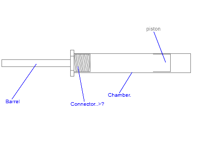

So need help with this design, which uses a blow forward piston like nailguns. i need info on the valve and how to make the best possible piston.. :help: help help help
so here are some gun part descriptions: the piston is hollow but sealed of course from the another end, and it doesnt yet have the ramming rod (the long thingy in middle of piston)
So the piston will have a rod physically pushing the projectile?
The first question is, what are you hoping to achieve that you couldn't with a conventional setup?

hey and the valve will be at the back of the gun, it offers optimal flow and easiest to build there. maybe a poppet valve, piston valve :idea:

yes it has a rod in the piston to push the ammo. well achieving maybe better power and no worry of airtight ammo.
iloveairguns wrote:well achieving maybe better power and no worry of airtight ammo.
Some things to consider:
- the piston has a bigger surface area, so that does provide you with more potential power, but you're also having to push the weight of a relatively heavy piston, so that advantage is lost
- you have to stop that piston, which puts a lot of stress on your system and also eats away at the performance.
It's a good idea if you want to launch a heavy projectile at relatively slow speeds, like for example a ballistic knife, but for a BB, not a terribly good idea.

Technician1002 wrote:this thread shows the advantage of a large diameter barrel and sabot on small diameter projectiles.
This applies to the "typical" sabot round setup, involving a small dense projectile in a large lightweight sabot.
This gives a large area and low density in the barrel, giving good acceleration, then once the sub projectile is separated from the sabot it has a small area and high density, meaning it will retain its velocity for longer.
In the "nailgun style" setup however, the piston/sabot would tend to be heavier because it needs to survive the impact and be arrested, therefore negating the advantages to a large extent.

well i would prolly put rubber in front of the piston to dampen the impact
Note how nailguns also feature an air bumper:
