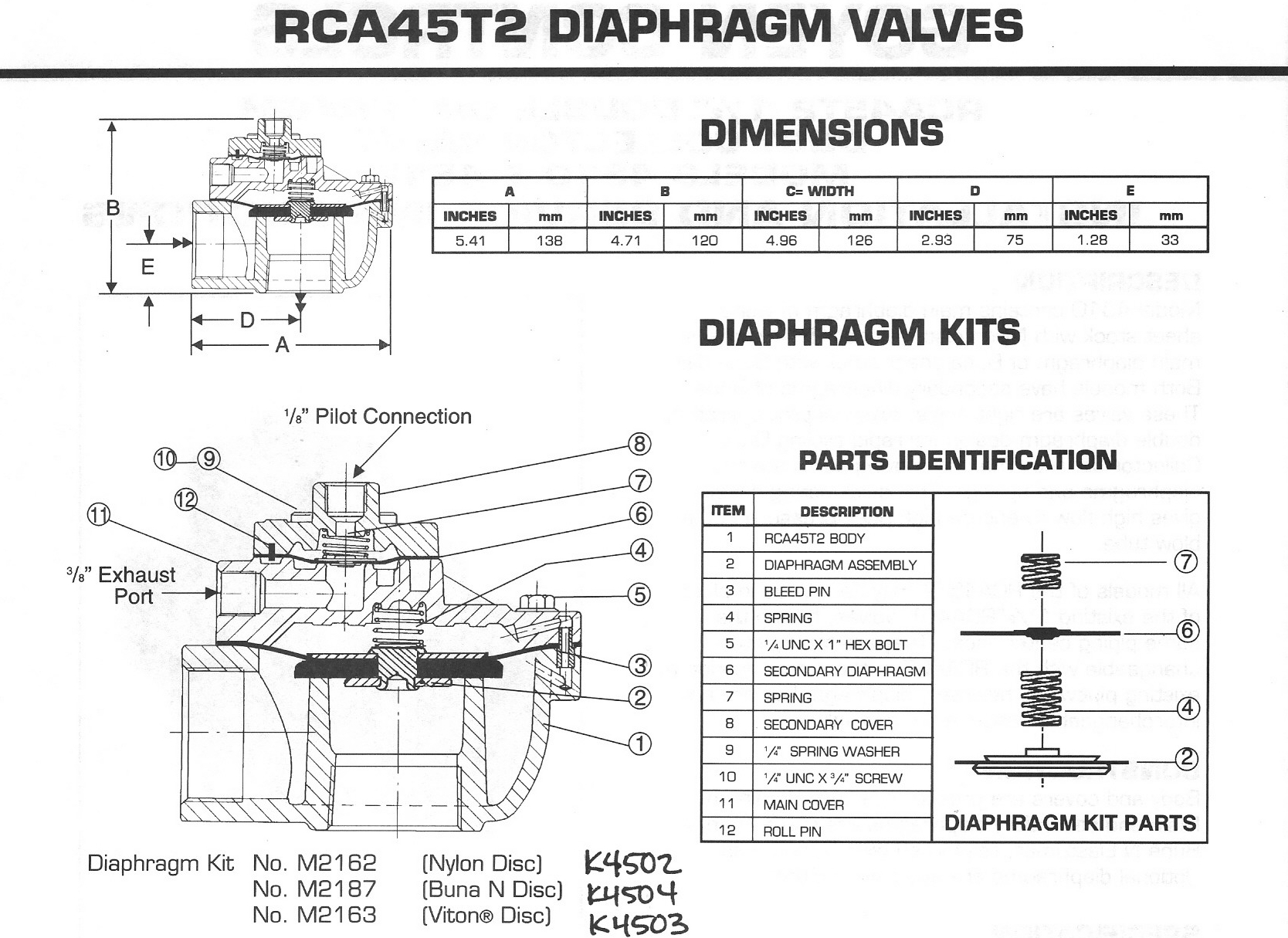

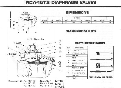

this is matties, but i have the same valve
mattyzip77 wrote:pic added hope its "suitable" and appropriate............... :thumbright: :thumbright: :thumbright:
look at the middle one, , that little plastic piece my valve didnt come with it,, im trying to figure out something very strong to seat correctly and seal

this is matties post, but i stole it since i dont have a camera right now
http://www.spudfiles.com/forums/1-1-2-i ... 24807.html
look at his pics i have the same valve, where the rubber seats its only about 1/4 of an inch.
just as i went to pressure it up, it popped, so i need to figure out what to do next,,, someway make the rubber stronger, so it doesnt pop at 100 psi

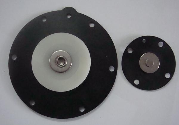

You could epoxy multiple layers together. It really depends where it needs strengthening. Your dad's suggestion isn't a bad one, I've seen many valve diaphragms that are supported by an aluminium (or other metal) gasket in the centre where it seals against the seat.
The rubber needs to be flexible in certain areas I would think, so that pretty much means the centre area that flexes down and seals the valve needs to be able to do this with ease. If you double the rubber over the entire diaphragm, this may cause problems if the centre can't flex enough. However, if you only double the rubber thickness in the centre part that flexes, or reinforce it with a washer, it might solve your problems.

Ok I don't know what you mean by it popping instead of leaking. Did you copy the design of the original diaphragm and check for equalisation holes?

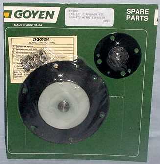

jsefcik wrote: look at the middle one, , that little plastic piece my valve didnt come with it,, im trying to figure out something very strong to seat correctly and seal
The diaphragm is Buna Nitrile/Nylon PA6. Kit number K4502.
Here is another variation:
http://www.ebay.com/itm/3916-Goyen-Hytr ... 2934955%26
