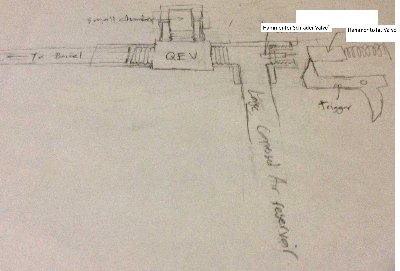

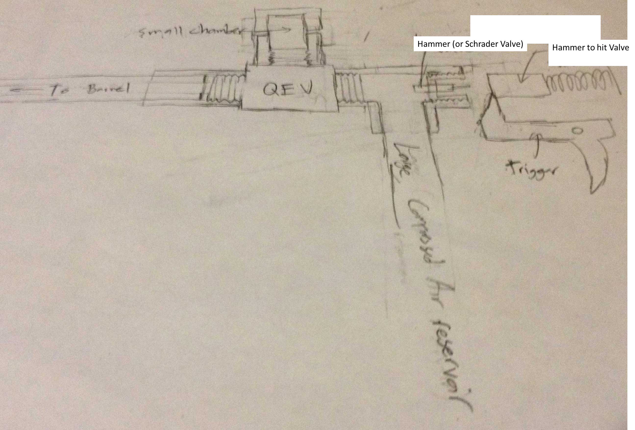

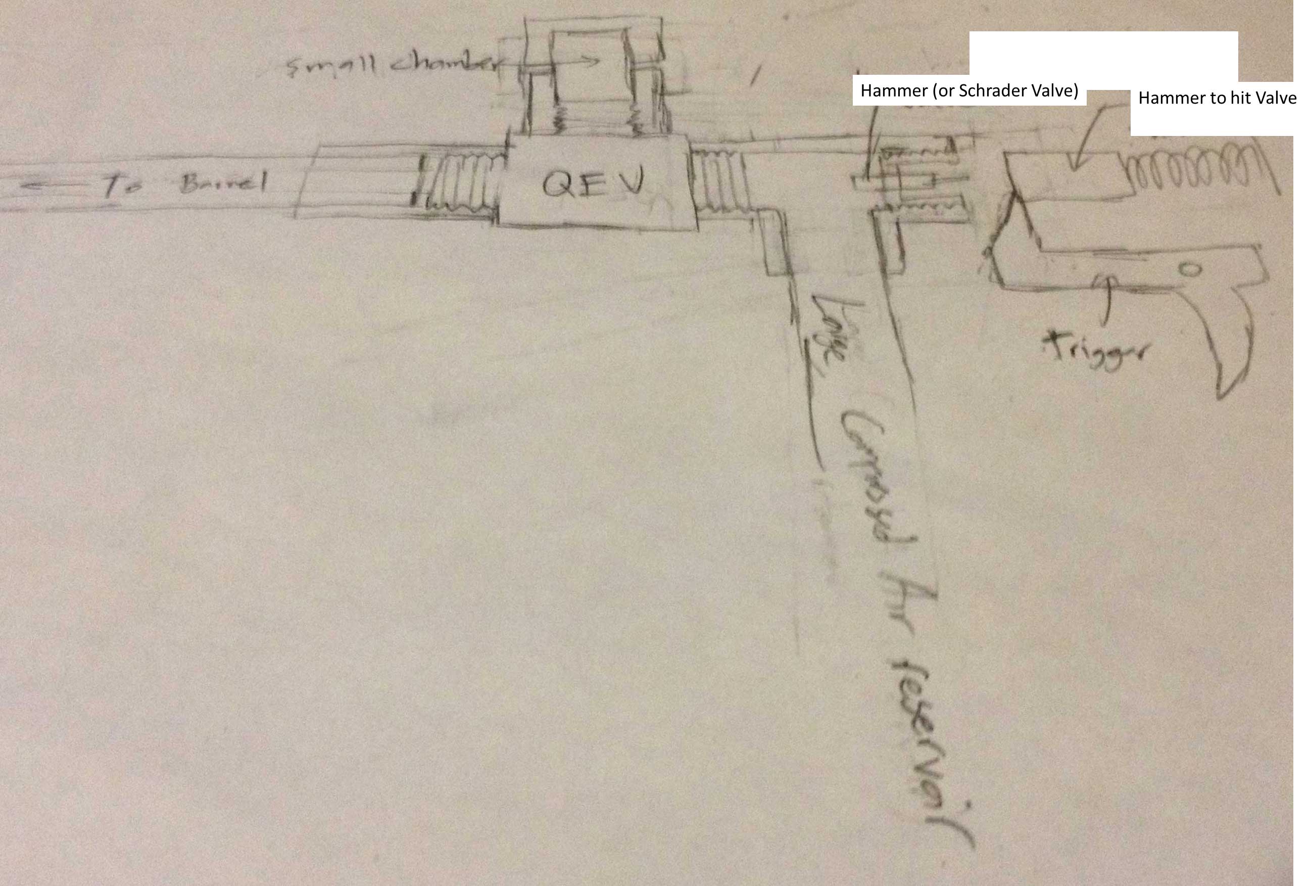

I'm sure this configuration has been discussed and attempted before.
Did I get this right?
I have the pressurized air reservoir and shrader valve on the "In" port of the QEV, a relatively small chamber attached to the "Out" port, and the barrel attached to the "Exhaust" port.
I have not drawn a loading mechanism, but it is not semi-automatic. I would likely try for bolt action, break-barrel, or even a Martini-Henry style configuration (even though it will be kind of difficult).
I plan on having the QEV stay "stock"--that is unmodded.
Will this design work?
Portable Multi-Shot using a QEV and Schrader Valve Concept
Won't quite work as drawn. You have such a large air supply that the small amount of air lost to the schrader hammer setup will not be enough to fire the thing.
Have a look at this: http://www.spudfiles.com/forums/b2tb-sa ... 14817.html
You're better off modding the QEV and filling from the chamer side if you're going to bother with a momentary pilot.
Or just use a three way valve as a pilot: http://www.spudfiles.com/forums/semi-au ... 23626.html

Thanks for the advice. How exactly do you mod the QEV?

I believe that if you make a SMALL (like 1mm) hole to the piston it should work, maybe a little spring behind it to help

Woah..
A small hole in the piston?
yes...but not in the center and not to close to the outer edge.
That could have gone really wrong..
If you puncture the part that seals the outport, the piston is ruined!
I'd advise to stay clear of the edge to prevent tearing.

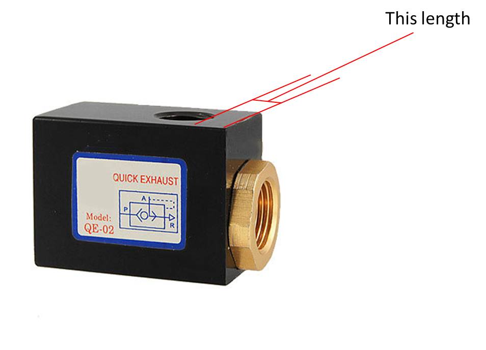

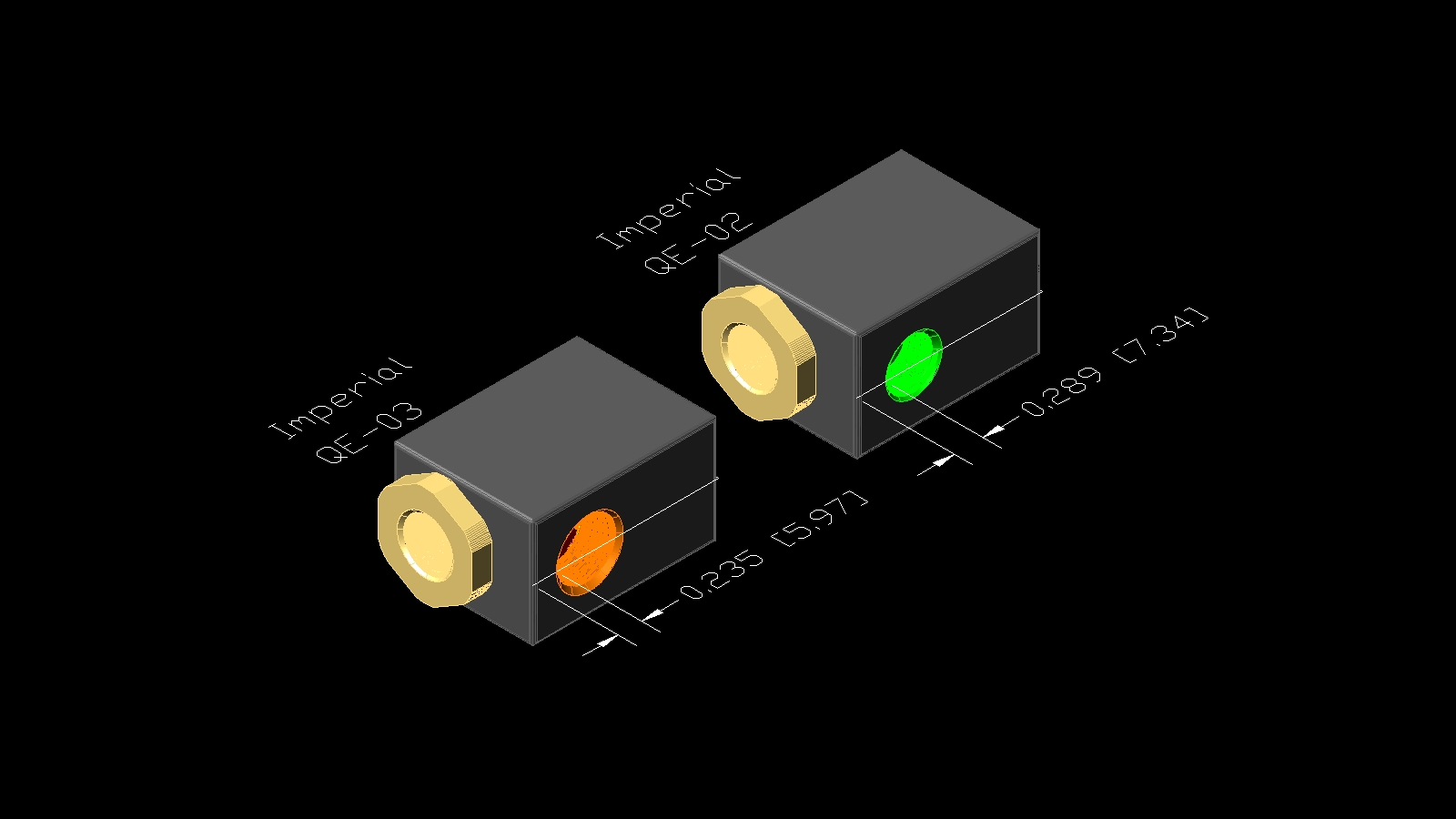

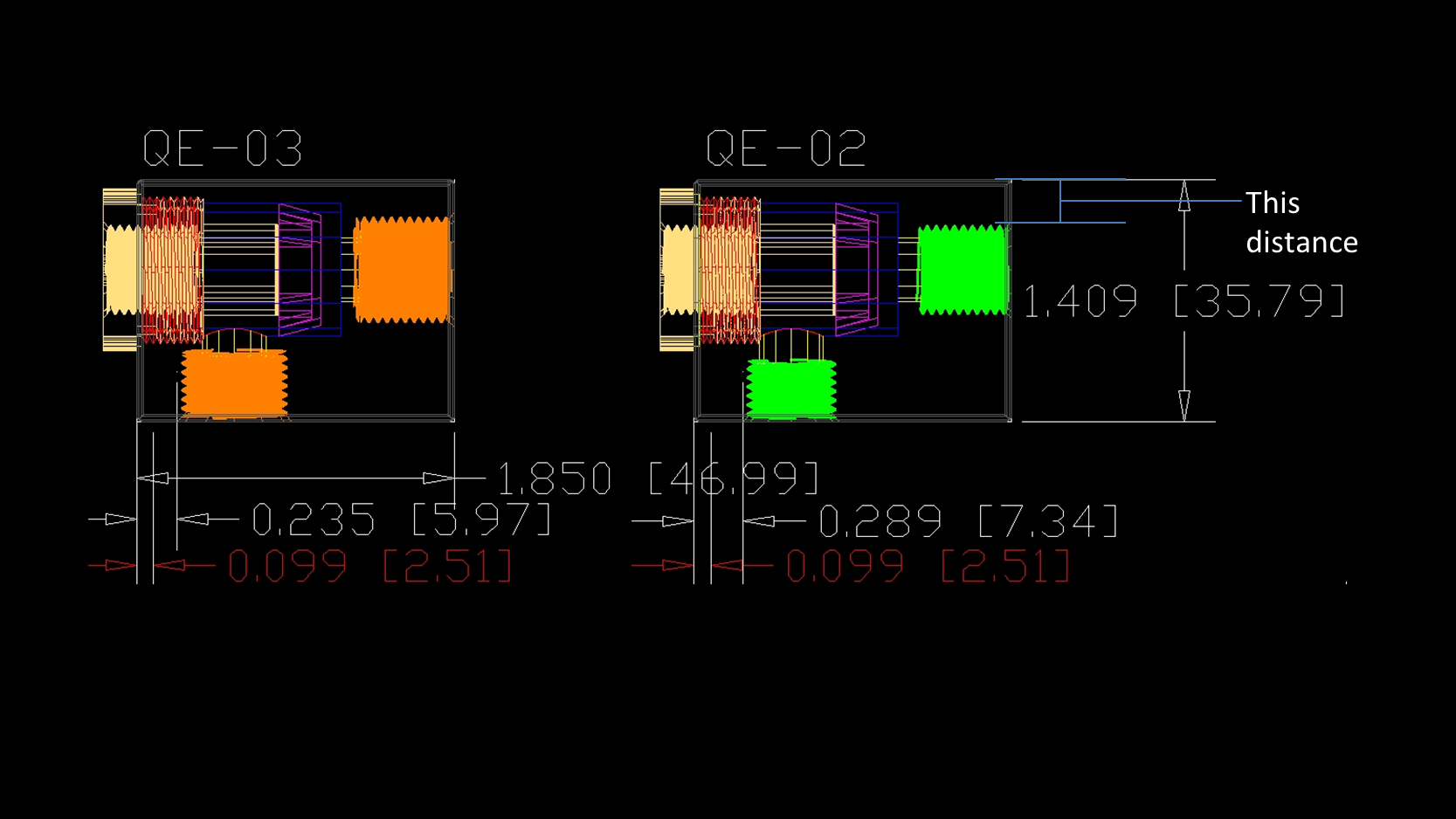

Thanks for the dimensions. dewey-1, can I please also get the distance indicated in the attached image?
- qe02topholedist.jpg (32.93 KiB) Viewed 6139 times
Hopefully this will suffice.
If someone can prove me wrong, let me know.
Is that from the inside of the port, or from the outside? I'll strip down my QEV gun tomorrow and check both.
Keep in mind that these QEVs have some terrible flow restrictions, which can be drilled ouy, but it's a PITA. Still quite reasonable power at 500 psi though, knocks 1/3oz sinkers through 1" of pine.
/sarcasm, /hyperbole

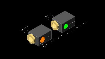

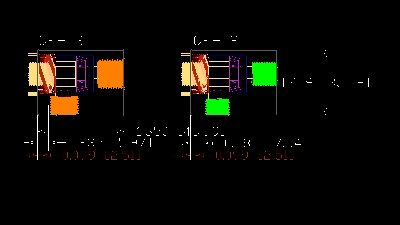

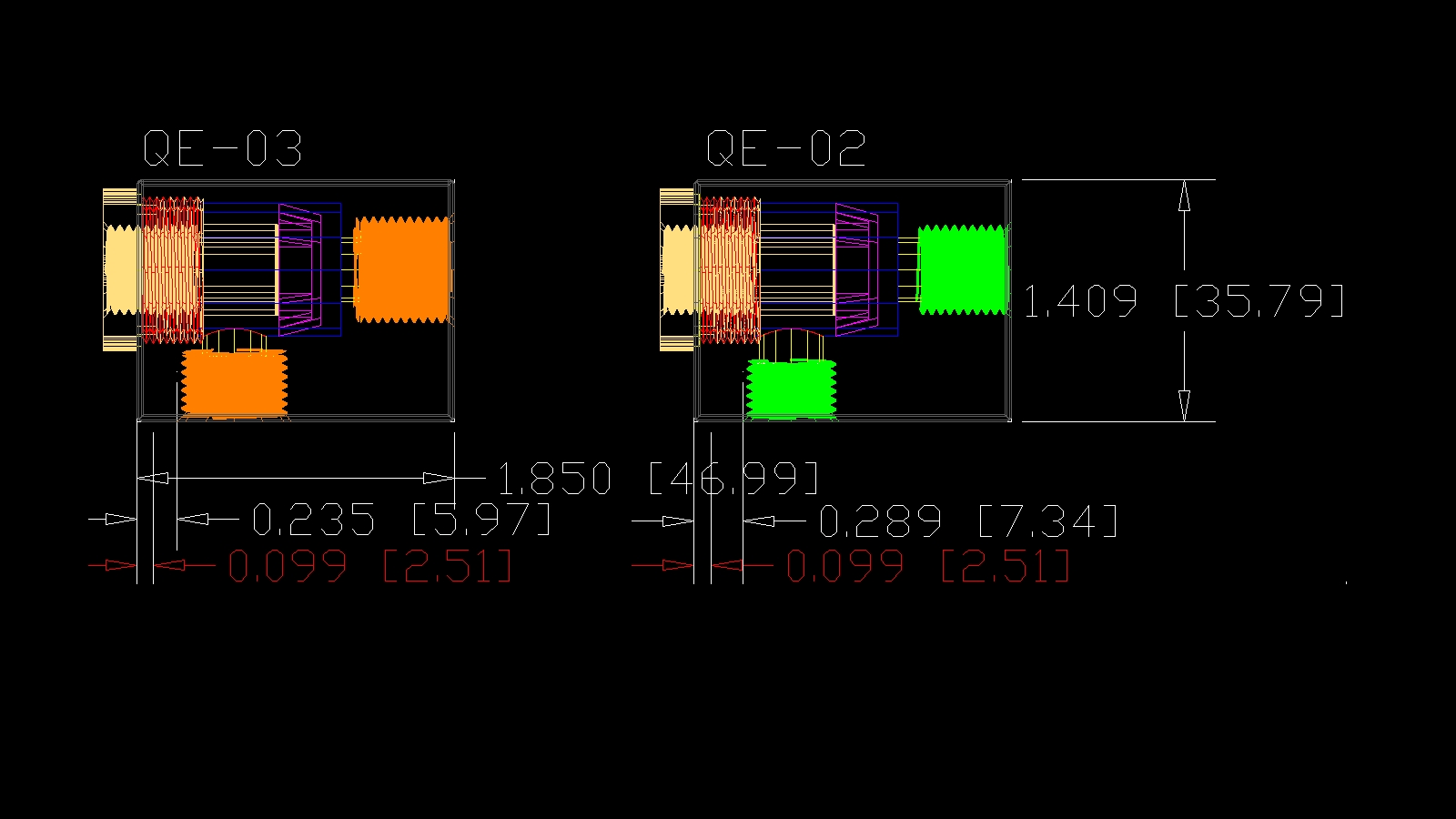

The dimension that is really needed, is the hole center to the front edge.
The only difference in the valves is the port sizes as near as I can tell.
This side view shows why I disagree with 2.5mm.
