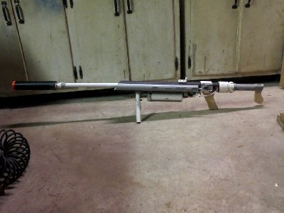

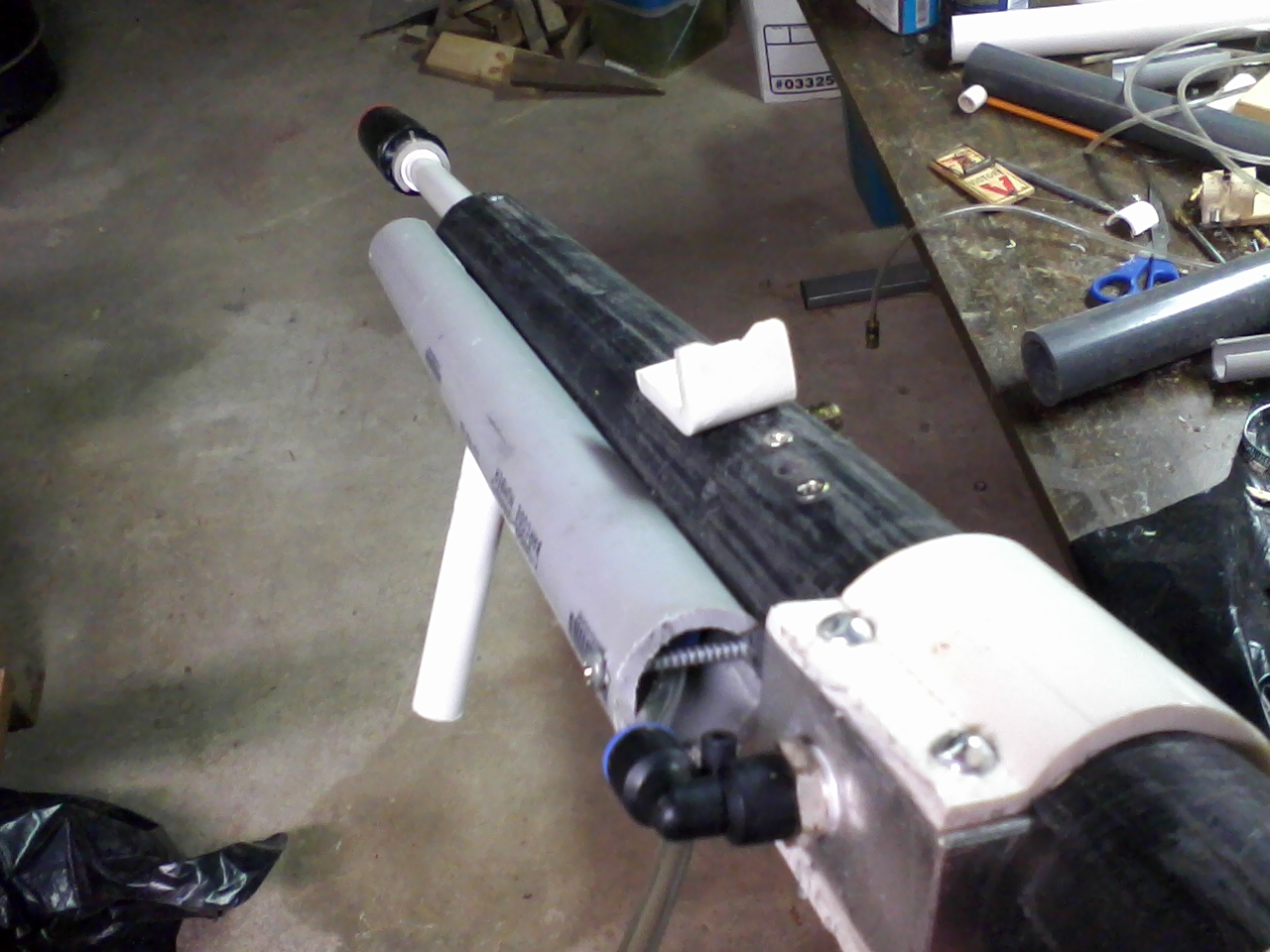

Here is what I have made as my latest.

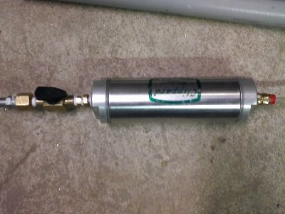

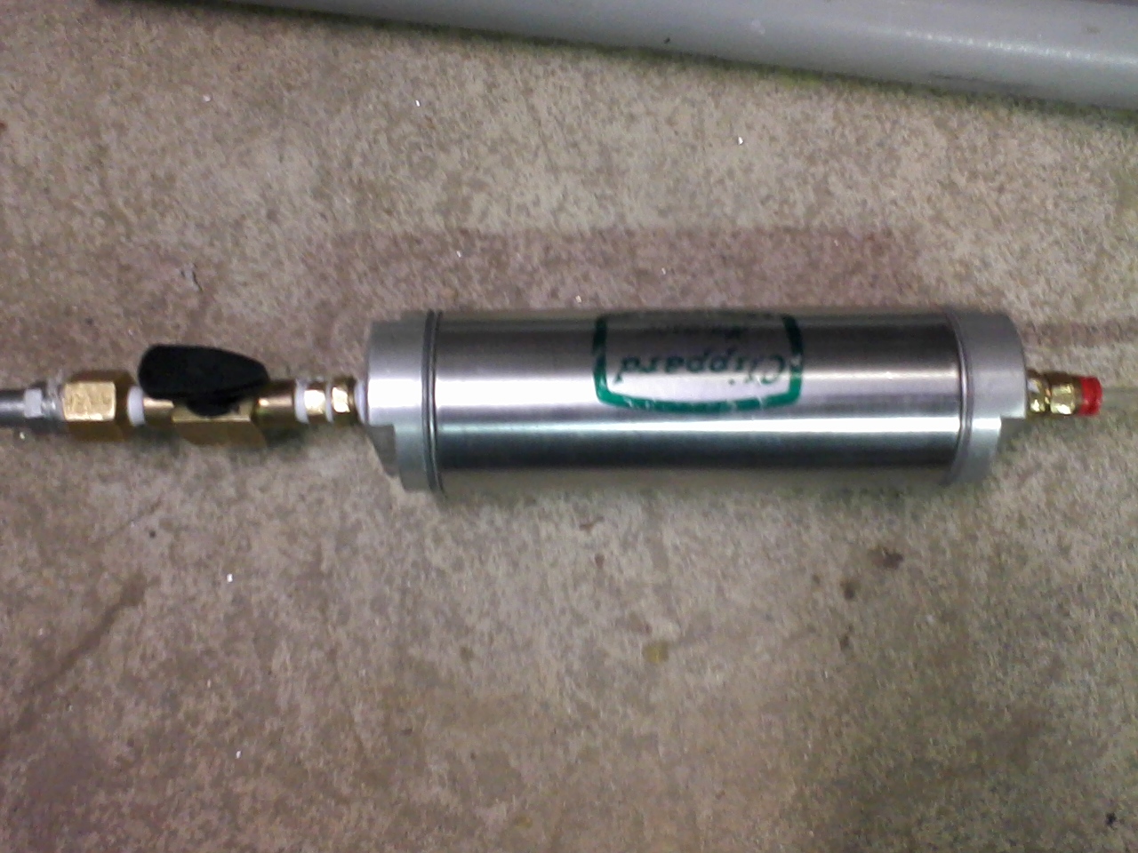

A bolt action gun, fully portable, operating at 120psi. My clippard tank is the biggest limitation, rated for 250psi, so I do not see a need to go too much higher. I have a DCV and QEV operating the pneumatic system. I am estimating 300fps.

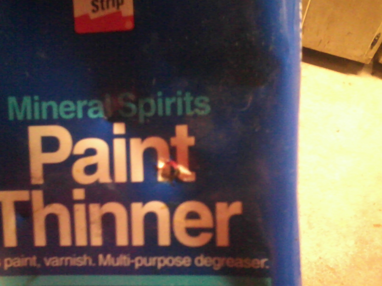

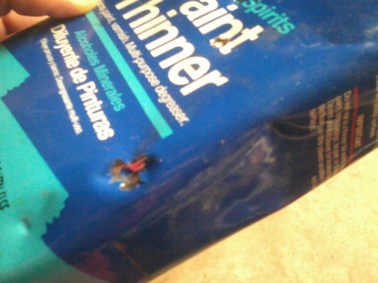

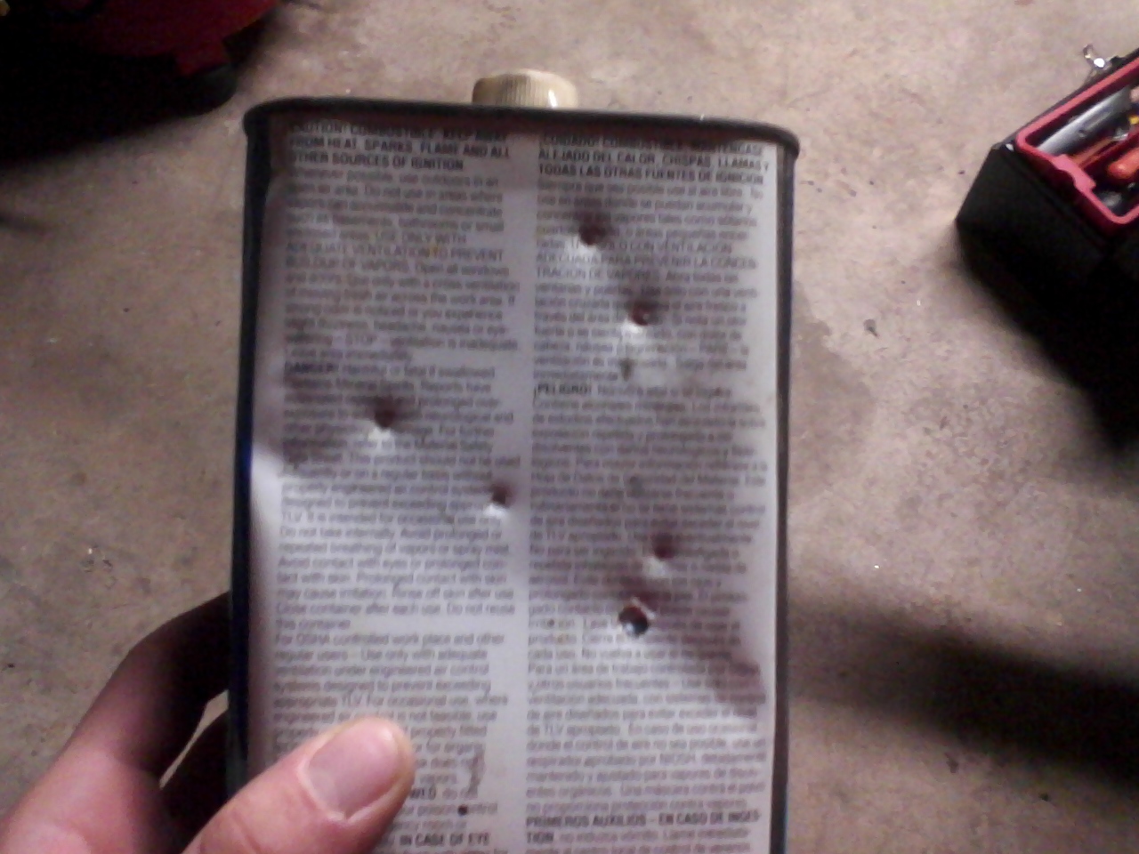

After some test shots at 20ft at an empty paint thinner can i caught ricochet and got a nasty welt, so this thing has some power. I attempted at sights and bi-pod for the first time and both are working somewhat.
What do you guys think, I have learned a lot form this project and I hope to learn more from the comments, so have at it :lol:

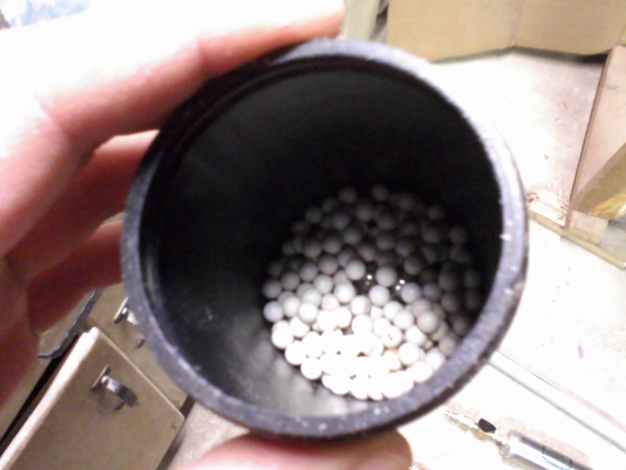

Damage pics on a paint thinner can, ranging from 130psi to 120psi with 6mm air-soft pellets

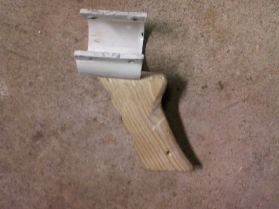

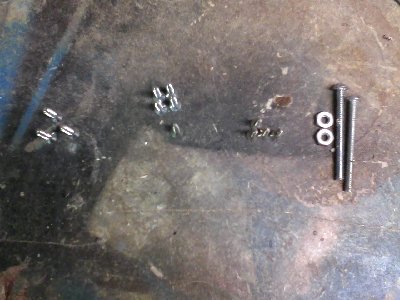

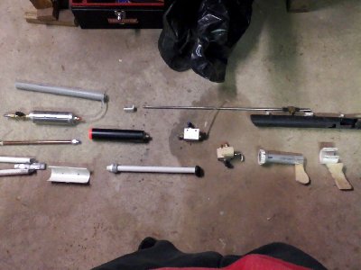

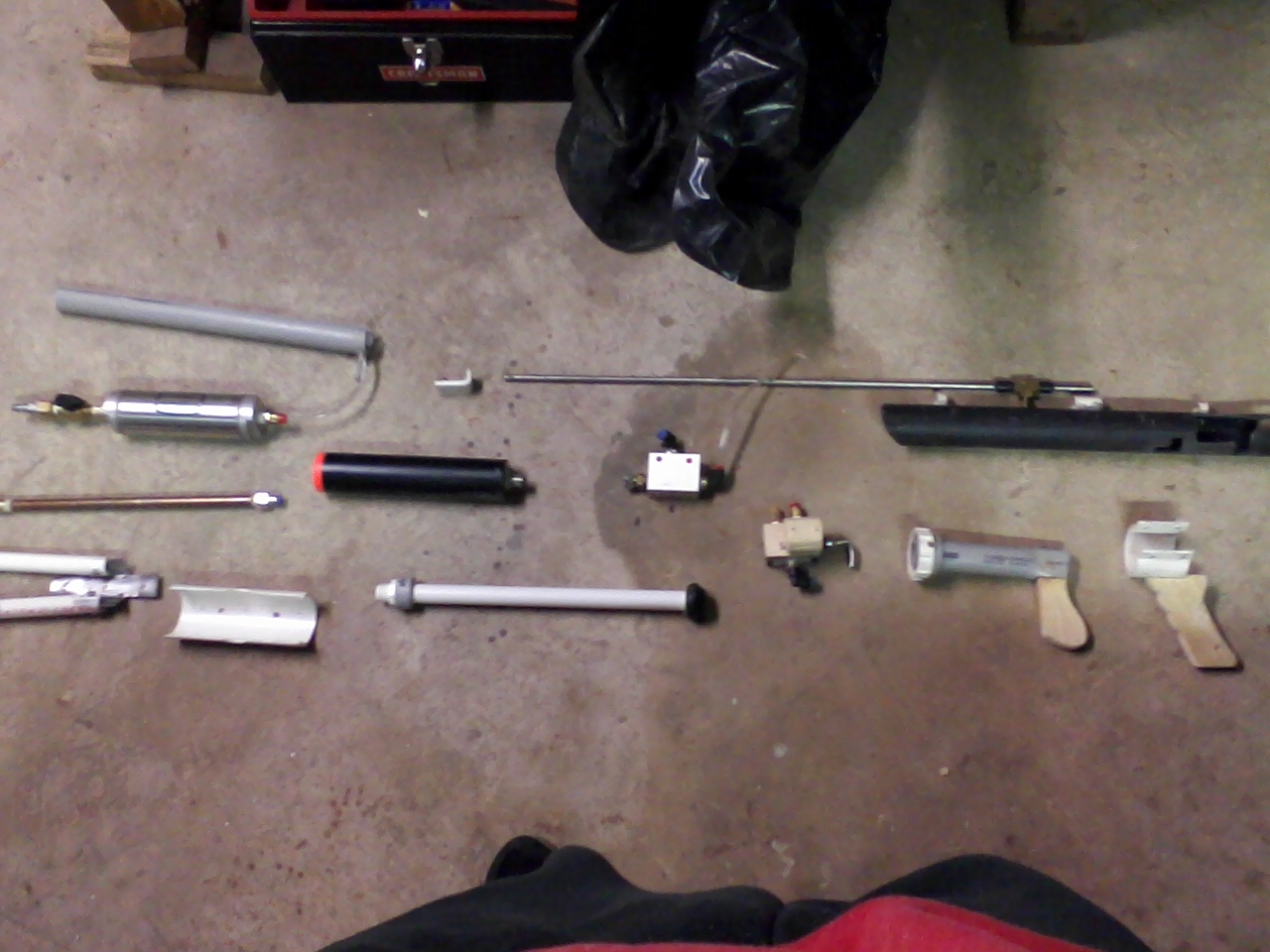

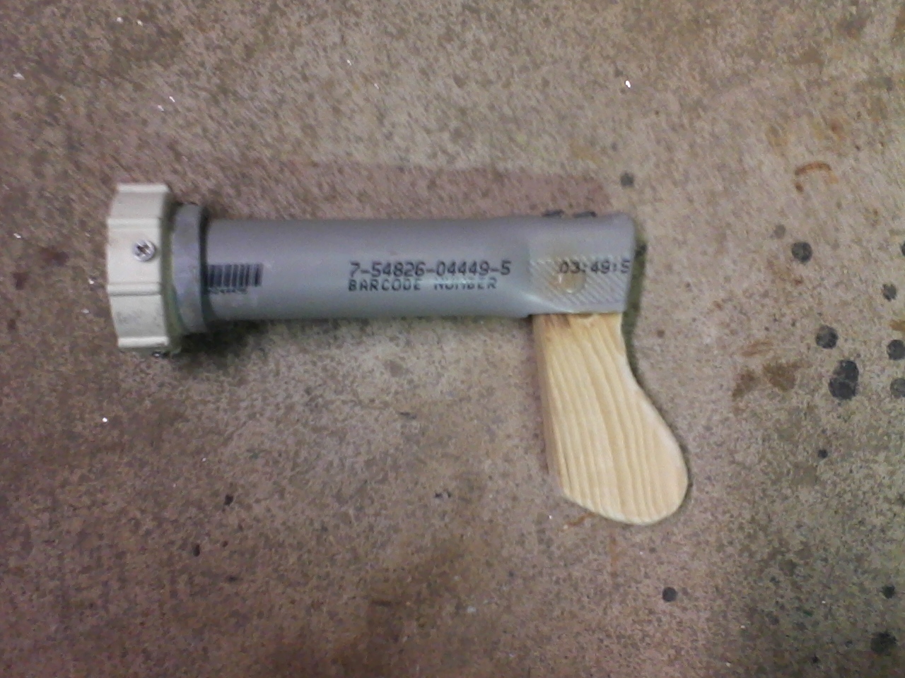

All the parts
All the parts

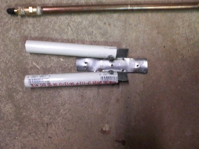

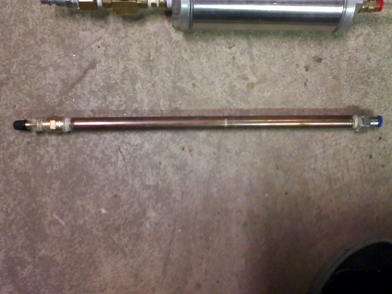

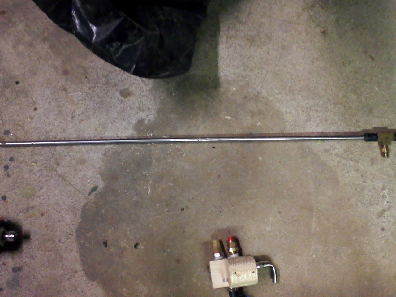

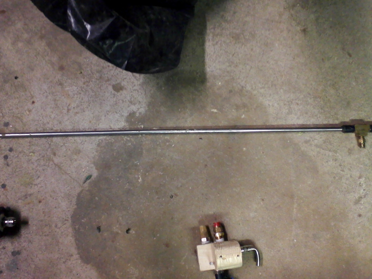

3ft, 6mm stainless steel tube used as barrel

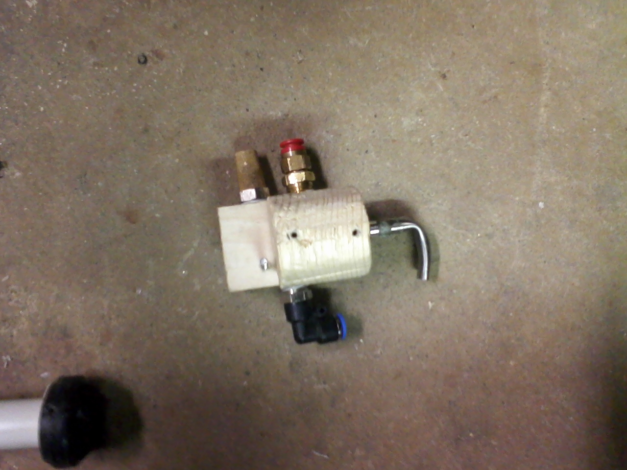

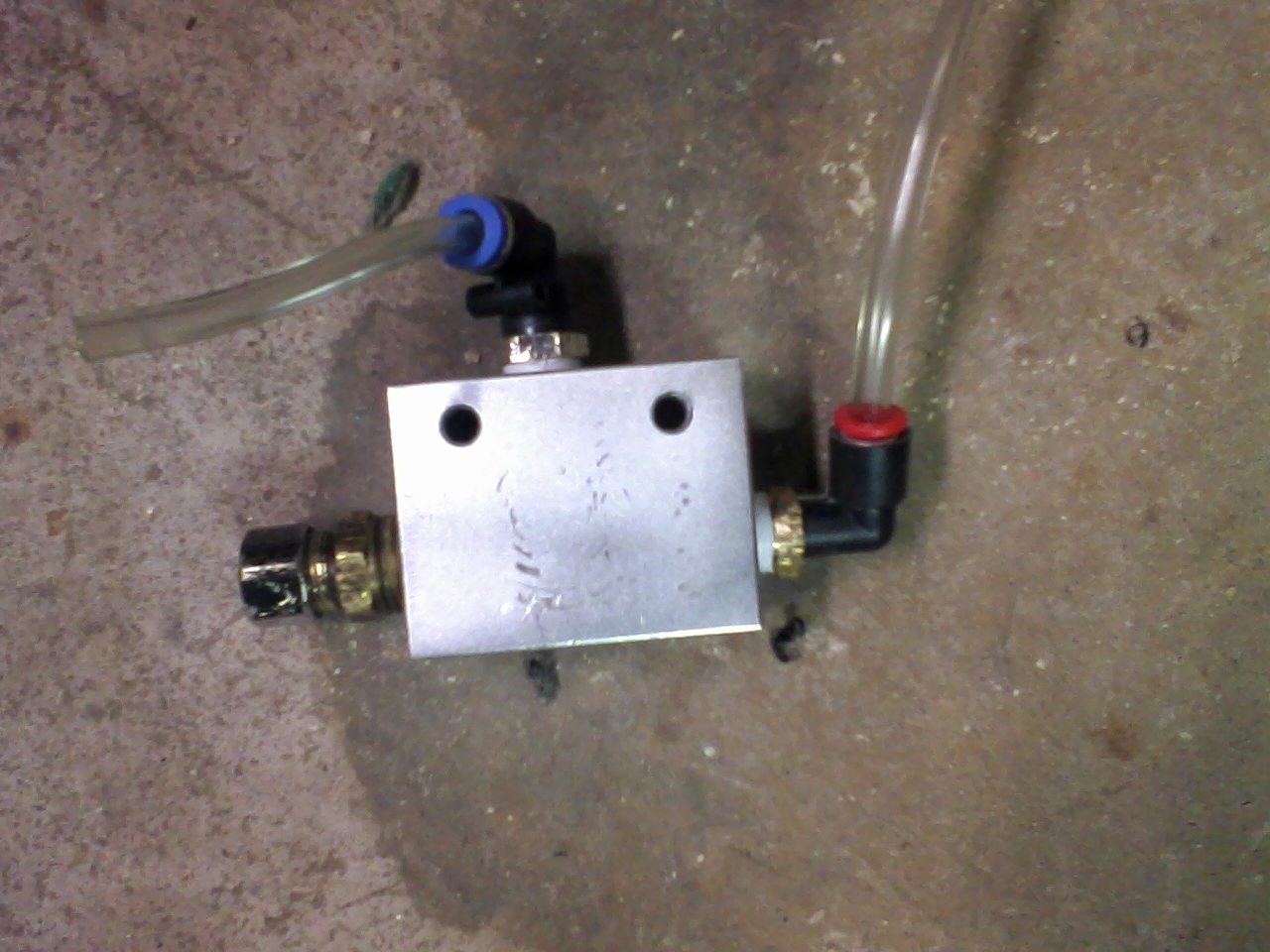

DCV, 3 way 2 position, pull

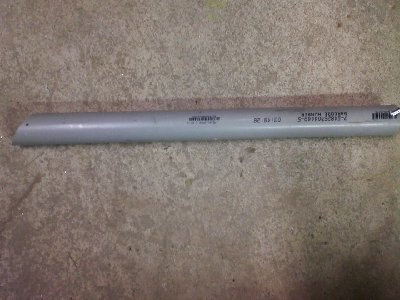

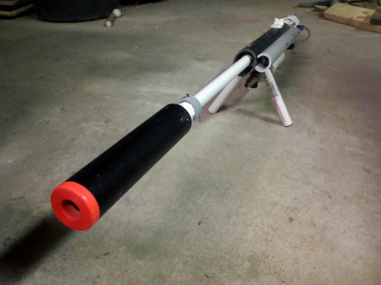

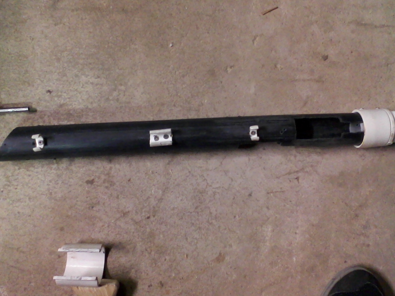

barrel shroud
barrel shroud
toy silencer, was originally meant for looks (doesn't improve sound, but actually improves range)

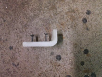

rear sight
rear sight

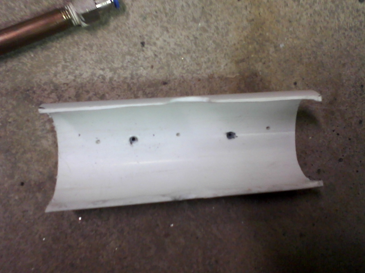

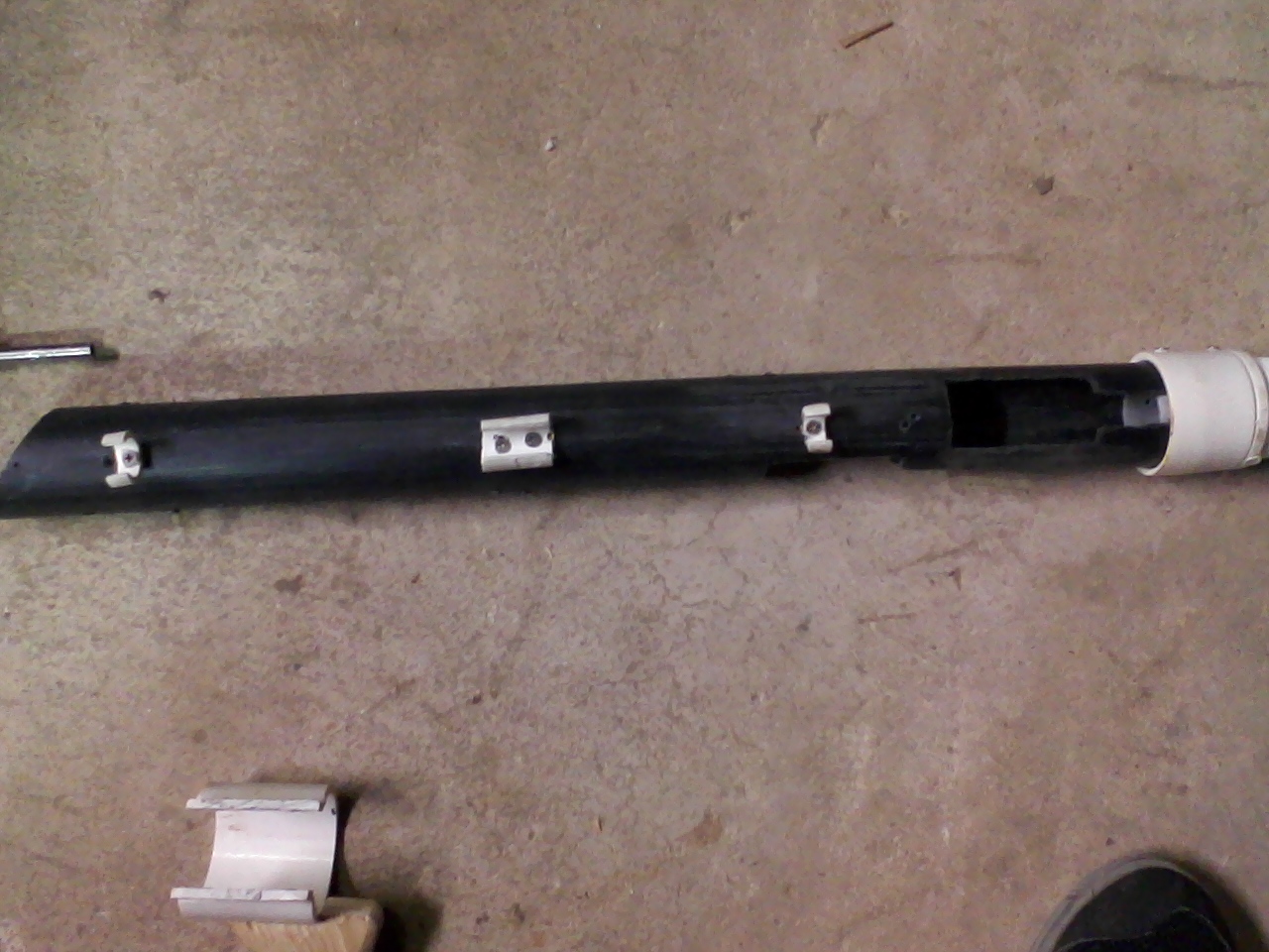

main tank mount
main tank mount
bipod
bipod

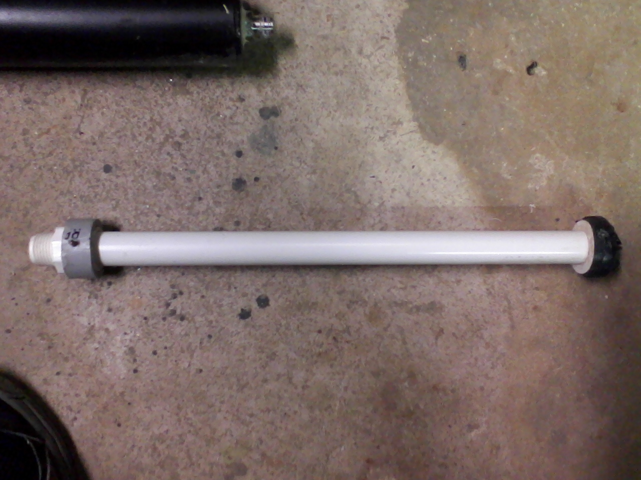

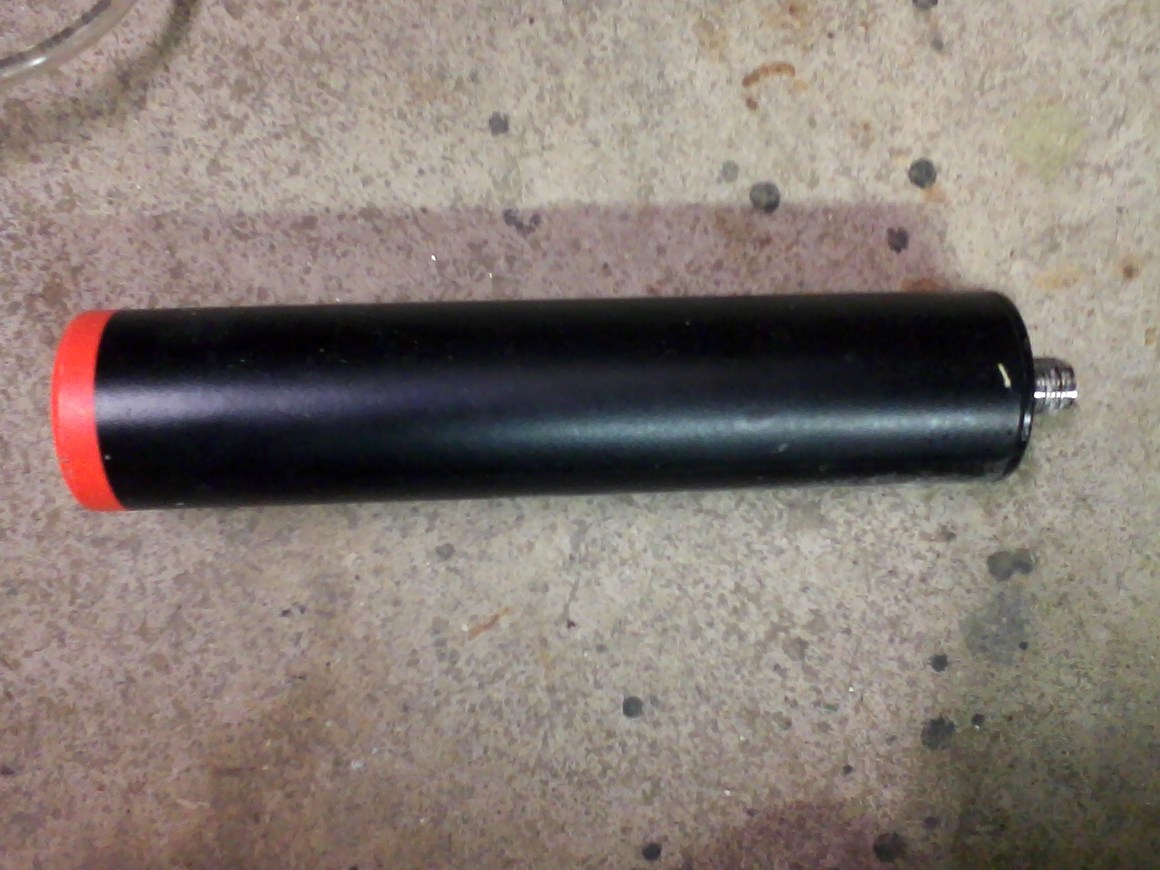

secondary tank
secondary tank
main tank
main tank
screw on stock
screw on stock
protective cover for the secondary tank, more for looks

that tank can probably take a little bit more but if it xplodes don't quote me :-D
not bad at all
ohh and.... >>>
Reason: Fixed video.
Veeeery nice effort, lick of paint and a proper scope wount would top it off nicely :) videos?

It looks very familiar to me :lol: damage are not bad for the pressure, I got the same result when using similar pressure. Nice main chamber, what is it?

If I understood how this thing operated Id make one,I havent made an airgun in years!,after my failed Semi Auto attempt I gave up but now concidering making another gun.
Ive never managed to get a Bolt Action airgun to seal correctly and not lose air through the bolt system upon firing?!.

wyz2285 I'm using a clippard accumulator. We used them on our robots back in high school, this one is rated for 250psi. Thanks for the inspiration
django, i haven't got the sealing down just yet, getting close though. Take a look at wyz2285 videos, they are pretty dang helpful. Have you seen Django the movie yet, look pretty sweet :)

Good stuff :D a simple magazine shouldn't be too hard to sort out, and a fridge compressor will turn those dents into holes ;)
