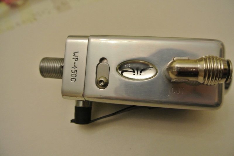

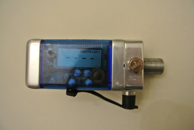

Well, I bought this, cost me 42 euros and something.

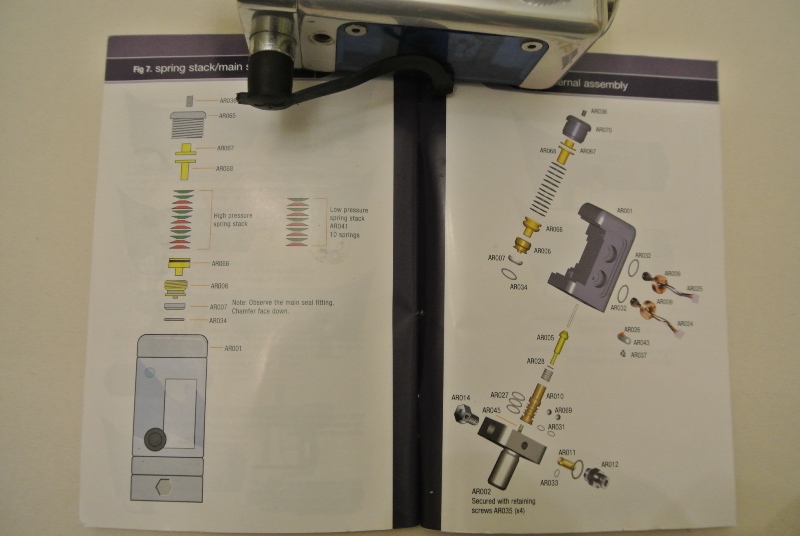

Totally worth it! Awsome regulator, the LCD shows both in-tank pressure and output pressure and using pressure drop per shot to calculate how many shots you have left. Besides, it allows external output pressure regulating and has two configurations (one allows adjustment between 100-500 psi, another for above 500 psi). It also comes with a very, very detailed manual, with all the information you need to operate/fix the regulator and a aluminium arm for mounting.
The only bad thing it´s it doesn´t have the pin valve that normal paintball regulator has so you can only fill the tank with the output of the regulator already attached to your gun´s valve.

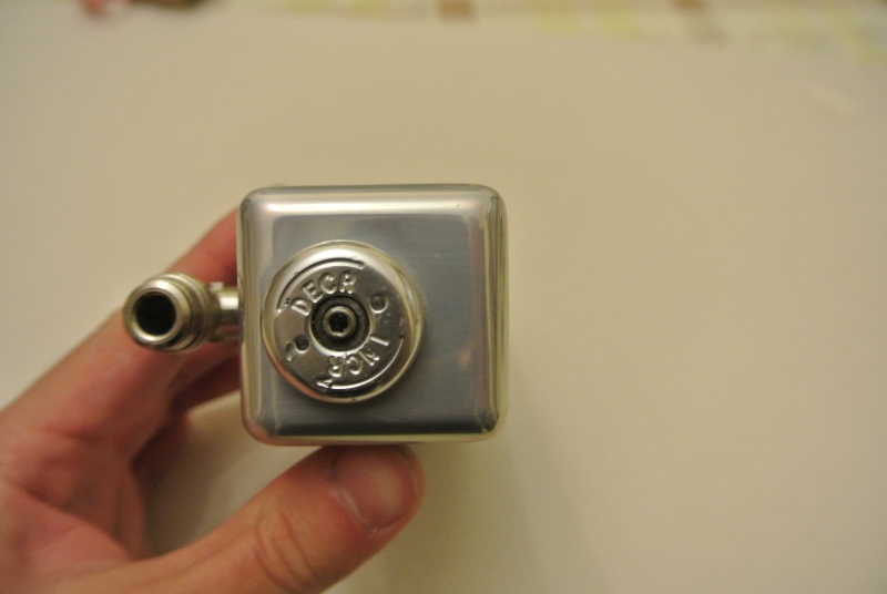

The brand, WDP A.I.R

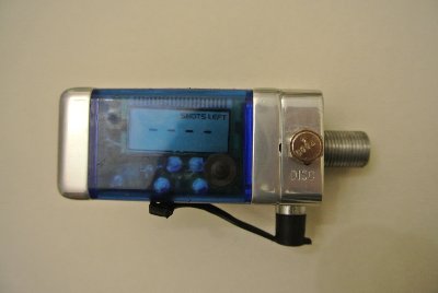

The LCD display, showing how many shots have left, nothing there because there is no air pressure to do the calculation

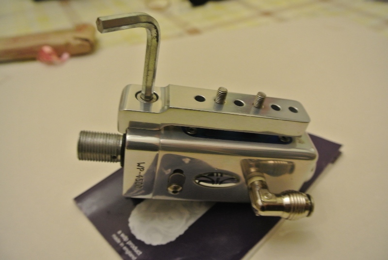

The screw to increase/decrease output pressure
The manual (a lot of pages and information)
The alumium arm for mounting

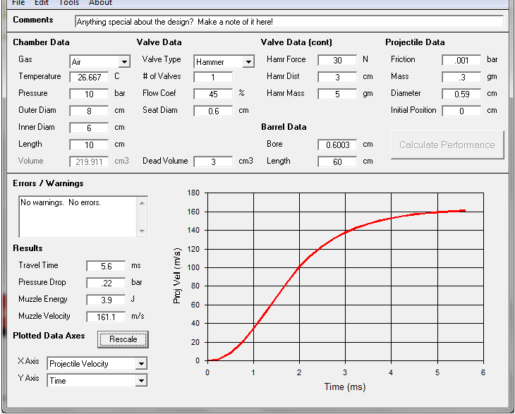

I assume you'll be using the regulator to have a "low" pressure firing chamber, this will remove the pressure curve. Ran some quick numbers into GGDT, with say a half inch ID firing chamber 2 inches long, and a 24 inch barrel, you could get a 0.25 gram BB to 500 fps with just 130 psi, a paintball tank will last forever!

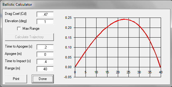

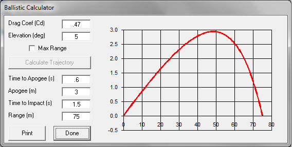

Found a suitable GGDT design, gonna follow it.
At 5 degree I got a nice range.
Sem Título1.png (23.65 KiB) Viewed 6190 times
range at 1 degree elevation
Sem Título.png (22.56 KiB) Viewed 6190 times
Sem Título3.png (37.5 KiB) Viewed 6190 times
